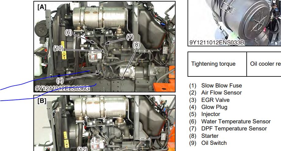

Something seems amiss - Per the service manual for that tractor,
coolant temp sensor is on side of block - OP should have gotten
high gauge / alarms

Sorry, that is not always true.
Once the coolant level in the block/head begins to drop the sender is just exposed to air or vacuum and since air does not transfer heat near as well/fast as a liquid does it is very possible for a gauge to stay in the cold or normal range even though the engine is overheating.
In addition This has caused a few engines (not pointing at Kubota here) to overheat the head in the area of the exhaust valve seat allowing it ( pressed in seat ) to drop and result in destruction of the engine.

A coolant temp sensor will not read air, it must be in contact with liquid for an adequate reading. Just about every water cooled engine uses this system, including cars, tractors, heavy equipment etc.
I would have to side with the manufacturer, its unfortunate this happened to you but it sounds like the system was functional and you missed the leak.
If it was a large leak I would imagine you have seen/smelled it, if it was a small leak it should have given you enough time to catch the low level.
Ultimately its the operators responsibility to do regular maintenance checks including fluid levels and leaks.
It is a pretty rough situation to have happen but it doesn't sound like it was caused by something Kubota did.
