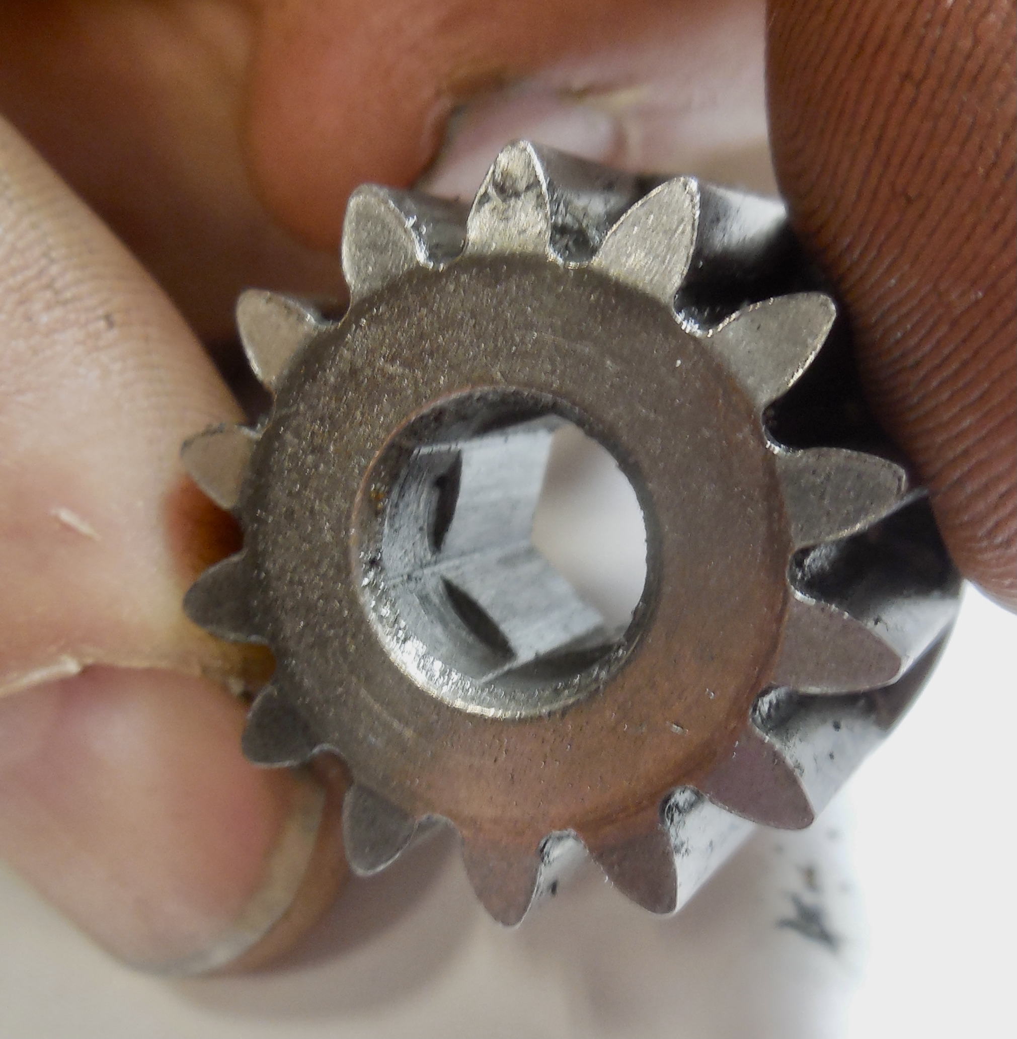

I left the remote on a few seconds after the cable had already come in. Now it won't take a load and makes a funny sound when I'm reeling in the cable by remote. Any simple solution or has something broken inside the gears? I have the parts list and schematic for it. I looked inside and could see nothing obviously broken. It looked too involved to remove all the gears inside so I closed it back up. Still does not reel in as it should or under load.

Might have burned a pole in the motor from stalling, and you might smell the result. It would 'growl' and lose power if so.

sound like you blew the gears. does it have a free wheel clutch? make sure its not partially engaged

My visiting mechanic son took it apart last night while I watched, fascinated, and he found no broken gears among the many it has. We will ck the solenoid next. He had replaced a solenoid in it last year with one from China that we had ordered. Different symptoms this time so he did not check it first. Will post any positive outcome of that check.

Still celebrating Christmas and it was the only time our son can come up to do stuff like this. He did find the problem today. It was item ref #5, Stage 2 Sun Gear #70390 on their parts list. It is under $30. I have written to Warn and sent them pictures of this gear. This winch is lightly used with no grit, dirt or water inside. Our son feels the part was defective and not hardened sufficiently when it was made. I will attach a picture of the damaged gear so that it might help others with this problem.

That looks like a sintered vs machine-cut gear. Not gonna be the strongest, just much lower cost to produce.
