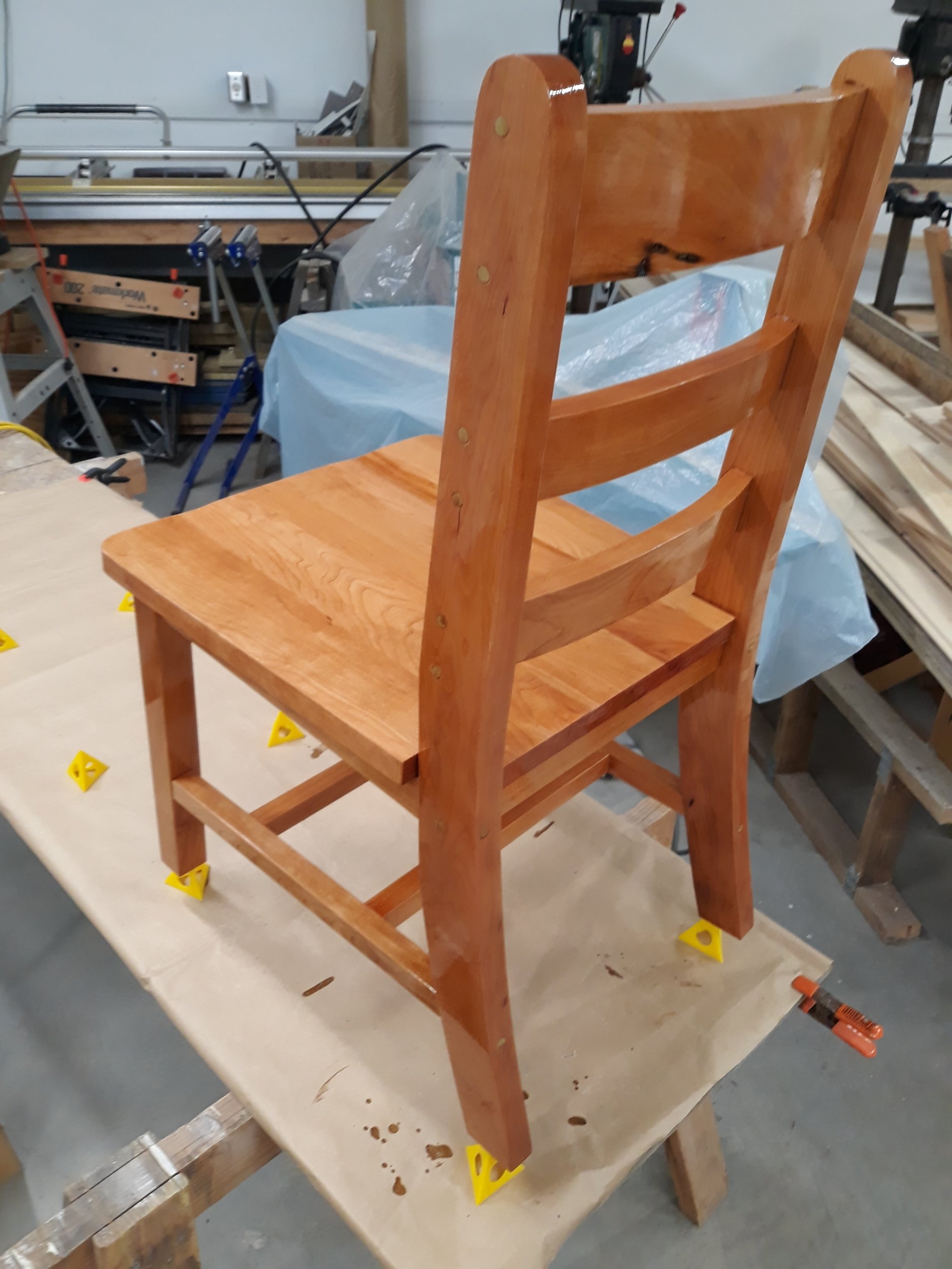

Lots of bad talking OP out of a sawmill here. Mostly talking him into one. I have had my Timbery 120 for 2 summers. Ordered in May during covid, received in Oct. Cut a few logs, stored sawmill for the winter. In Feb the following spring I received 20ish red and white pine, 12ft long 22" to 26" at large end. Heavy. I have a Kubota B26TLB to handle them and the stickered piles. I think I ended up cutting 6 to 7000 BF that summer. That is air drying. Also cut about 1000 BF each of oak and cherry. This past summer maybe 1200 BF of white cedar. That red or white pine, maybe 2 logs in a 6 hour day. Cedar was mostly 10" to 12" dia, 10ft long. More logs cut in a day.
Built a nice desk chair for the grandson out of the cherry. Kiln dried it and oak for me. Rough cut wood takes a lot of time and handling and equipment to mill it for nice finished furniture wood.
Also built a deer blind out of the 2" rough cut pine. Again took time to resaw into 1" boards, plane, etc.
I won't talk you out of getting a sawmill, but being retired I can spend my days cutting trees into lumber. Also what it your supply of trees? Cut of your land, or someone's land? Buying logs adds to the negative side of the sheet.
Seeing your own logs turn into finished projects can be rewarding, but it is more time consuming than going to the lumber store to buy what you need for a project. Working a full time job, having a family means less time for sawing. Your wife is for the mill, will she help stickering the wood? Having a second person is helpful, especially with larger logs.
One thing no one mentioned, is moisture meter. I find it is helpful determining if I can use the air dried lumber or want to wait.
Long winded, sorry. Jon
