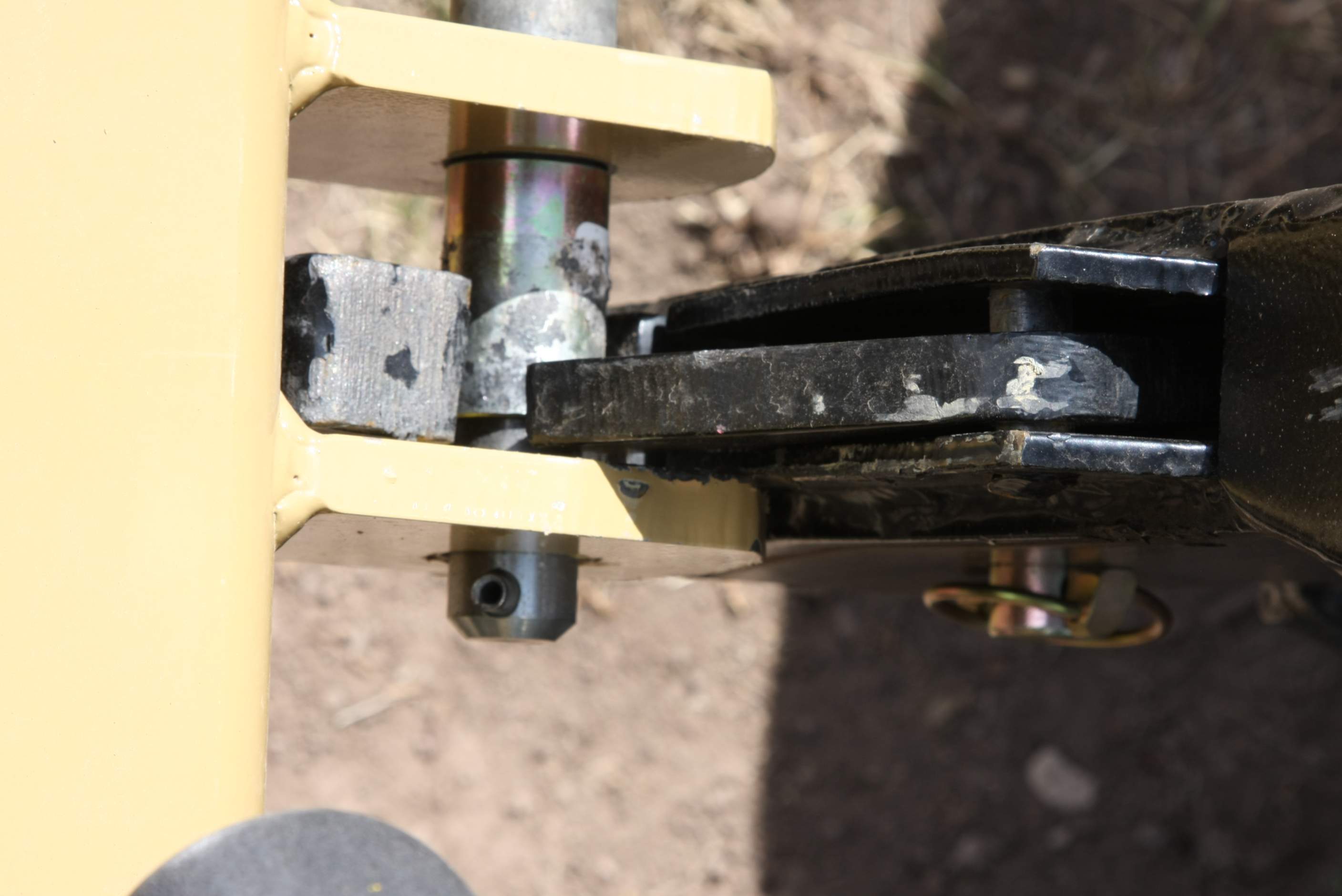

How close do these measurements have to be and what numbers am I looking for? What type of clearance?
Here is a photo showing the left 3pt attachment. The tan part is the Landpride blade, the black is the Speeco QH. Notice there is a flange on the QH on both sides of the latching member. The right flange is wedged up against the Landpride's bracket. This might be hard to see because the right flange is in the shadow. A photo of the right 3pt attachment would show that side is just as tight. Landpride advertises this as "QH Compatible" and it would be compatible with this QH if the QH didn't have those flanges.
   / Want quick hitch but am confused by choices. Which one? #47
Photo above should have been rotated. The "right" side is at the bottom.
