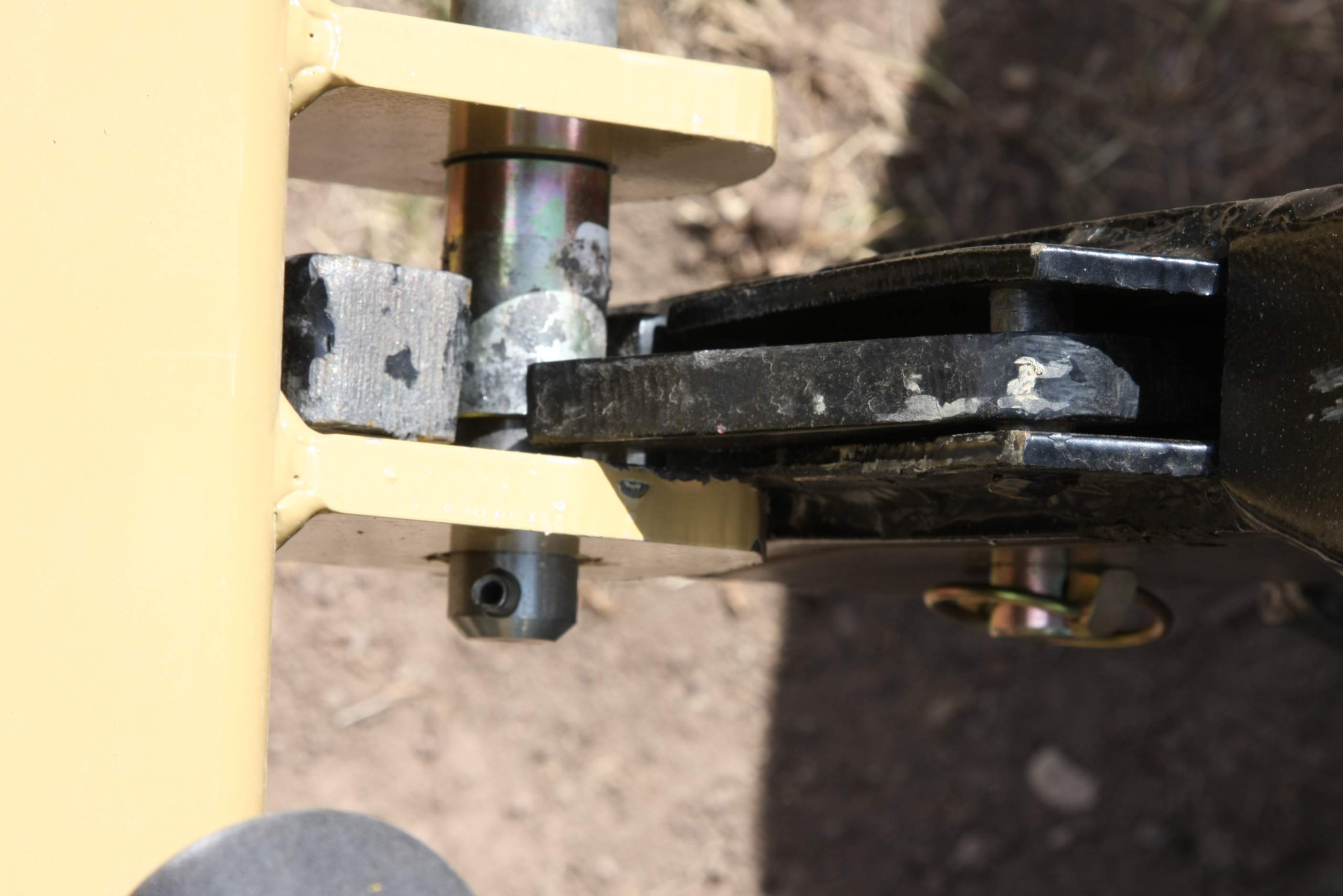

Here is a photo showing the left 3pt attachment. The tan part is the Landpride blade, the black is the Speeco QH. Notice there is a flange on the QH on both sides of the latching member. The right flange is wedged up against the Landpride's bracket. This might be hard to see because the right flange is in the shadow. A photo of the right 3pt attachment would show that side is just as tight. Landpride advertises this as "QH Compatible" and it would be compatible with this QH if the QH didn't have those flanges.

are you sure those aren't the same picture?

Shame that a standard is not really a standard. Perhaps your Land Pride blade is QH compatible with a Land Pride QH. My Land Pride rake and tiller fit both of my Land Pride Cat 1 QHs. Some of my other attachments are a tight fit similar to your situation but they did fit without modification. I did put bushings on all my attachments, they are pretty cheap at TSC, but they do rust and cause a tight fit. I have to use a little WD40 and tap with a hammer to get the QH to let go occasionally if the attachment stays on for long.
