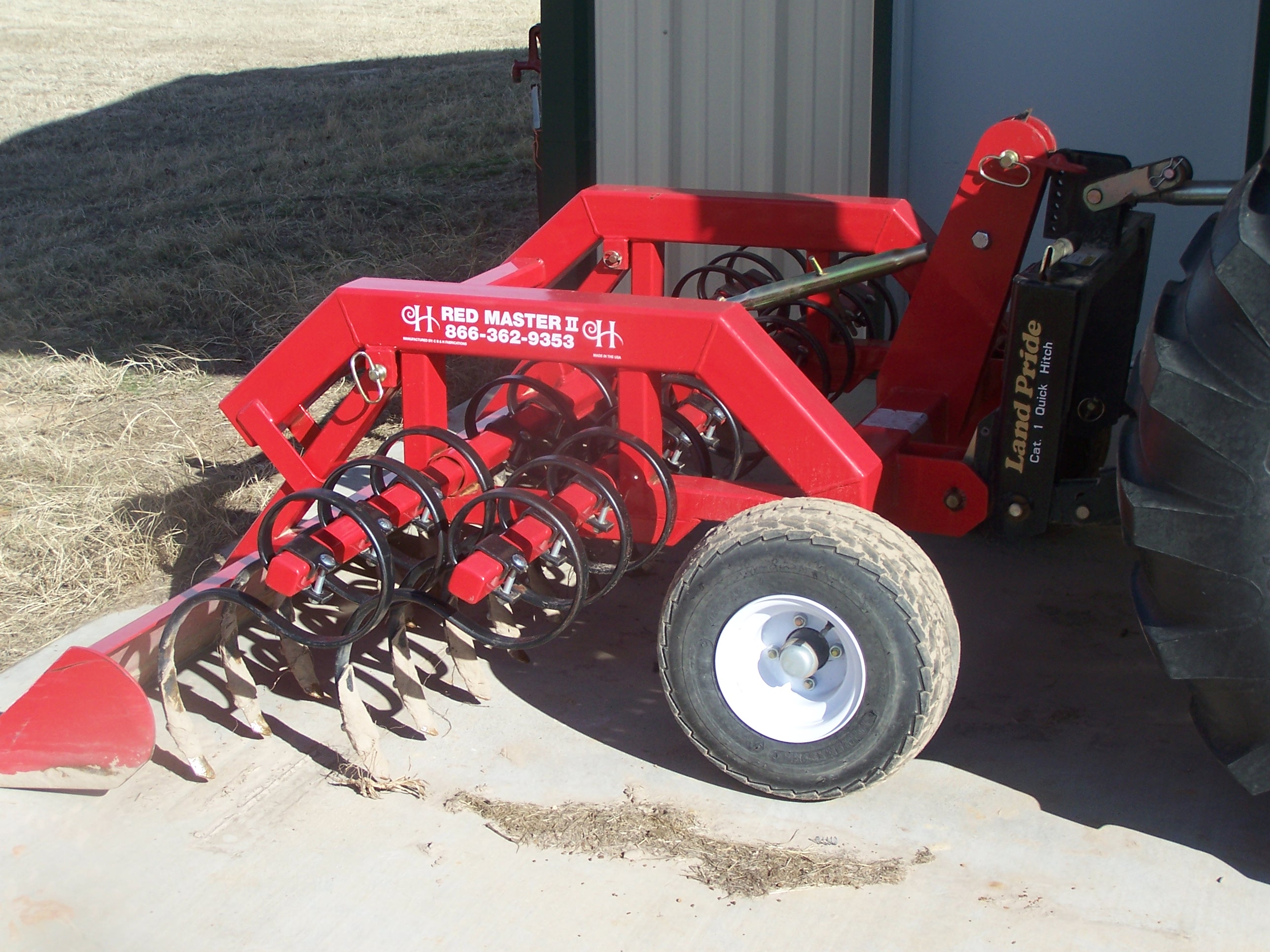

I've been looking at quick hitches. I have a Land pride rear grader blade and a Land Pride rake with castors I use on a JD 850 CUT. is the Land Pride quick hitch worth the difference in price?
   / Want quick hitch but am confused by choices. Which one? #22
I have a Land Pride Cat 1 on both of mine. I do have to adjust the top hook for some attachments. I did not have to modify any attachment. Just lucky I guess. As far as quality I do believe you get what you pay for.
