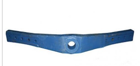

Is your tractor 2 WD with adjustable wheel widths?
If it is you probably have a center axle with various holes in it to widen or shorten the wheel width.
I broke an axle like this on my 3910. Ordered a new one but it is not available as an OEM part anymore. So they ordered
some foreign made aftermarket replacement. Within 2-3 uses doing nothing more than scooping horse manure with the FEL
the Camber began to change, more on one side than the other, which caused steering problems. Closer looking revealed that the
aftermarket replacement apparently had not been hardened properly and the axle was bending up.
Replaced that with a used reconditioned crack tested axle and it has been fine for over 400 hours of use.
Might not be related to your problem since you did not define what type front axle you have. Front Axle.jpg

Thanks I replaced the wheel bearings, half moon keys at the top of the kingpins this has tightened things up a fair bit though apart from one worn ball joint that I will replace when available, the drag links etc ar pretty good.
There is some evidence of the camber being wider at the bottom than the top of the wheels so the next thing I plan to do is check the main axle for true along with the adjustable stubs.
/ Wandering right hand steering Ford 4110 #12
Would be better if it were a little wider at the top for steering box and wheel bearing wear.
Wider at the bottom was what made me realize the non OEM replacement axle was bending. When I rolled the barn door open that the unit sits behind my eyes saw the wheels
spread out at the bottom being different than it had been for years before.
Check the cross axle for hairline cracks where the bolts go through. You might try taking the weight off the front axle and loosening the bolts enough to see the cross axle
where it makes contact with the wheel arms.

that camber out can be from worn spindle bushings as well
