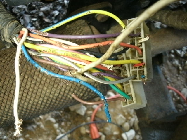

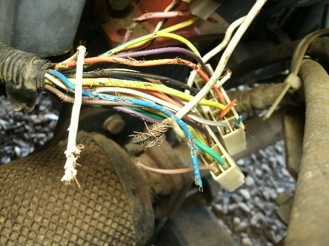

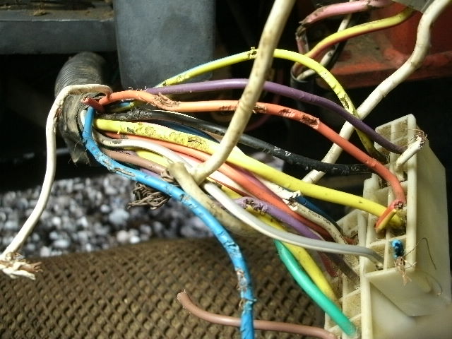

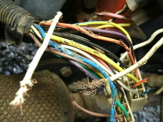

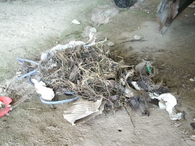

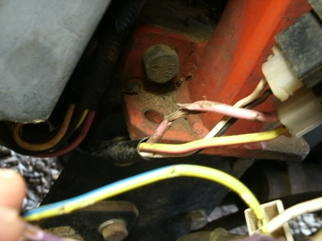

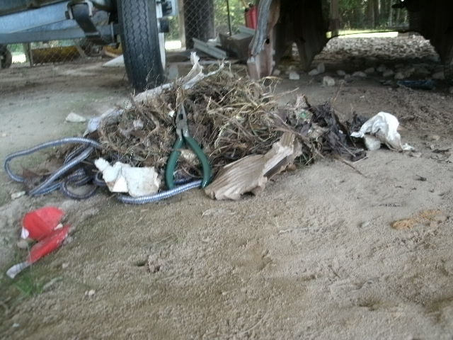

For those that have followed my post on starter trouble, I am now posting some pictures as to why I had to initally jump starter off at solenoid. As I stated before, I came behind someone else who put a new solenoid on tractor as it would not crank. After he was out of the picture, I got called in. I could not get it to start either from the panel, so jumped it off at solenoid and knew right away starter was still engauged to flywheel. Hurt my arm and had to wait to investigate further as to no power from switch and why starter was not disengauging.
When I pulled the instrument panel off the console, I got the surprise of my life, there was a lot more in console than I thought, a rat nest. I later had to pull the fuse panel assembly and remove it to pull the wiring harness out the side of the tractor. Below are my findings.

Wiring all splice together, new starter, and it cranks. Now another new problem I will post under "no fuel out of juel pump".
