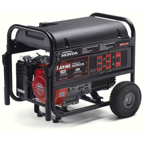

I would like to add a volt and hour meter to my generator, is there an easy way to do this? picture in attachment below
Thanks

Pull start so no 12v battery on board.
Guess you could get a 120v driven mour meter / clock and run it to one o fthe 120v outputs.. or a hobbs 12v meter and do the same with a simple circuit with a resistor, diode bridge and regulator to get down to 12v dc.
Another thought is a small watch battery powered tachometer that uses a inductive wire pickup on the spark plug wire.. Many units have a hour meter.
Volt meter is easy.. find an analog meter or digital voltage display and wire up to the circuit...
There may be a comercial unit add on that already does theis.. I dunno?

Do a search for "Kill a watt" on ebay. Some of them are more, but there are ones for less than 20 dollars. They also tell you the cycles, which is probably just as important as the voltage. I bought one for my Steiner, to keep the output as clean as possible.

The Kill-A-Watt is selectable to read out freq or volts and even will give you the accumulated watt hours you produced if you want.
Otherwise you can try Digikey, Mouser and the like (G O O G L E )for a volt meter and an hour meter. There are several surplus outfits selling good stuff for your purpose really cheap.
Don't bother filtering the supply to run the old style Hobbs meters as they are just a solenoid wound escapement driven timer and are not sensitive to waveform. If there are solid state components then filter it.

Second the Kill-a-Watt.
It will just plug in to any outlet and give you volt and freq info. You can also plug an apliance or power cord into it and it will tell you the electrical load being drawn thru it in amps or watts up to it's 18A/2KW maximum. It will also give you the power factor for inductive loads. It will totalize an electrical load, so you can plug in the freezer for a month and see exactly how much power it is consuming short and long term in KW hours. Pretty handy for doing an electrical load study of your plug in appliances and seeing how large a generator you actually need. The older model will unfortunatly loose all it's stored information when it is unplugged but mine is handy. I guess they have a newer model out now that has a memory battery in it so it retains the recorded data when it looses power. I assembled a slow speed diesel generator this past summer and that is my only generator instrunment. I use it to set and monitor the RPM/frequency. Harbor freight recently started selling them in their stores, I am not sure if they are on their website or not.
As for an hour meter, you can get one from surplus center for around $24. You will need a small 12VDC or larger plug in power supply to power it. They run on 10-80V and consume about 6 watts if I recall the label on the one I just bought. The battery operated/inductive pickup models used on many lawn and garden tractors are pretty expensive, but would make a more compact installation on the pictured generator.

My cheapie Kill-a-watt I bought at HF has time on it I believe (or am I having yet another "senior moment") but if you use your generator for 220/240 VAC power the Kill-a-watt is essentially useless. I think the max current/power rating is a bit anemic for any "MANLY" sized generators even on 120VAC.
Just how cheap are you? There are lots of DIY approaches for getting an hour meter and or a volt meter. Current meters (to measure the amps being drawn from the generator) are also handy and pretty simple to cobble up cheaply.
Stuff like Digital Hour Meter and Tachometer | Small Engine Accessories | Northern Tool + Equipment is nice but maybe more than you want to spend or you might not need the tach.
Panel Meter 0-15VDC
Model: 22-410 | Catalog #: 22-410
This panel meter is ideal for monitoring a power supply, battery charging system or car electrical s...
It is $12 from Radio Shack. A little fussing and SHAZAM the 0-15VDC meter becomes a 0150vac meter or 0-300 volt for 220-240 monitoring can be switch selected from 0-300 to 0-150 AC pretty easily.
Any of the electronics types hanging out here should be able to whip up a schematic diagram to make the mod(s) and I estimate the cost of additional parts to be under $5.
If you can find a cheap voltmeter (approx 0-15 VDC or so) suitable for automotive use monitoring the 12 volt battery it can be used to monitor 0-150VAC pretty easily or 0-300 to cover 220-240VAC.
I personally recommend the automotive type meter as it may be more rugged as regards surviving vibration. Not all meter movements will live a long life mounted on a vibrating generator.

They have an assortment of hour meters that run on DC 6-28V and AC 115 and 230V priced from $17 and up. Just hook up to your 115 or 230V plug and they will start counting hours whenever you run the generator. Radio Shack has Volt meters. I did a brief search and found you could get an hour meter and a digital volt meter both for under $50 and easily install them. My generator has an hour meter but I'm thinking of adding a digital volt and frequency meters to read the 115 and 230V plugs.
