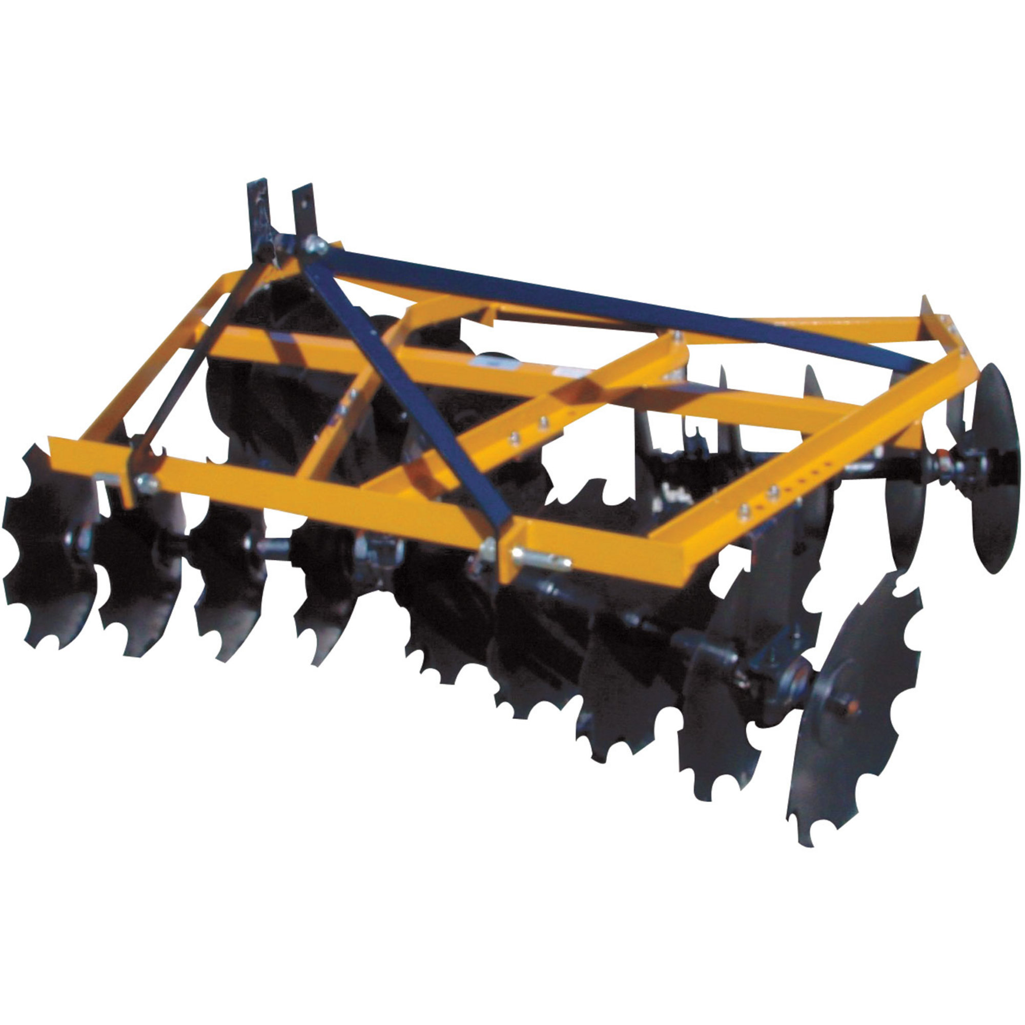

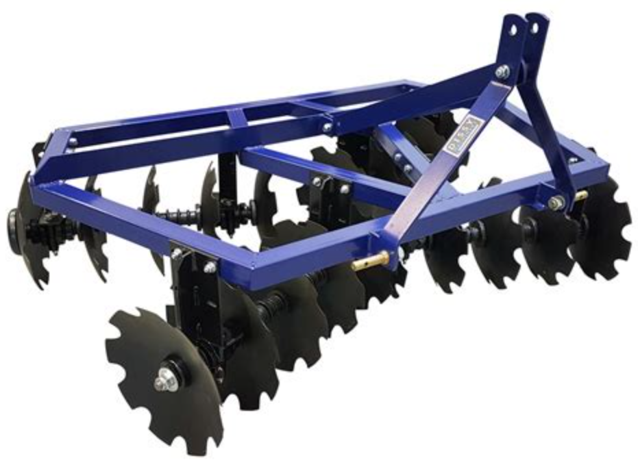

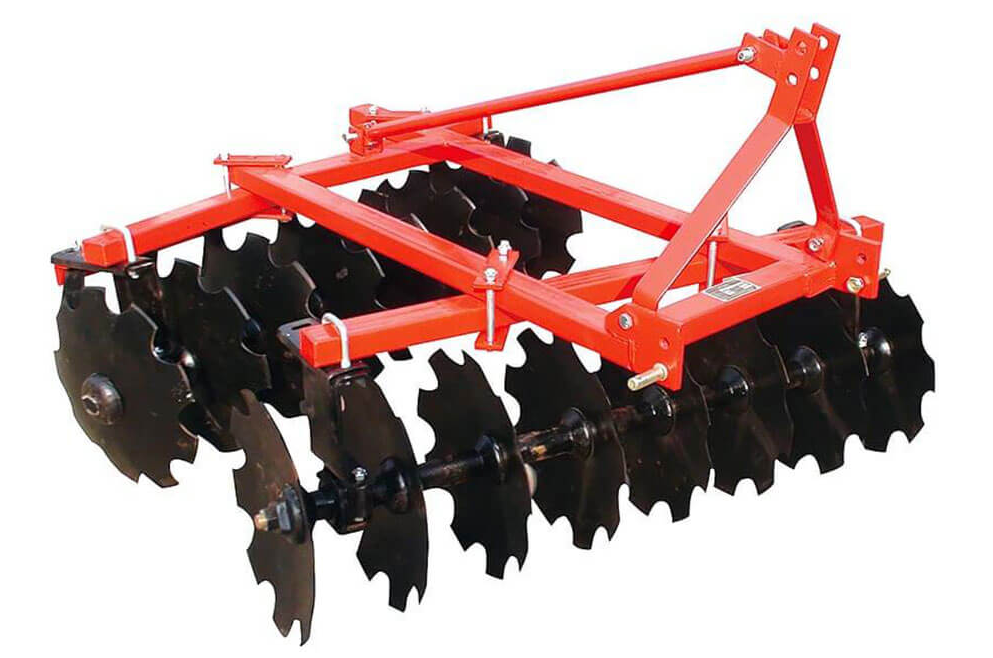

dual gang - - -
single gang
(not a big fan of this setup)
Mine is notched dual gang double row (see below). Thus, it's ideal for areas with plenty of woods nearby or areas that were recently logged.
It's been a great working piece of equipment for root busting and pulling the rocks out from under the soil to the top. The gangs are also adjustable to the right attack angle too. Over 3,000 trees logged at my place. This tool has been the best thing ever to get the soil back to full pasture.

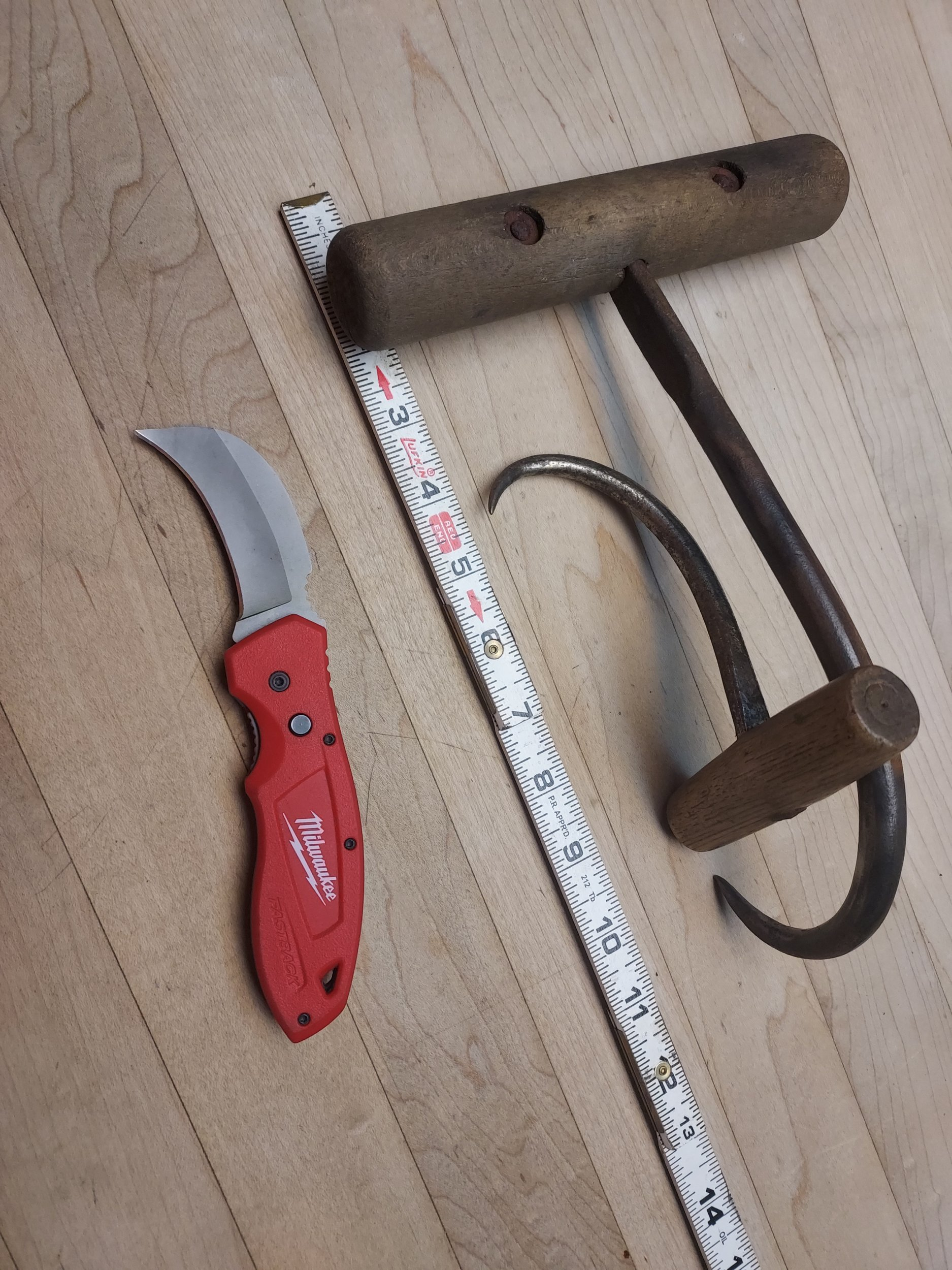

In addition to the parrot's beak (linoleum or pruning knives) I use longshoreman's hooks (bale, large or bag, small)
