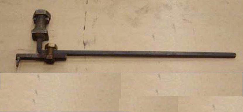

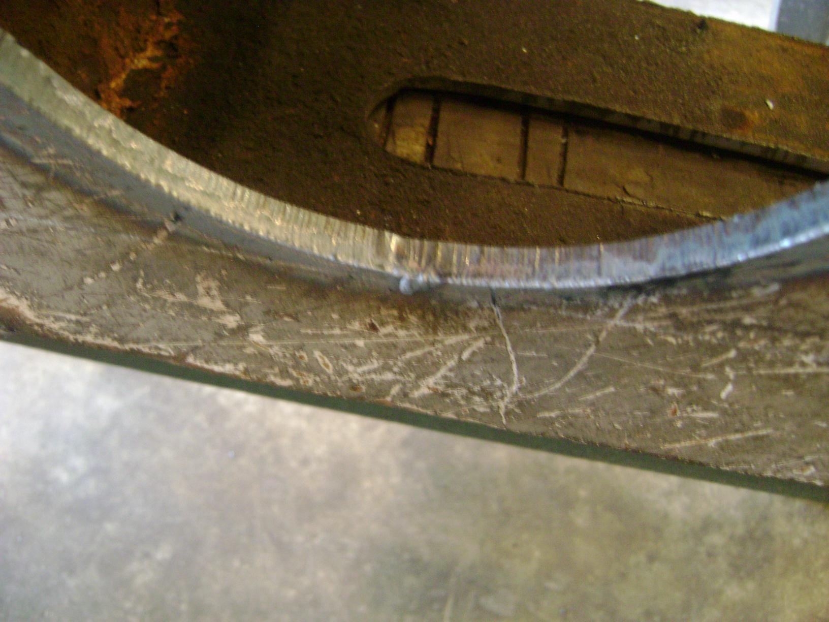

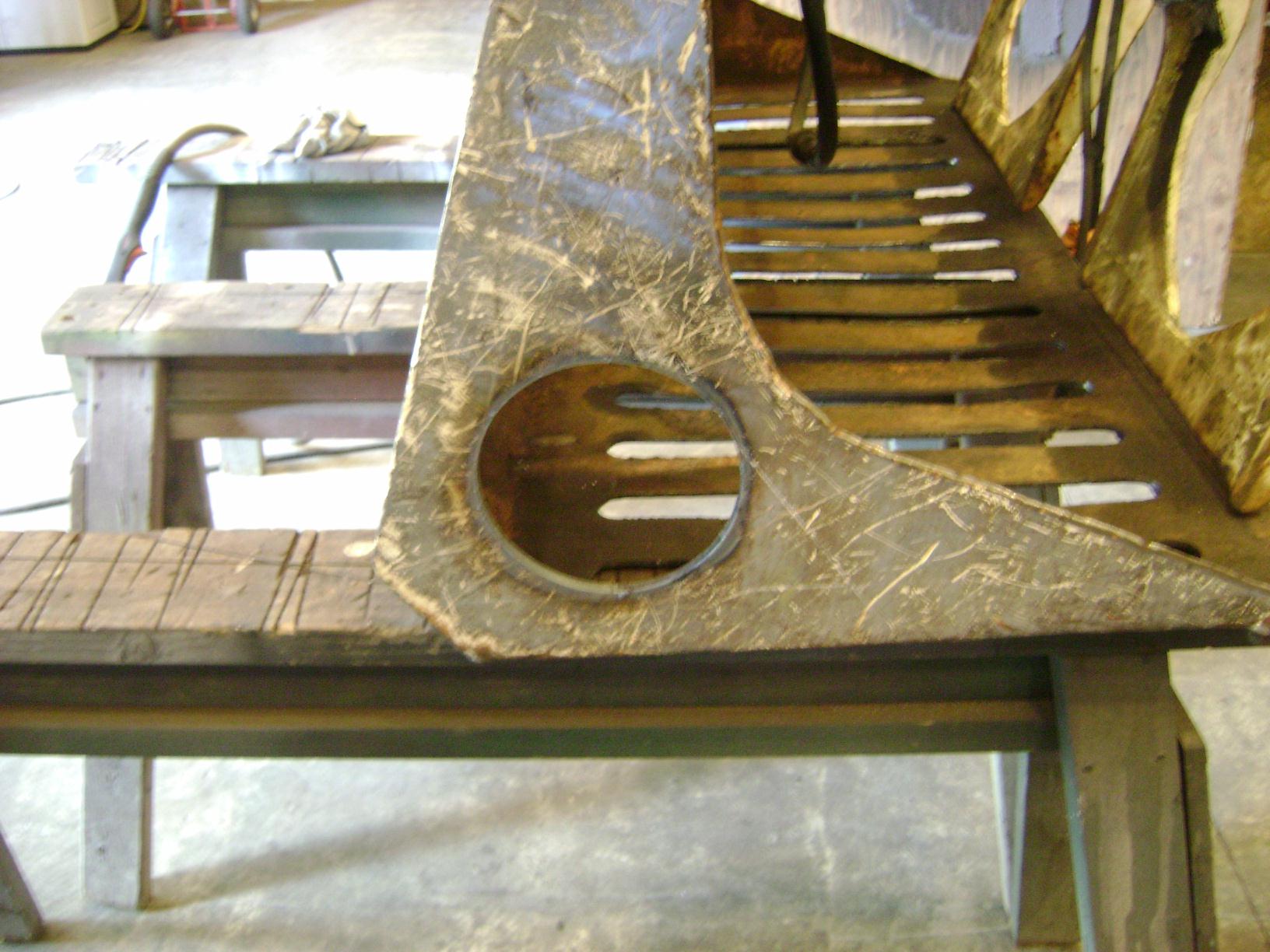

/ victor mht-100 #4

/ victor mht-100 #6
Sneaky use of Grounding Rod Wire Clamp on dat circle cutter slide!
:thumbsup:

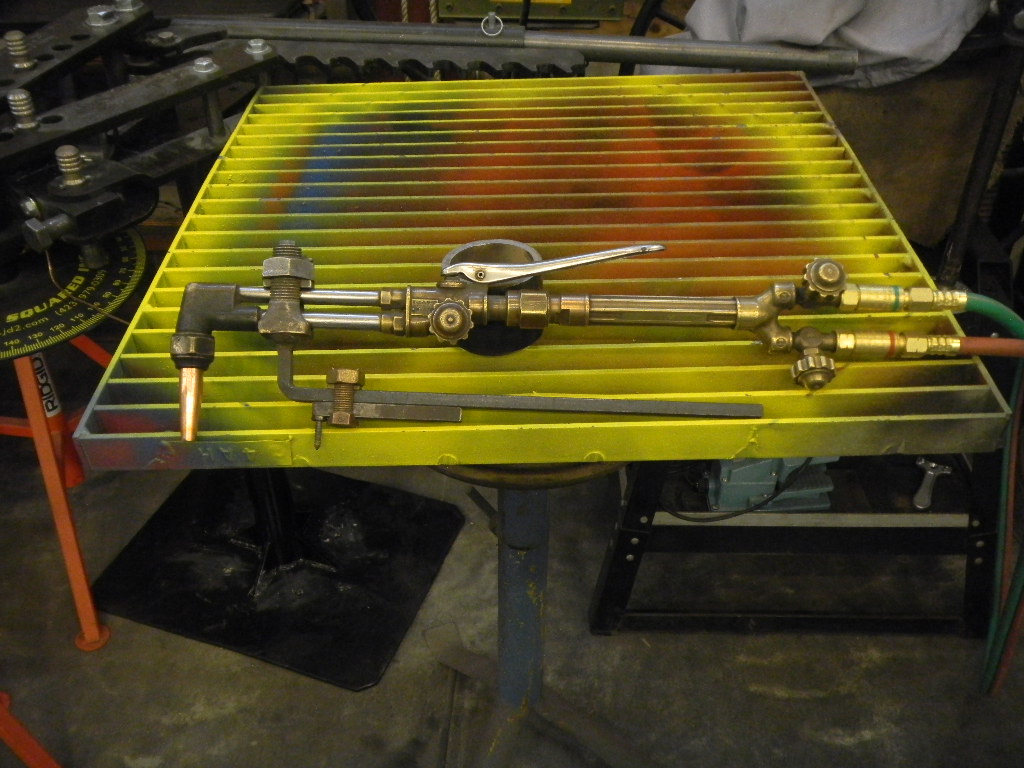

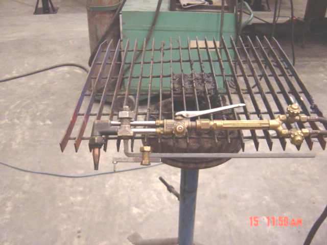

/ victor mht-100 #7
Hey Shield Arc
What is the device in the left most pic?
RC
Circle burner, works fantastic with my rotating table. It is amazing how accurate of a circle you can burn with this system.;)
