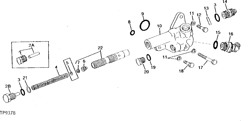

I purchased with this problem, I will do my best to explain.
early 80s JD410 Backhoe..... Backhoe, Reverser, Steering etc all work fine.
Front loader is VERY slow.
I am told this happened after a clutch install....
I am a retired Master tech for Autos... limited experience with Hydraulics. Im sure I can fix it... once I find a place to start.
Thank you

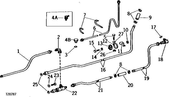

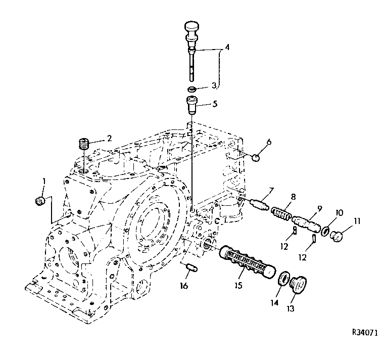

410 hyd system is closed center with a trans pump(low pressure) that lubricates the trans plus supplies oil to frt pump that creates the high pressure. Sometimes on clutch R&R the hyd lines(parts key 16 & 20) have been inserted in the incorrect holes when tractor is slide back together. Normally when this happens no hyd's operate. How long since hyd filter was changed and sump screen(parts key 15) checked? I would also suggest to check stand-by pressure which should be at least I'm guessing 2350 psi but my knowledge of JD ind tractors is limited as I was formerly employed by an "ag only" dealership. There's also a pressure control valve(photo 3) down by hyd filter but it is designed to give priority hyd pressure to steering except it has fitting(parts key 16) that ag tractors don't have that I know not it's purpose.

Thank you.... Very helpful.
/ Very Slow loader..... Help JD420 Backhoe
Update..... I like to post results incase someone else runs into the same problem....
Its fixed.... I removed the Prioity valve and took it apart very carefully.... #6 in the above diagram was lodge in the tube sideways. The prev person did not get it in straight... it was actually stuck. I had to knock it pretty hard to get out. the edges were rough. I filed down the rough edges... reassembled correctly... and it works great.
Your advice was spot on.
