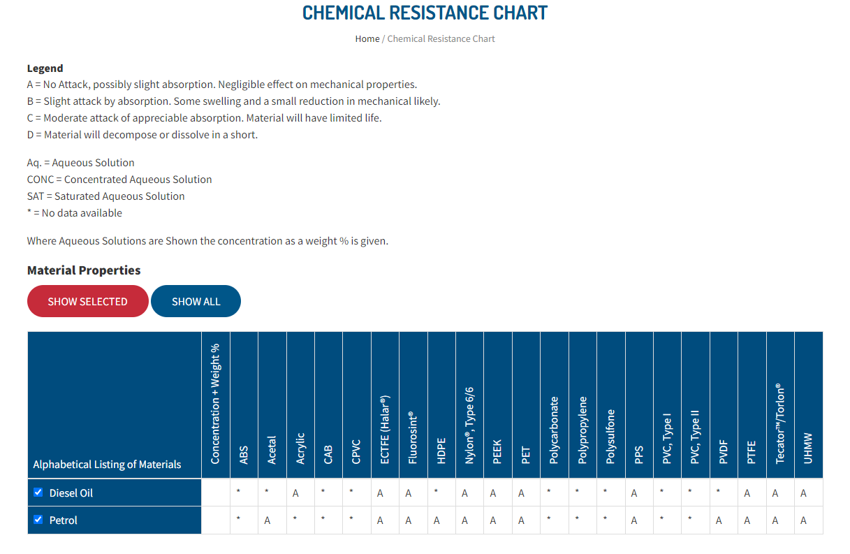

Hi,
As the other guys are saying. Check the plastic type to be sure. It is usally easy to do by looking at the bottom for the number inside the recycling triangle and the letters just below. Typically these will be 2 and HDPE or some variation of it. This indicates that it is chemical resistant High-density Polyethylene and is a bit more durable which is good for fuel jugs. Some of the other plastics may be chemical resistant too but not as durable. I never bothered to investigate it that far after finding a few I liked for diesel without those ridiculuous and almost unusable valve caps.
The reason some #2 jugs are marked "not for fuel" isn't necessarily because the plastic is not compatiable, it's because the jug doesn't have one of those darn caps so the company needed to add a disclaimer.

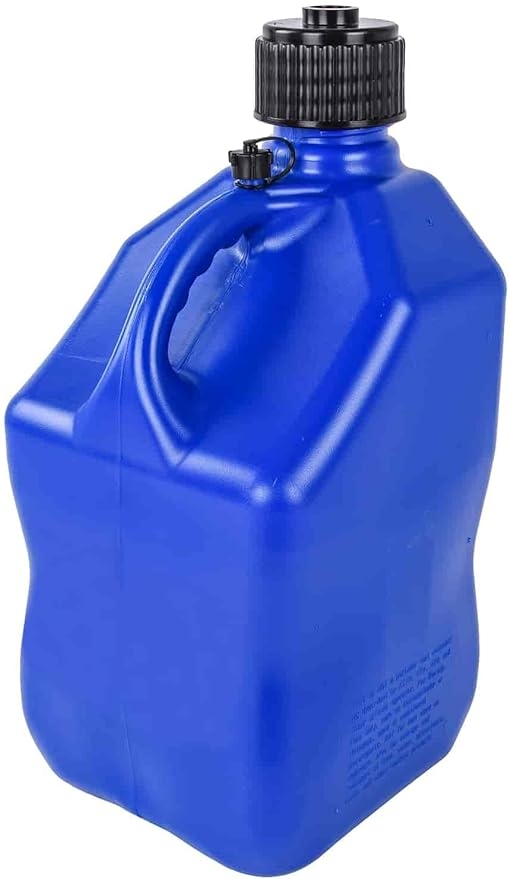

So I bought a vented non fuel jug today. As best I can tell it can be used for fuel other than the fact it has the old style vent cap you can loosen to let air in. Any reason to not use these for diesel? The one I bought is like the picture below except it’s yellow. I of course wouldn’t use it for fuel since it says not to. ;)
Manufactory only recommends for kerosene and diesel

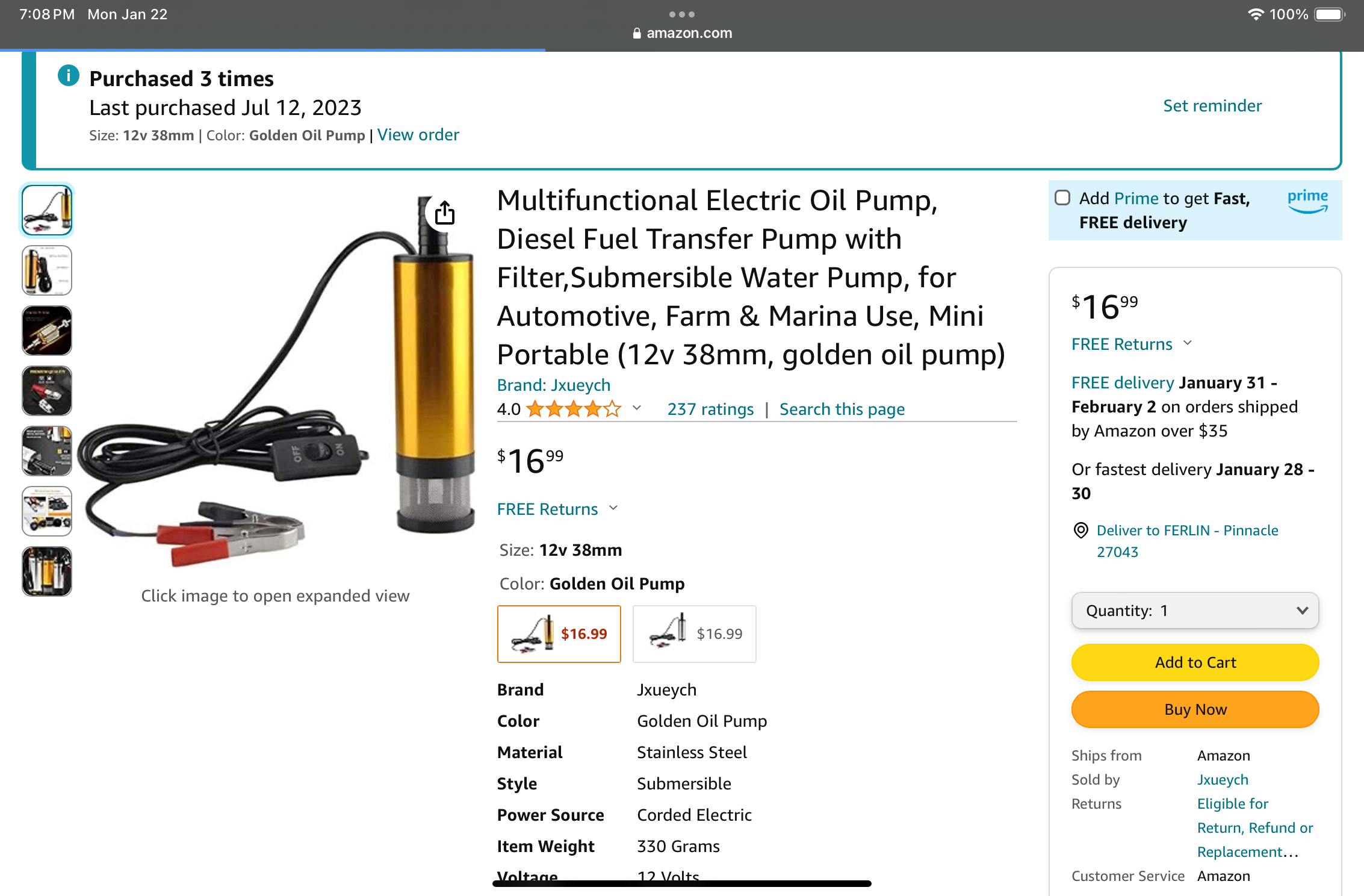

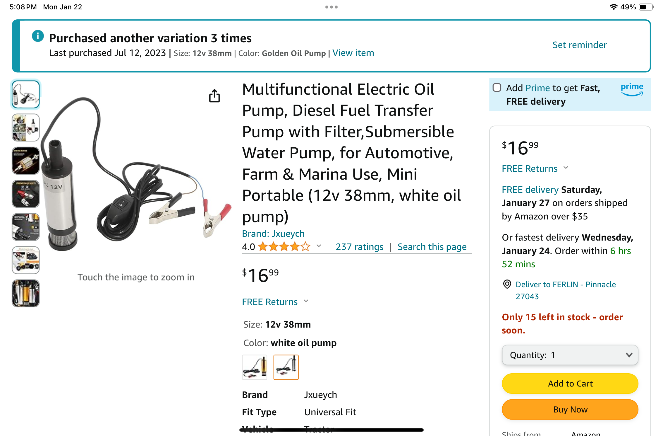

fuel, which they work great for. Not recommend for gas because of expansion and fumes. It has a bigger mouth which works great to use a 12 volt pump to remove fuel. The 12 volt pump is not for use with gas. The following https://www.amazon.com/Multifunctio...0&psc=1&mcid=95d2d53fe6af3655880b8dc11bd9c185
the attachment shows the ones I had the best luck with. Buy a couple extra because as soon as your neighbor watches you empty 5 gallons of diesel in your tractor in about a minute they will want one.
