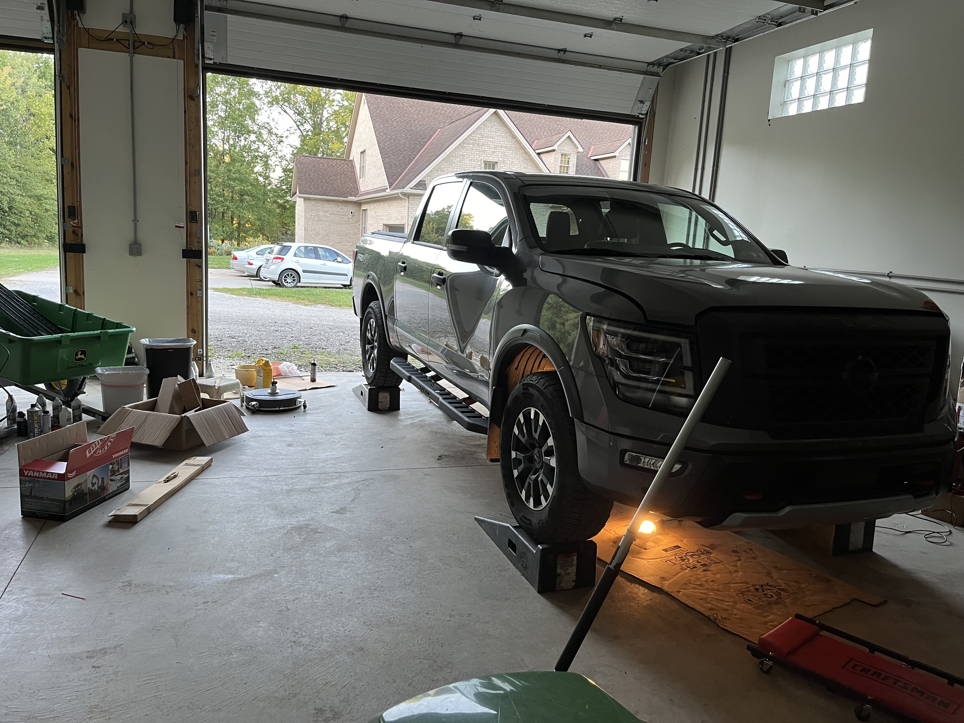

I do all oil changes and other general maintenance on my cars and equipment at home. For a couple of BMWs, I drive the front wheels up a pair of ramps for oil changes. If I have to raise all four wheels for non-tire removal type work, then I drive the vehicle (truck and our subaru's) up 4X ramps or for the lower clearance cars, two ramps and then raise the rear (or front if I drove up the rears) with a hydraulic jack on each side and sufficiently high so I can slide in 2X more ramps and have the vehicle raised and level on 4X ramps. For wheel removal type work I will use jack stands.
If the front of the car is real low and you need to lift the front only, then you can use a low profile hydraulic jack on each side to progressively lift each side a little at a time until you can slide ramps below the wheels. Make sure to block wheels as appropriate.
Anyway, a couple of recent maintenance pictures. yesterday was front stabilizer bar bushings on a Crosstrek. The truck picture is from last week when I replaced front and rear differential fluids.
