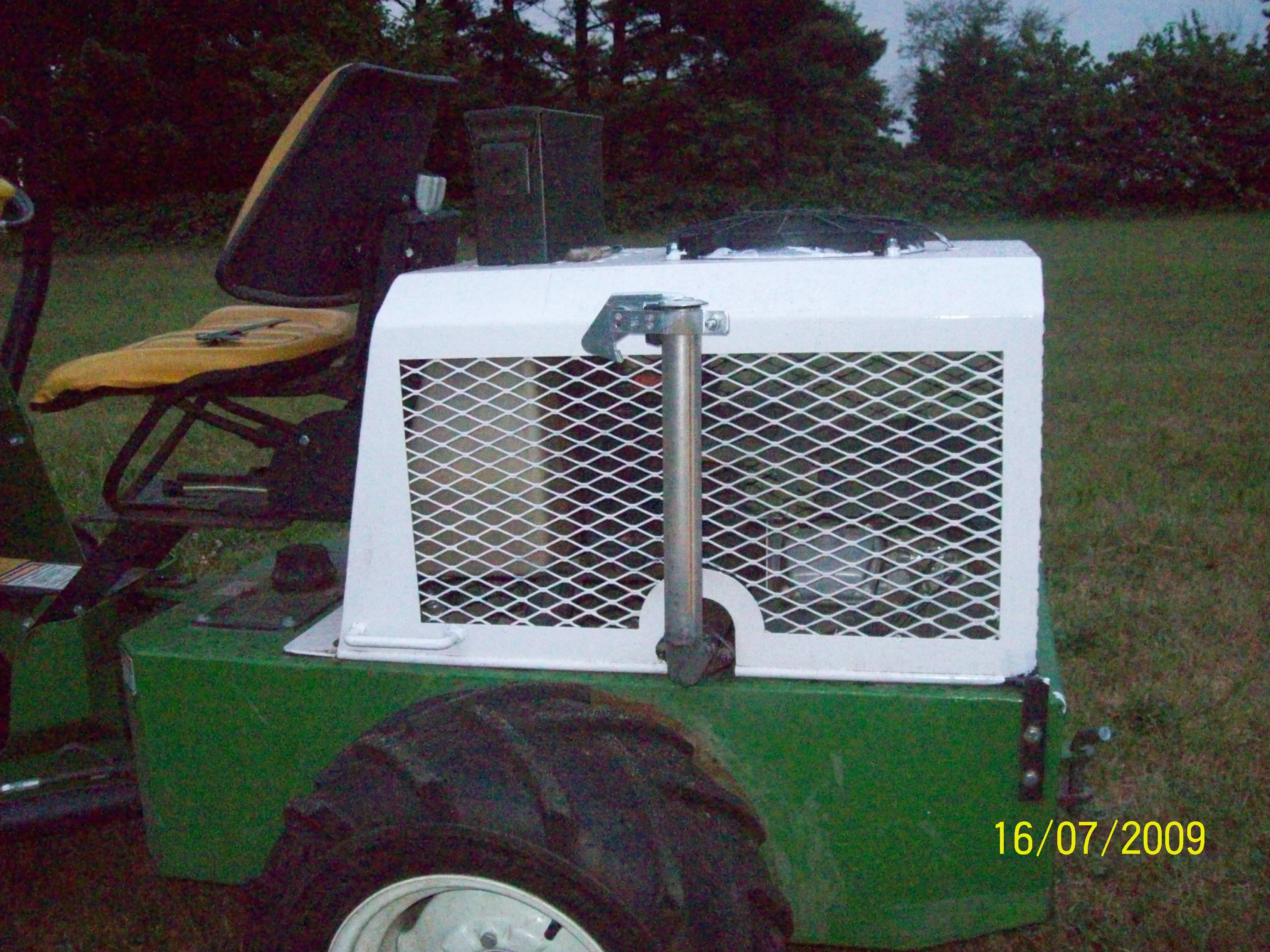

Since this thread surfaced again, I'll update that the side cooling fan I put on the engine cover has elimated my vaporlock problems entirely. It would have been better if I'd tied the power source directly to the hot lead for the hyd cooling fan and someday I'll rewire, for now I just have to flip the switch every time I expect to be operating the PT for very long if it's hot outside.

this is how I fixed the VL problem on my 2007 model 425 please note a motorcycle style baffle is in the straight pipe (keeps the neighbors on good terms) I also welded a longer stud onto the carburator so I could use commonly available Kohler airfilters
/ Vaporlock revisited #113
a little more info the muffler was replaced because I accidently backed into a tree and bent it :eek:original muffler had approximately 12 3/16'' diameter holes on inlet and the same on outlet pipe :mad: suprised the motor could run with such a restriction:eek:replaced with straight pipe with internal baffle:cool:now it starts quicker it uses less fuel and no air bubbles in fuel cell, plus no backfiring when shut off and no more glowing pipes when working at night I have been checking my plugs to make sure I am not leaning out the motor;)I guess the fix was acheived through accident/incedent I have also noticed the engine runs best on 89 octane fuel not sure why maybe more complete combustion? thoughts on the octane?
