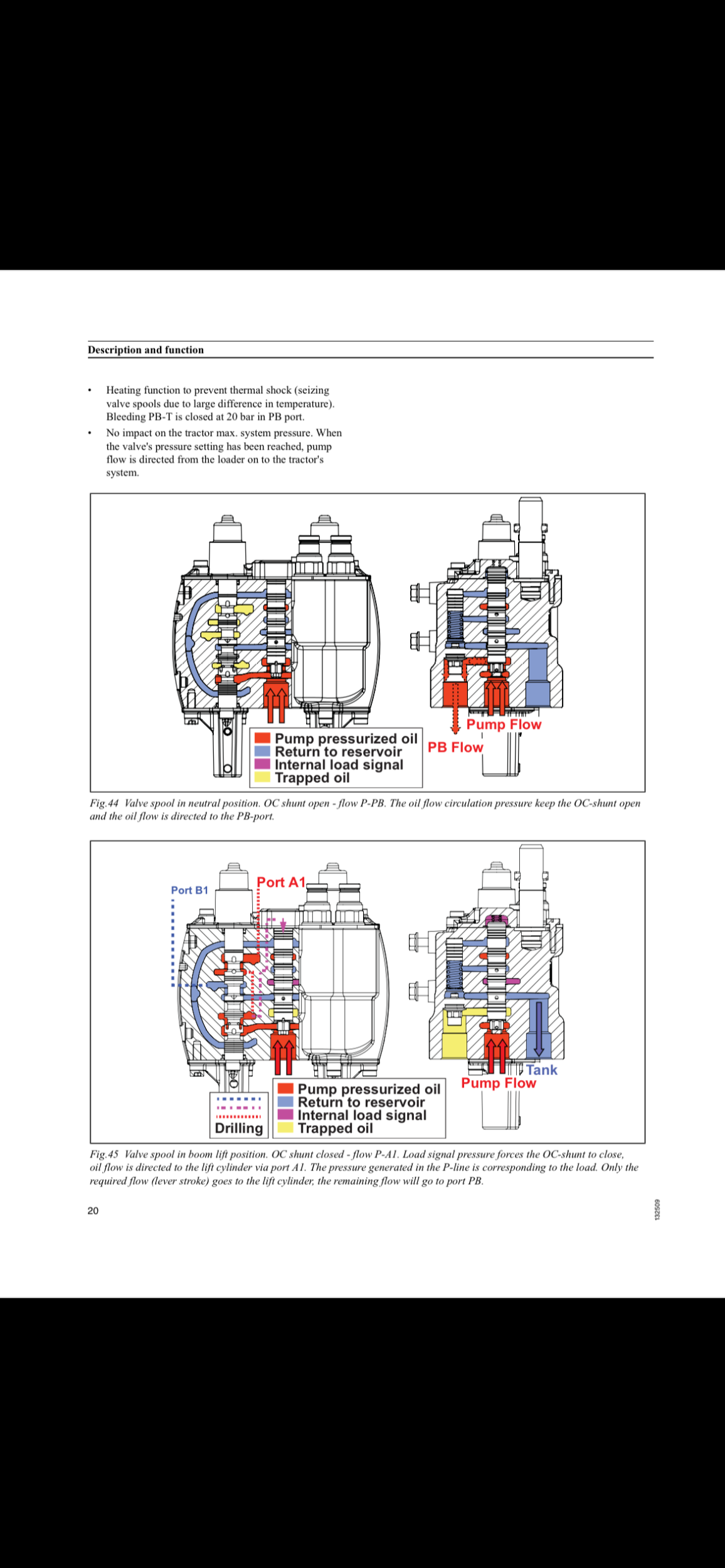

I could be 110% wrong but everything you have posted is tied to steering with exception of the parts breakdown and sectional view of loader valve. Typical system loader and 3 point are seperate circuit from steering.
You have done great job of posting what you have and am starting to wonder if the loader valve schematic is not in service manual.

My apologies. Do you mean this diagram ? I haven’t been able to find an diagram schematic for the valve in the repair manual other than this one here I previously posted

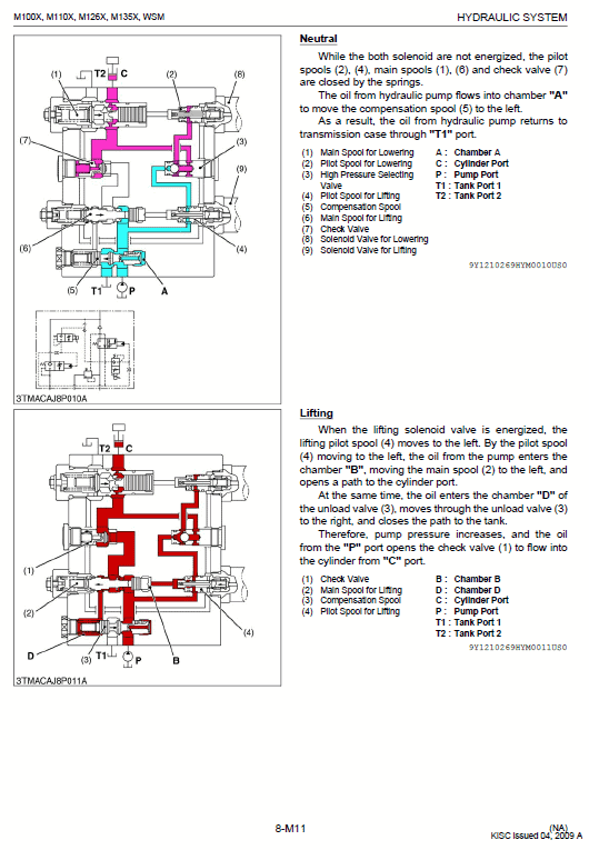

If you posted img 9959 previously I missed it but that does help.
Item 3 High pressure selector valve is drawn like it could be the shuttle valve sending pilot signal to increase pressure to loader circuit. On my phone now so can’t enlarge the schematic but will look when I get home.

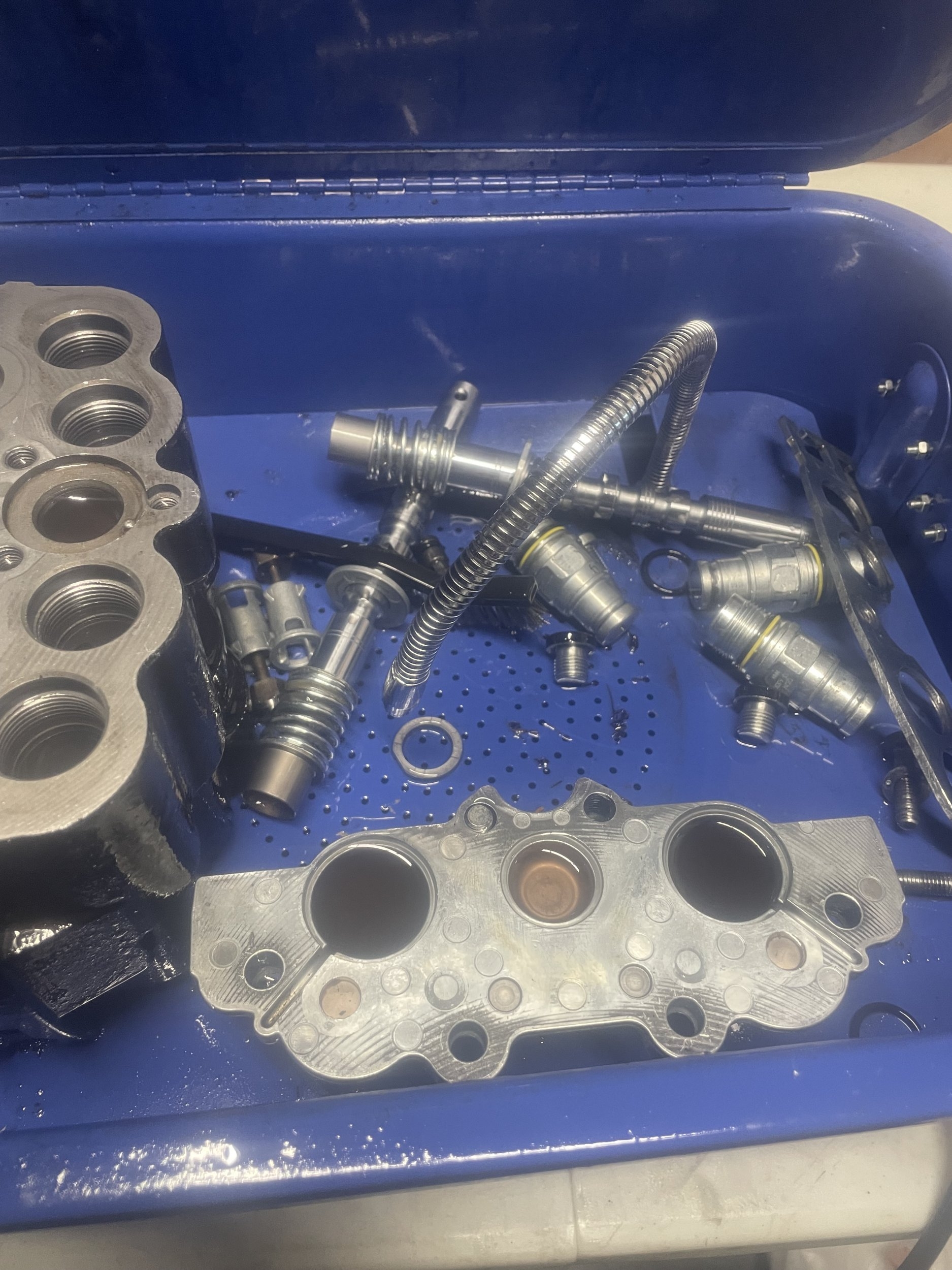

Thanks for your tips . Just an update. I’m currently cleaning parts and finding debris here and there . Hopefully once i get it back together and install it functions , we shall see .

image 9806 shows the drill path in purple for the pilot sense line while image 9959 shows the connection during lift stroke between lift spool and the compensator - pressure control.
I wish you the best on getting everything cleaned up and operational.
