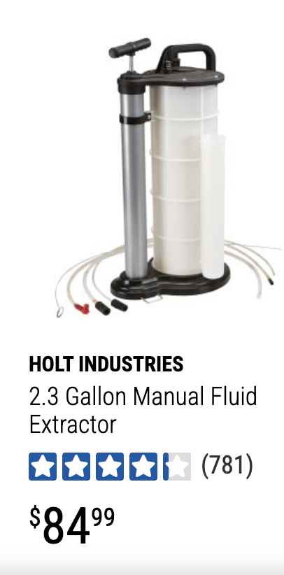

/ Vacuum diesel fluid? #25
Tool shopping time. Harbor Freight model

So an update to this:
I finally got around to messing with this, bought a self priming diesel fluid transfer pump kit from amazon for about 80 bucks. Got a bunch of stuff out of the tank, the setup worked perfect. See pictures below. I found no water by the way.
