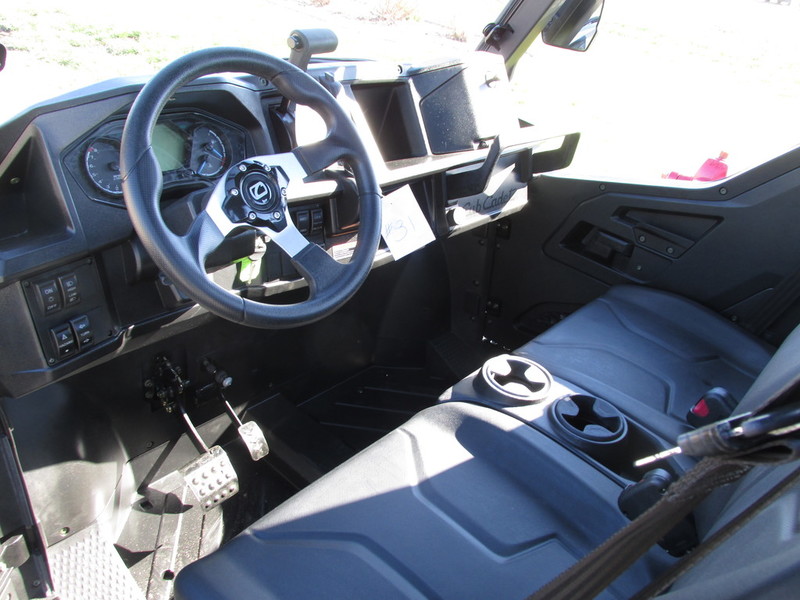

Not sure what the long Jeep thread above had to do with Kubota Utv sound. ....I have Kubota XC1100 RTV and now that I am plowing with it this winter ( so windows closed) I did find the cab a bit too noisy so I bought 20 bucks worth of Rubber backed exterior matting with the nylon grey carpet typical on it. I then made cardboard templates for any flat areas eg low on the steel doors and on the steel footrests on both sides I also saw that with box in up position there was a 10 inch by 50 inch part of exterior steel cab that I could contact cement some more of that carpet. So far I have applied roughly 10 sq ft and it seems to have reduced sound somewhat. Next I am going to figure out a way to do under the seats maybe under tooltray where I think a fair bit of sound of engine comes thru the engine access holes. But I need to figure a way to make my rubber backed type carpet removable here. I will let Original poster know how it works out. I love my cabbed Kubota Rtv ...just needs some custom fun work.

Would like to see pics of that work

Kman ...I took a pic with my phone and tried posting it here with the phone but I dont see any paper clip icon to use to attach it....so I will have to figure out a way to use a computer instead ( or see why my phone app does not show properly) give me a day or two.

Kman so you can see I put small push pins in areas I contact cemented the carpet mat for sound absorbing (so two places on the doors, both front floor wheel well curves, all along under back window outside cab and also under the barcode sticker on that same pic.)...?.I still have to figure out under the seat ...I suspect you know how awkward shaped that area is and I have my portable winch power cord also coming thru there.

Thanks for the pics look like it took alot of planning to come up with those ideas. My machine is totally different but I do get the idea. Thanks
