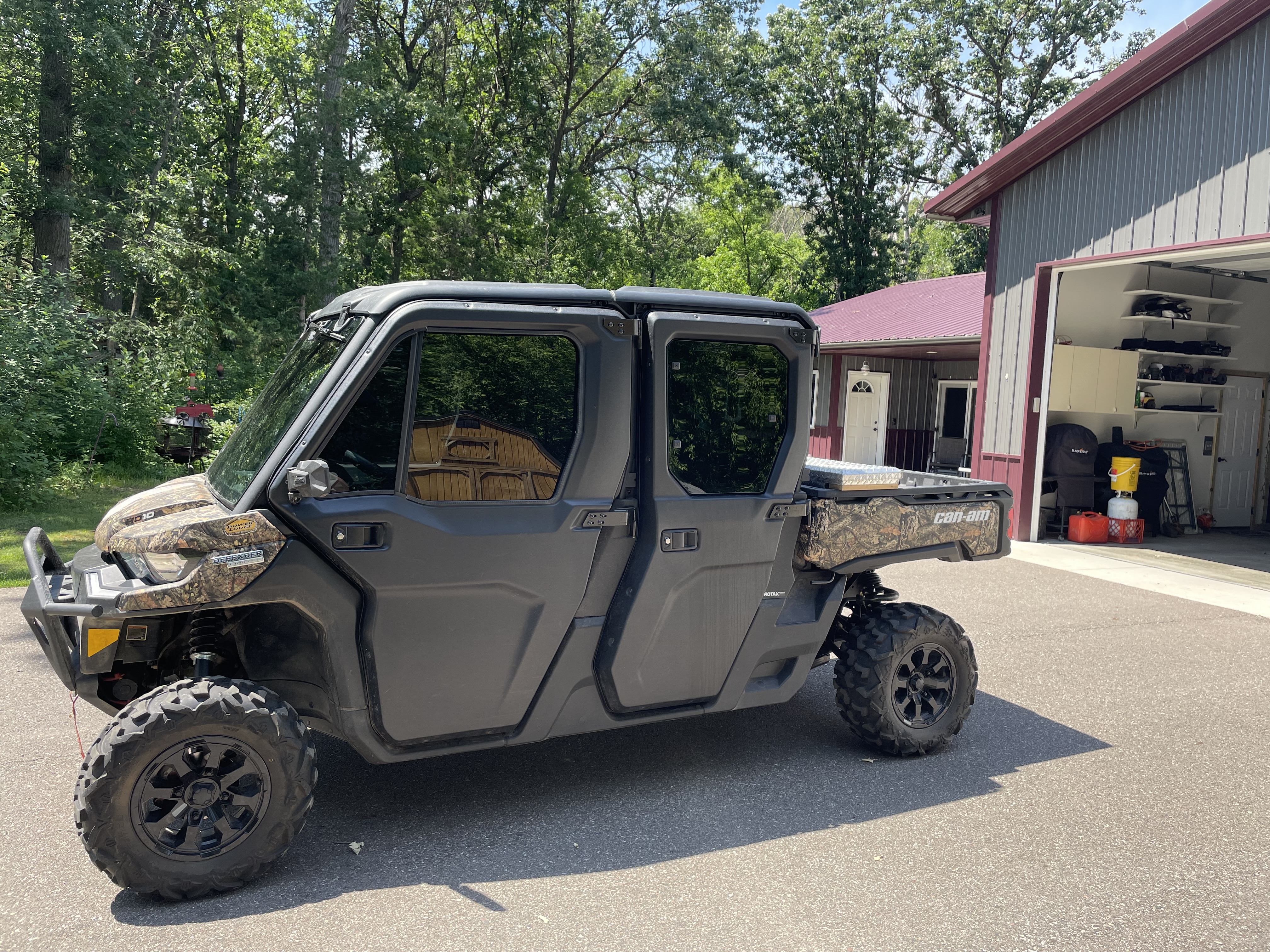

Rear overbed cargo rack just about doubles useable cargo bed space

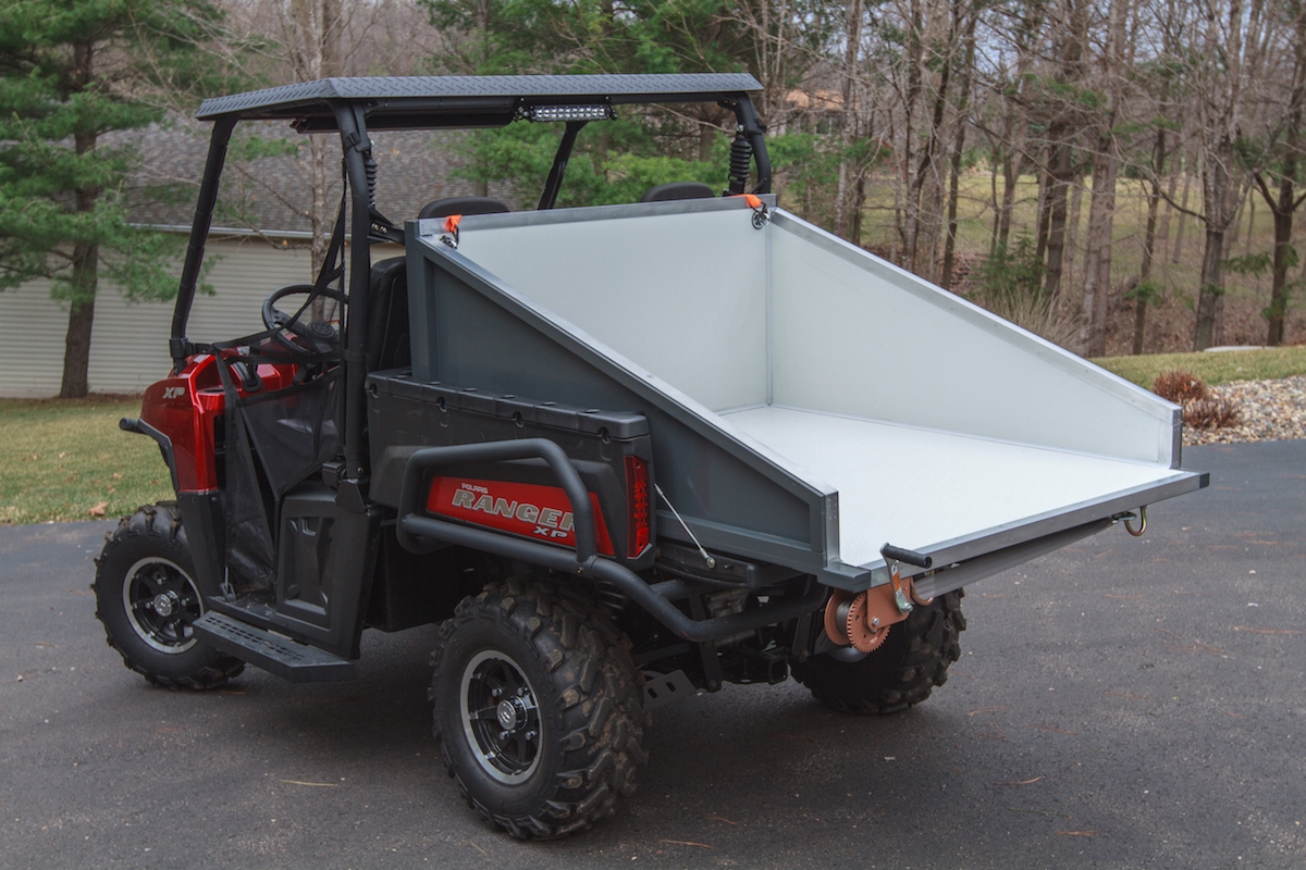

I made a brush sled/insert for the dump box on my Polaris Ranger for when I haul logs and branches back to the burn pile. It has a boat winch on it so I can secure the load (helpful when going up a hill - DAMHIKT). I made it out of baltic birch plywood and covered it with FRP and aluminum angle.

I also added a diamond plate roof I can stand on when trimming tree branches and a couple light bars for forward and reverse.
In the winter I switch to plowing mode with my Boss plow. The brush sled comes out and I fill the bed with 500 lbs. of concrete blocks and cover it with a cargo cover. That helps immensely when backing up my driveway hill (I plow going downhill).
