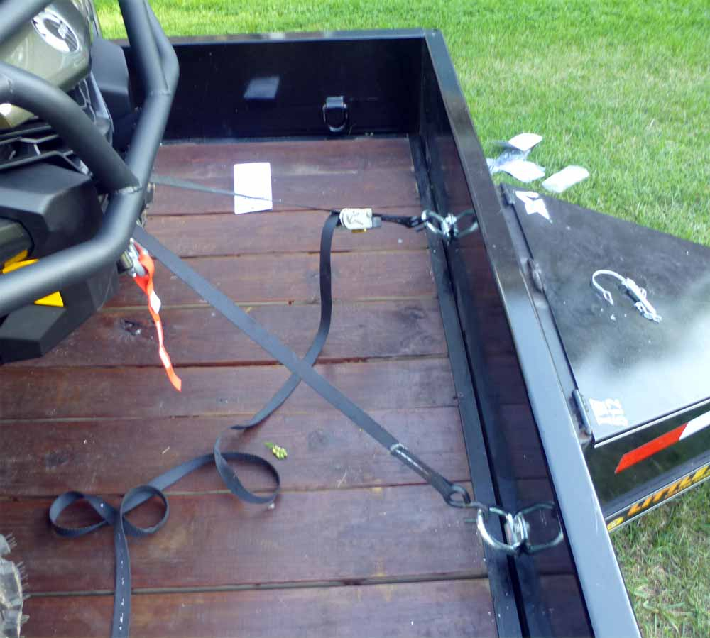

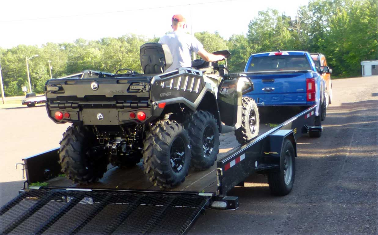

No trailer is perfect... No matter what you have, 6 months later you wish you had this,,, or you got some feature you never use. On our new doo-little we do like its accessoire box.
On this trailer, it needed better positions for its D-rings to tie this machine down. I added them this fall.
