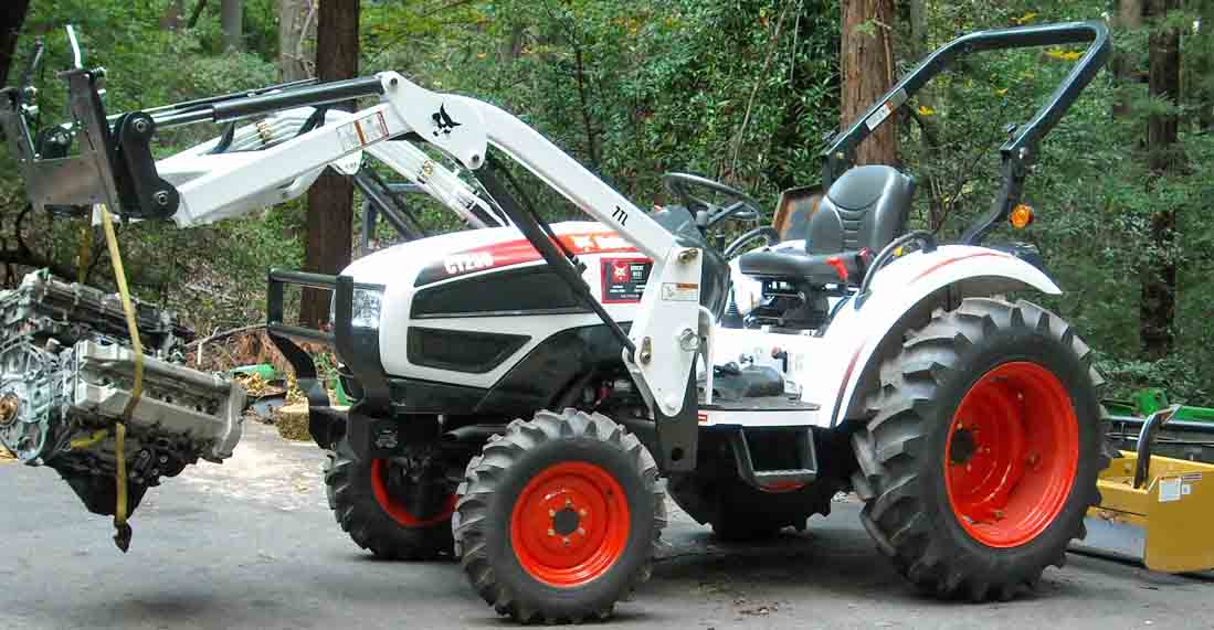

Nothing wrong with using the loader as the lifting point, but you really should use a lifting tool like a comalong or chain-hoist.
You risk doing damage trying to control the lift with tractors hydraulics, that's Caveman style, they don't even do that at the junkyards if they are trying to salvage the engine or tranny.
You could make the loader safe with cylinder blocking/locking.
I would use my bucket buddy for the lifts attachment point :)
JB.

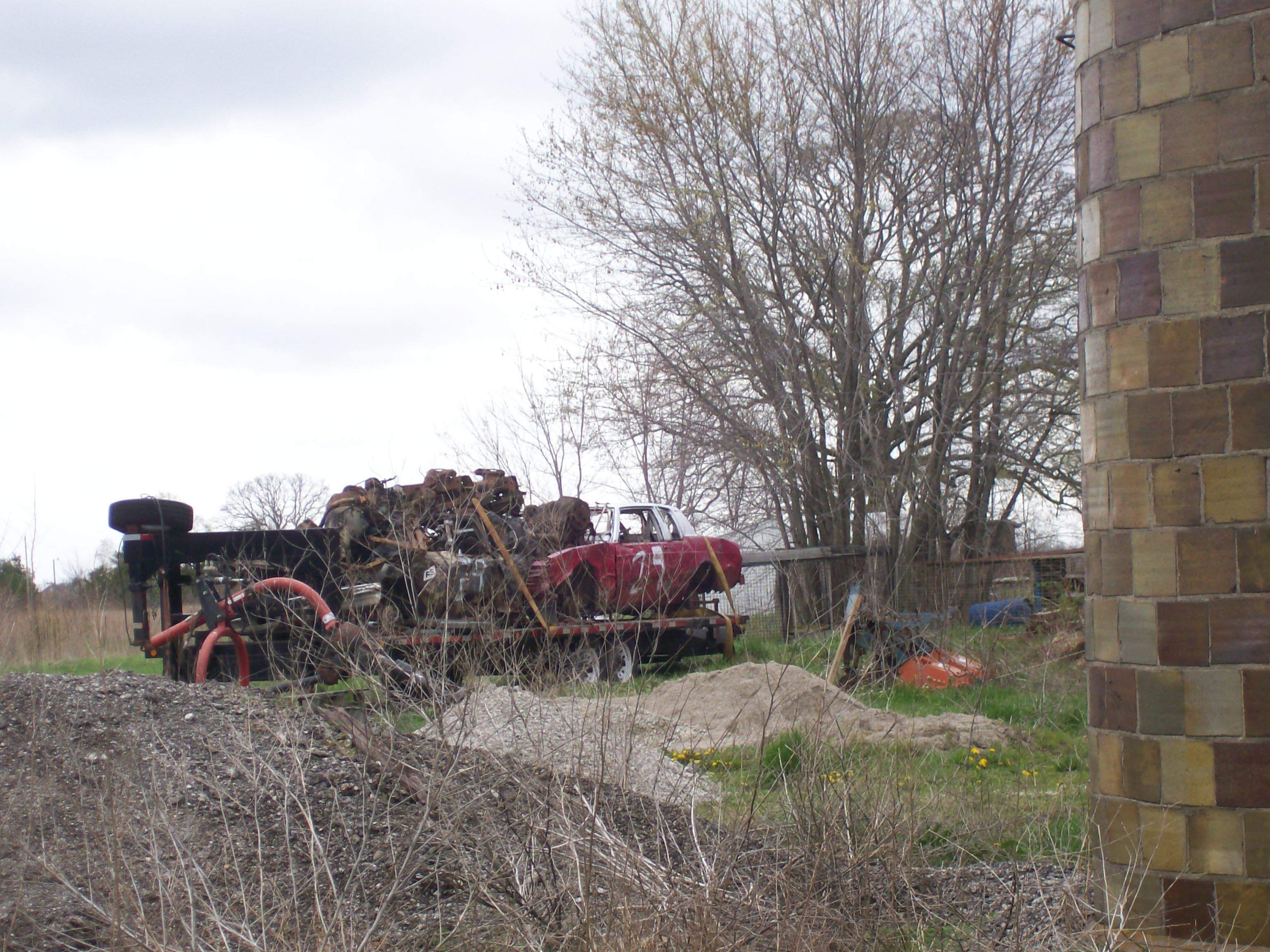

I would hate to gues how many I have done with a loader or backhoe, and good or bad I have rarely done it in shop usually in driveway heres a few photo's of the fun. On the trailer I have about 10 engines that I pulled with a tractor.

OMG! That beautiful plastic bucket could have gotten crumpled if the chain had exploded. (Chain must have been made in the U.S.A.). All those guys standing around could have tripped over each other and fallen into the running tractor's fan blades. And where was the E.M.S and fire trucks stationed when all this was going on? Shame on you. Good thing that this is America and that creative individuals unafraid of challenges are still in existence. A wildcat picket line should surely have been set up for unsafe practices performed here. Where was the Safety Committeeman when all this was going on? It took 4 days to get this done I assume. You can probably tell I've worked with skilled labor such as yourself a lot. The official Violation Report on this is going to take weeks to investigate.
Be sure to wax your tractor afterwards...
BTW: 3 MEN could have picked that motor up by hand and tossed it into the pickup. Next time use the tractor to pick the whole mess up, set it into the truck bed, and then use your Jaws of Life to cut the car out away from the engine.
Good Grief ! Lord have mercy on us dummies.
