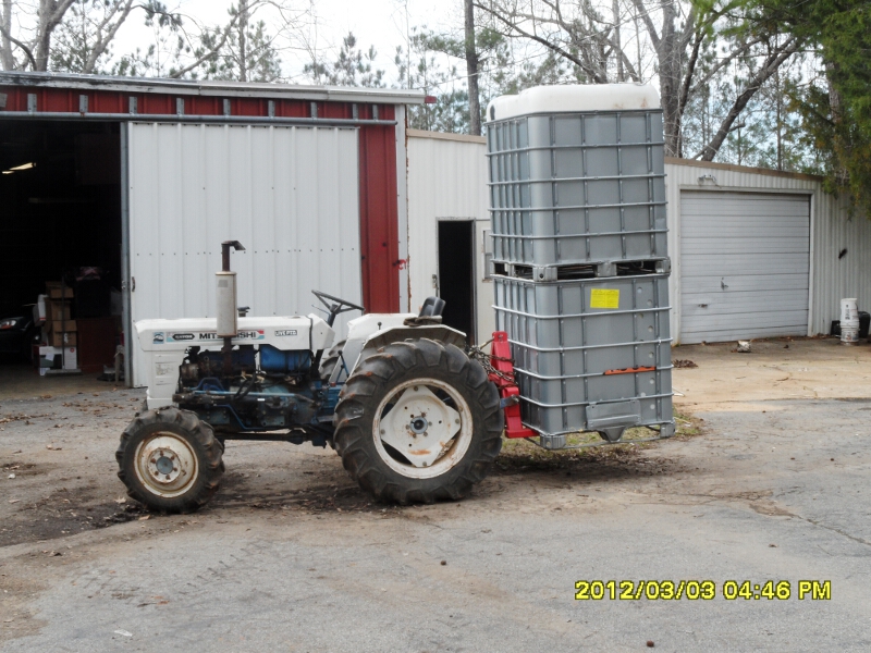

Before we can get energized to reply we need PICS!!
I'm interested because I just gave my cousin-in-law, Dr. Johnson, one of the totes given to me by Taylortractornut.
He just puts it in the back of his truck and after filling it drives it up to his watermelon patch.
