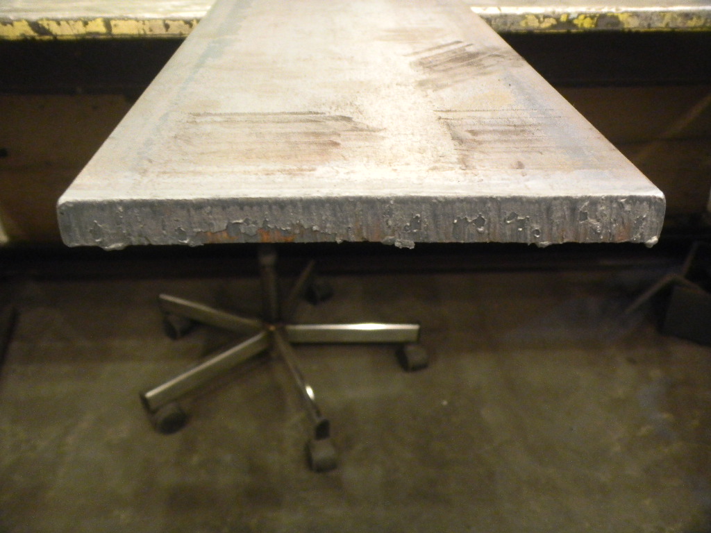

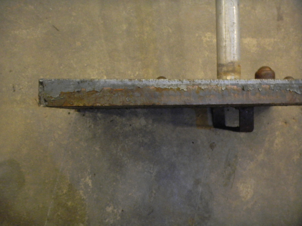

I switched to propane a few years ago. I don't see a whole lot of difference between cutting with acetylene and propane. Like already stated it does take a little longer to preheat. But is does make some nice cuts.
Here is a good video on using propane.
Propane & Oxygen Torch Cutting Instructional Video - YouTube

In the pic's you made, I noticed the cuts look smooth and hardly any slag. Is that typical with propane?
