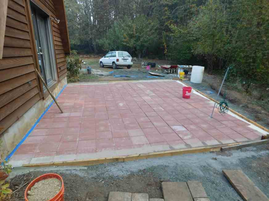

/ Using old Cement-all.
#9
Thank you all for the professional suggestions as to the "correct way" of setting down pavers.
I am aware of, and have completed several like projects the "correct way," which as you all have pointed out, means, dig down, level, add a base, compact, add a layer of sand, level, then lay pavers, and then use sand, granite fines, or poly-sand to set the pavers then nailing in a retention border.
I absolutely agree with everyone that, this is the standard, and correct, way of doing things.
However, in the other smaller paver patios I've put in, I've been disappointed with the long term, as in several years later, results, using this correct way.
I have soil that is very "plastic." In the sense, that it shrinks and swells, like a sponge, between dry summers and very wet winters and the occasional, week long, below zero, deep freeze. One of the joys of living in the country, is the DIY freedom. I personally like doing experiments, even if they are failures, at least I tied something different than the normal, that might be a better solution.
One solution that I found, and it has stood the test of time, is to excavate, then 3 ½, ¾ minus, compact, then 1 inch of sharp sand, un-compacted, then a layer of precast 12 inch square, 1 ½ thick pavers with ¼ inch grout spacing. These pavers are typically 88 cents each when they are on sale and 50 cents when available at the local second hand, building materials store. Then, I flood the entire area with a slurry of cement-all and trowel the slurry in to all the joints and smooth it all out. I let this slowly dry. Once its hard, then I'll skim coat the base with mortar and set what ever final dress stone I want. I've done this with both Quality Slate and with Flag Stone, then grout and clean/wash with Muriatic Acid . These pads have stood up the test of time with no cracks and heaving, or loose, dress cover, and zero plants taking hold in the seams after seven years.
Water is also properly directed away from the foundation.
So I'm doing the same thing here, just on a much larger scale and the final dress is going to be a random pattern dressing of pre-made concrete, 2 ½ inch thick pavers.
One might ask, why not just do a poured pad with rebar, and I will say.... I really, really, really, hate working with bagged concrete mix.
We are also attempting to create a space that looks like it is ancient. So, artistically, perfection isn't the goal. The below pic looks like I've made a valley,.... this is a lens effect. :)

We are also attempting to create a space that looks like it is ancient. So, artistically, perfection isn't the goal. The below pic looks like I've made a valley,.... this is a lens effect. :)View attachment 768604
Patio looks like a nice spot to relax, that will hold up just fine. But I mainly just wanted to say, that Festiva is amazing. Not even rusty?

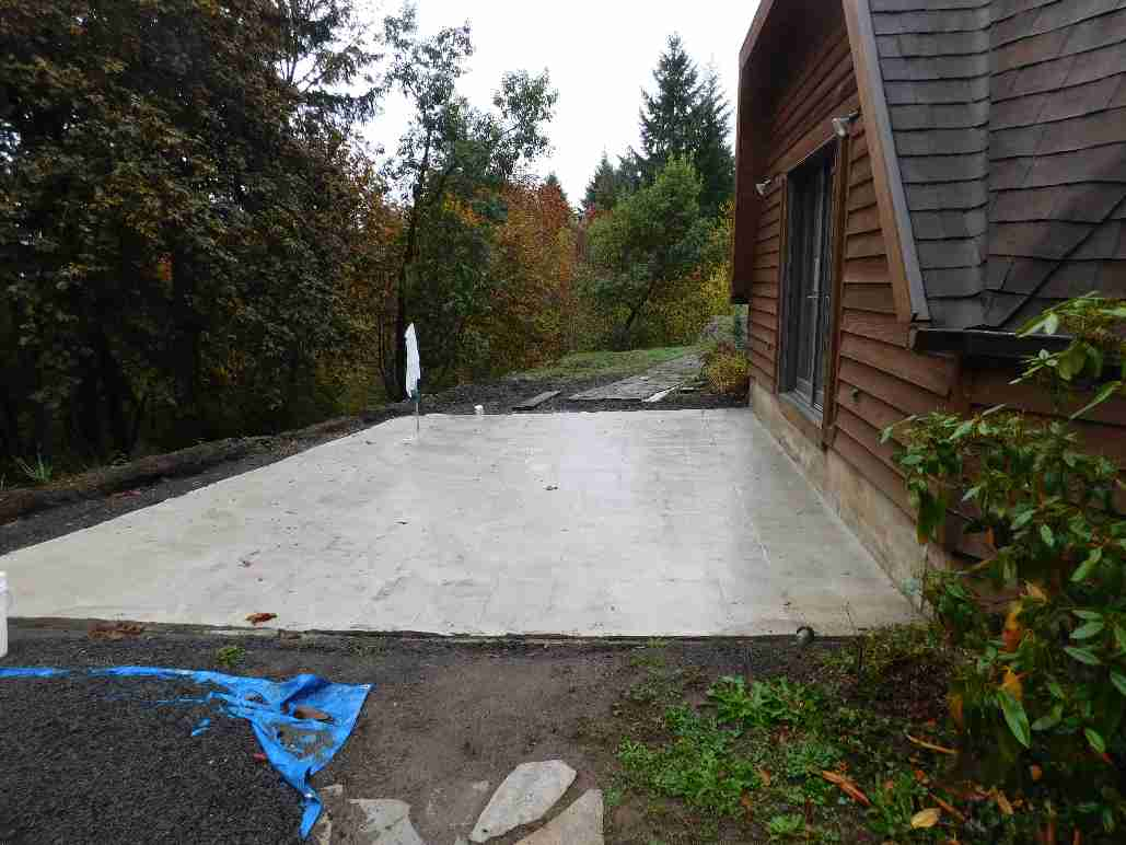

#14
This is the finished base that I'll be buttering the pavers to. On post #9 you can see how I used the older cement-all, as retention backfill. The clumps didn't matter with that use. :)
