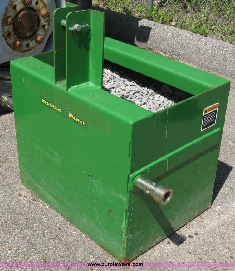

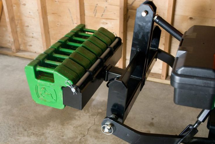

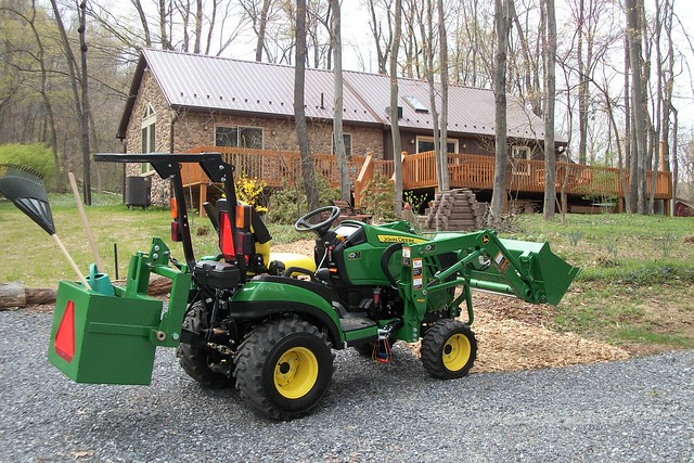

If you are looking at using ballast weight on the backend, first and foremost, look at all of the John Deere Compact 50 Series rear ballast options. Then build those types to your YM2310. A JD750 and JD850 are the 2 closest matches to your machine for size, weight and much of the 3PT lift areas.
As for doing something with the ROPs. I can't advise doing so.
So, why would someone want rear ballast? 1,000 words say why. LOL

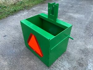

Or make your own Deere ballast box for the 3PT.
And when the ballast box isn't used, it has a 2nd feature as a CARRY-ALL box. ;)

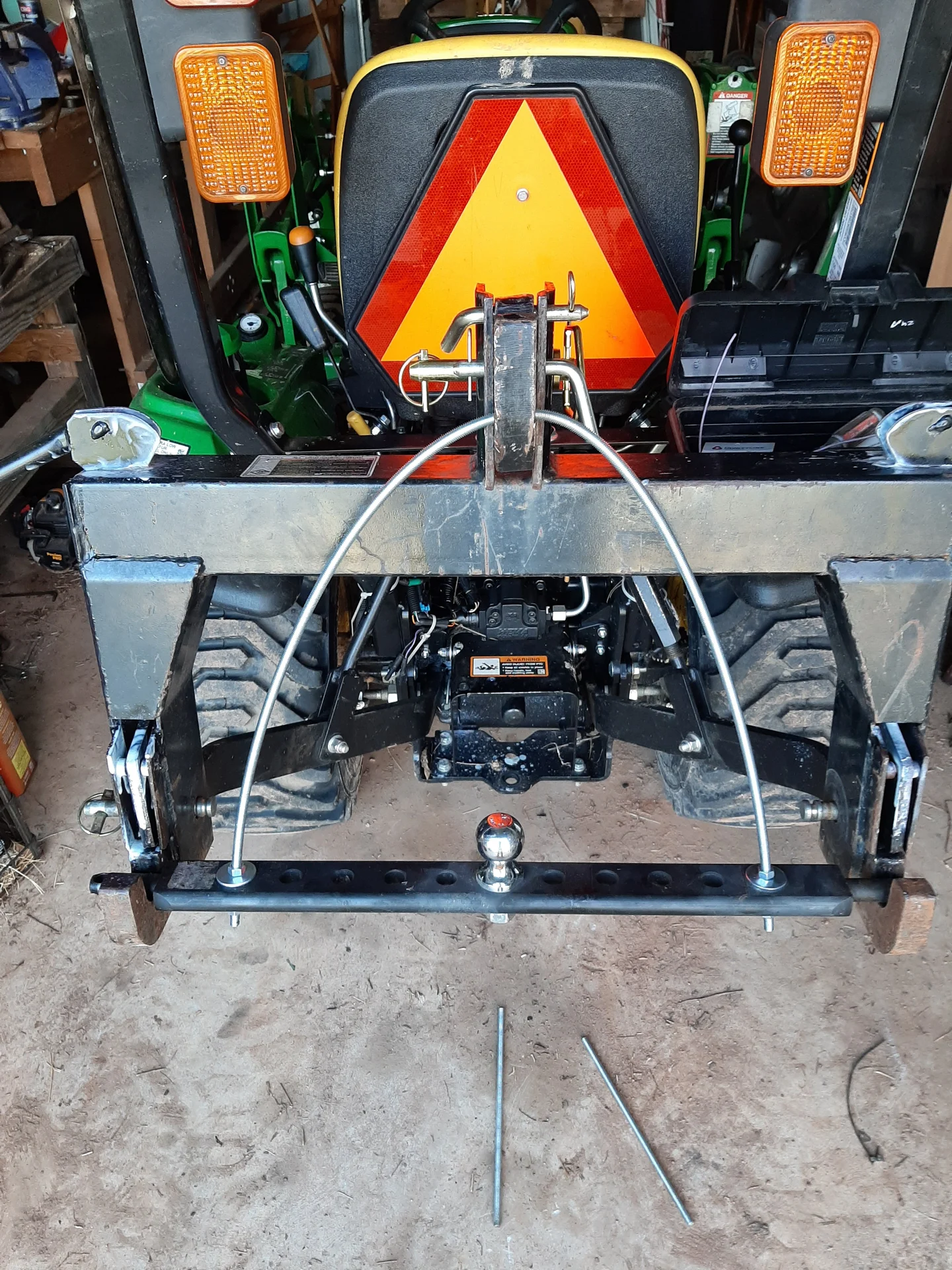

I have bolt-on cast weights on each rear wheel of the smaller YM186D. Here's something I devised when I needed more ballast while maneuvering in a very tight space between the barn and fence. I didn't think to install the cross-bar with hitch ball before chaining on the wheel weights, but I do that now and it moves the weight back a little.
Quick Hitch 65 lbs
Crossbar 25 lbs
Wheel weights - I have four, at 77 lbs each.
kimg0243rqh-ballast-jpg.390836

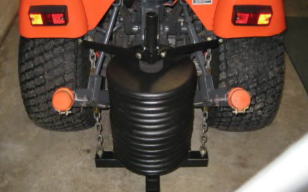

Here's a similar arrangement using weights salvaged off of exercise equipment and resting on the drawbar, that I used for a while to improve traction pulling my 2600 lb watering trailer uphill.
img_20170707_105814rballastreartinas-jpg.514621
But we're trying to steer you to weight you can simply drop and abandon, similar to an implement, rather than semi-permanently mounted.

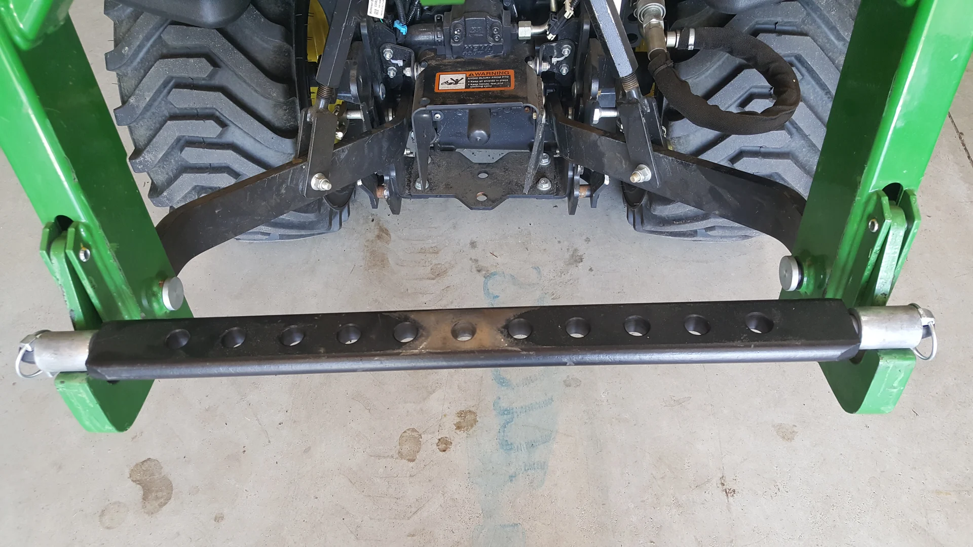

Maverick your first photo with the chrome trailer ball, has a loop to solve the problem of the ball rolling over upside down just as you back up to a trailer. Here's my similar solution. Cat1/2 sleeves with a flat bar welded to them, then the sleeve/bar assemblies bolted to ends of the crossbar. I've used this for several years. I thought the flat pieces might bend, but they haven't. This works well.
kimg1766rqh-toplinkpins-jpg.475243

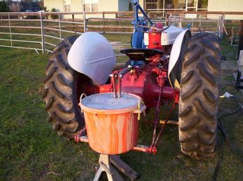

In the last photo he will likely need to park the bucket of cement on something. Because the 3-point arms may not go low enough to connect, if he leaves the cement bucket on the ground. I see he has a jackstand under there to hold it up when he parks. A better design is a steel bar punched side to side through the bucket a foot off the ground, at a height where the 3-point arms can match up, before pouring the concrete. Stepping up in elegance, add a trailer hitch and some holes in the concrete to carry a shovel etc upright, before the pour.

Yes but ... there has to be some reason he parked that bucket on a jackstand.
/ Using drawbar to support ballast on 2310? #18
It was to ensure the liquid concrete was hardening and not to dump out.
