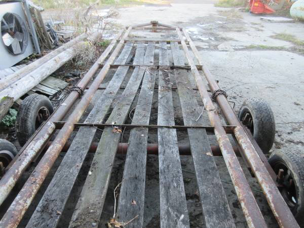

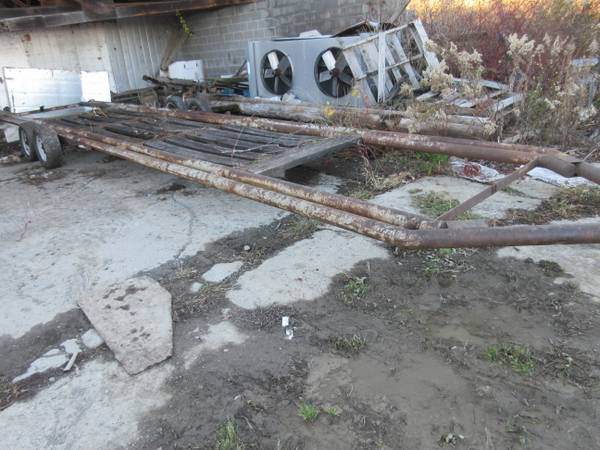

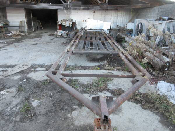

Need some opinions from you guys regarding using this trailer as a bridge across a creek. I need about a 30' long bridge to use as a crossing for atv's, utv' my tractor (3500#) and if able my mini ex (8000#). The trailer is 37' long by 7'6" wide and is made out of 5" heavy walled pipe. I will make concrete abutments on either side and if necessary, put support posts underneath. I have considered utility poles, cutting down some of my own trees. I have an architect friend who speced out using my own red oaks and for a 10,000# load he said I would need 4 12" trees. I saw this trailer for sale and was thinking how easy it would be to just drag it across, set it and then deck it with wood. Can't seem to calculate the weight it would hold. What do you guys think?

I don’t think that Trailer would be a good candidate. The pipe would be very low on my list for structural strength in that type of application
Brett
/ Using a trailer for a creek crossing????? #3
I’d pass on that trailer. A junked semi flatbed would be a lot more in line.
/ Using a trailer for a creek crossing????? #4
My exact feelings also Brett. When building a bridge - I would use three of my big Ponderosa pines long before pipe. Pipe simply has too much flex. I have an area where water flows out of my five acre lake into my 120 acre lake - "the moat". I have, over many years, gathered stone of all sizes and built a crossing area - 30 feet wide by 140 feet across - in the moat. The moat is essentially - 80 to 100 feet across and 475 feet long. Right now - the wettest time of the year - there is 18" of water over the stones in the crossing area. Its no problem to get across - just go slow. Other times of the year the moat is completely dry and the stone crossing area is 20" to 24" higher than the rest of the ground. The stone crossing "bridge" keeps you above deeper waters AND provides a firm grounding. The ground is super soft in the moat right now and any attempted crossing - other than at the stone bridge - your tractor will immediately be high centered in water saturated slimy mud plus the total depth of the water at any crossing point. I've had experiences.

I agree but had to ask. You know how your mind wanders and an idea sounds great to yourself until someone else points out its deficiencies. Thanks. I will go back to the original plan and use logs.

Steel I beams decked with 2x6's on edge oiled and or tarred will work good and last many years,
that said a used over the road trailer would make a very good base unit to put a good deck on
and a great many of them are built as a prestressed truss which will be quite strong.

I would think that pipe trailer would work just fine with a sturdy deck and a support in the middle. A 30 foot span is nothing if supported well.
A tube is not an efficient beam member.
OP did not list strength or thickness of members, and quality of welds in not known
There are many unknowns with using homemade trailer as bridge
