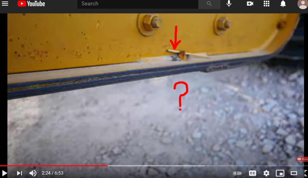

Good video, but what is the story on the pencil?

Agreed - strange place to store a pencil if you plan on taking notes.

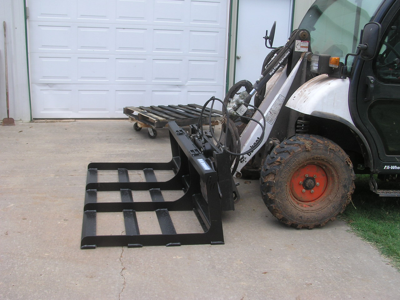

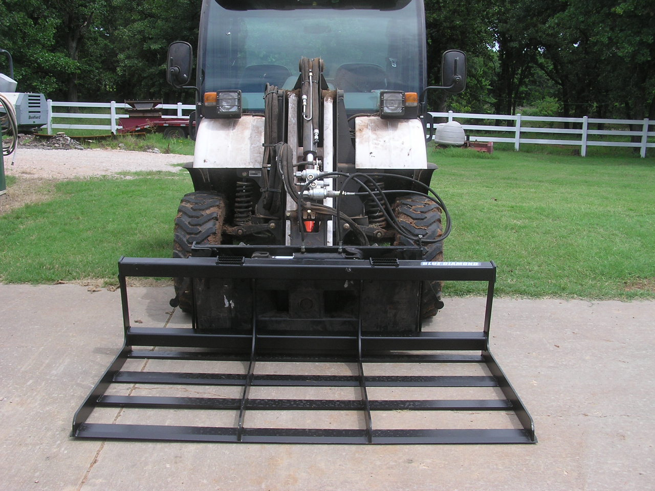

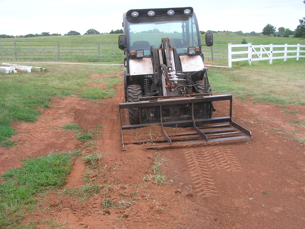

Has anyone used land plane of any design, to regrade poorly graded lawn? Not the roads. Grass mounds.-------------------------------
I can't see how a Land Plane would smooth sod? I'm afraid you'll end up with a mess. -----------------------
My skid steer style land plane will do sod, dirt or gravel:
