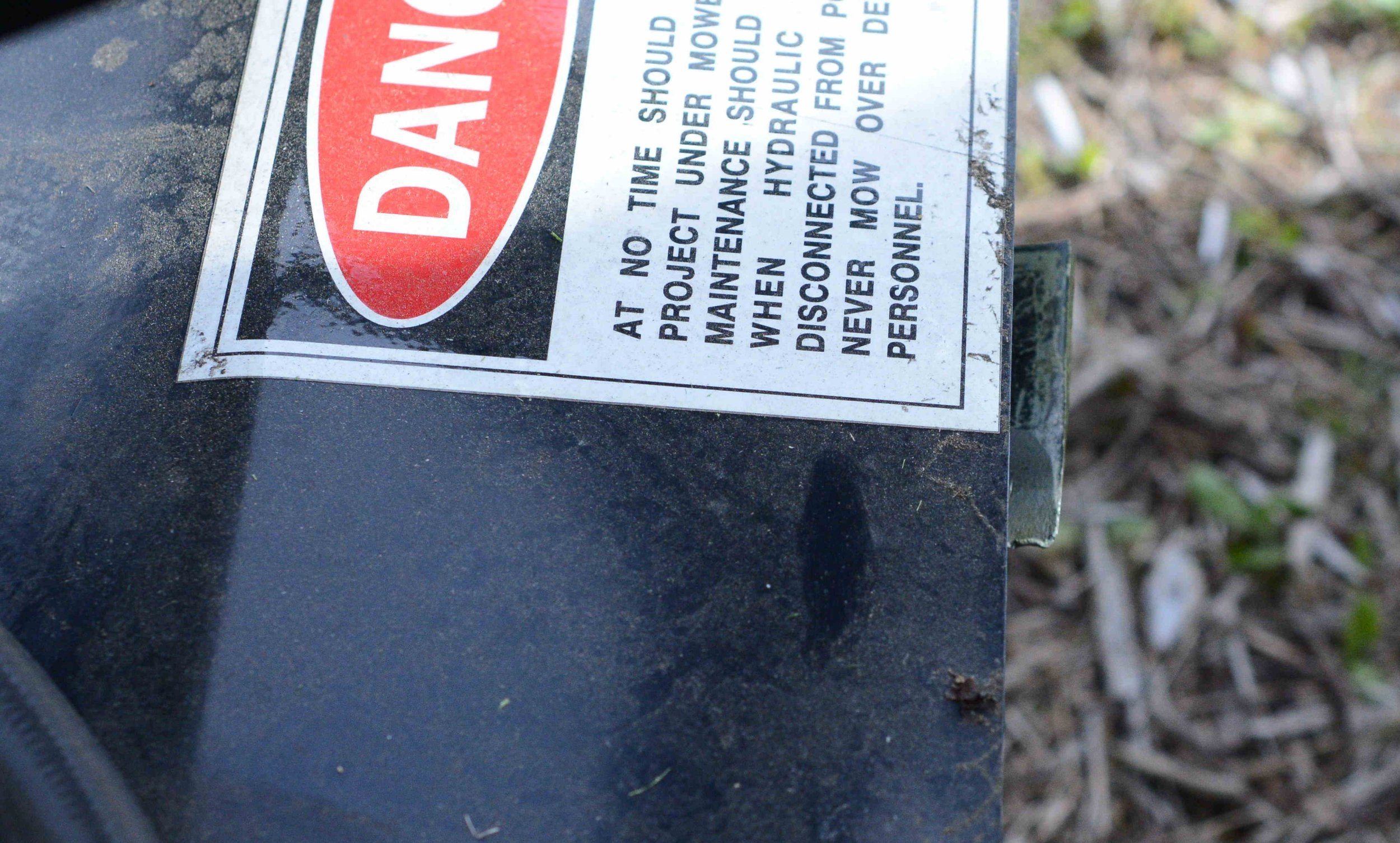

I may be wrong and others can chime in, but on my PT cutting decks (3), the blades do not extend beyond the deck/cover. This tells me you have the wrong blades. The noise may be the blades hitting your deck.
If your picture reposted below is just an illusion and the blades dont stick out, check your center hub for lateral and axial run out. All that heavy use may have bent something or something could be coming loose.
I WOULDN'T USE IT UNTIL YOU FIGURE OUT THE PROBLEM. Blades have been know to come loose and fly out.

The blades are near the deck housing, but don't extend past it. The angle of that photo makes it look like the tip extends past the housing. Nonetheless, the blades come very to the edge of the deck housing.
I think there is some wobble going on and it has to do with the blade bolts or bushings if it uses bushings. The free play that has developed seems to be allowing the blades to hit something when spinning. Surely some idiot didn't install the wrong blades at the factory?
The use is just typical field mowing, but this deck is lower to the ground at its maximum height settings than my other cutters. I have hit some rocks.
That's basically where my 1445 blades are. They come right to rear edge of the deck. When I first bought the machine, I did consider putting a chain guard spaced out a little, but in the end, I realized that debris doesn't come up and out directly. I still wear a chainsaw helmet, just in case of ricocheting debris, having seen how far the brush mower can hit chunks.
