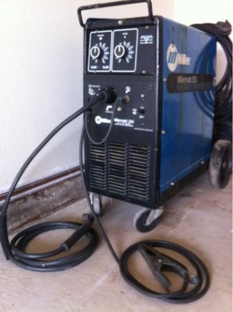

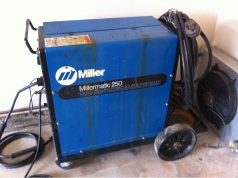

I'm thinking about pulling the trigger on a used Millermatic 250. Are there any particular concerns with these units? What should I look at when I go to check it out? I've attached a couple of pictures (click to enlarge); I'm a little bit concerned about what appears to be rust, but but it looks more like something else dripped on the unit than anything else. Thoughts?
Thanks in advance!

If it was me, I would want to take the cover off and look inside, I would be more concerned about what ever spilled on the case than anything else.. If all looked well inside.. and the price is right, and it welds right give it a go. Look for any signs of corrosion, any white or green powders and or rust on components . If I saw any at all I would reject it.

Other than the two stains, it looks really good. I have one just like it. Check that the contactor sounds strong and doesn't chatter, gas solenoid works properly and the wire feed runs smooth at all speeds. They are a fine machine.
