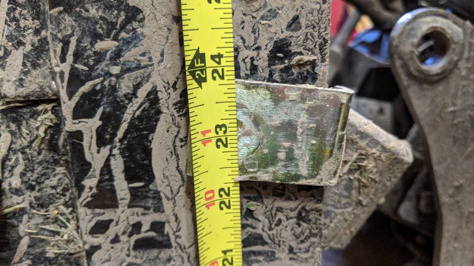

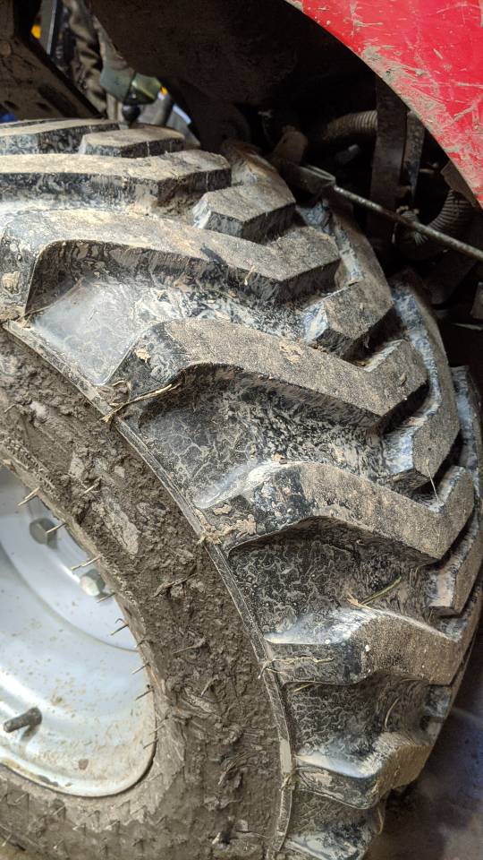

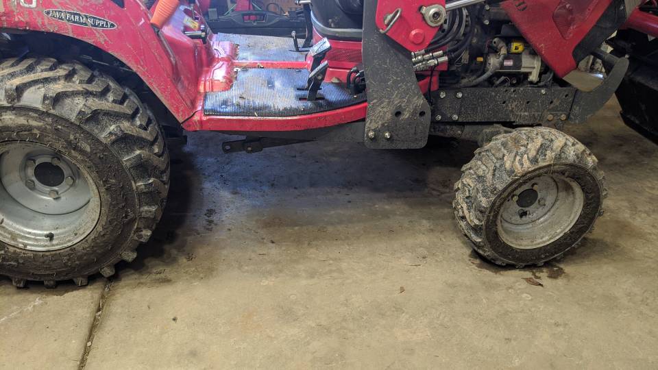

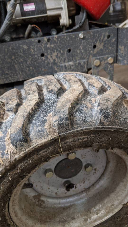

I have 347hrs on this machine, tires are original and always kept to ideal inflation. Looking at the pictures on the listing you shared my guess is they saw a lot of time on pavement/hard surfaces which tear these tires up pretty quickly. I spend my time in lawn and dirt/mud(obviously as my machine needs a bath)
Also, the center of the rear pin fully raised is 23" with a standard cat 1 quick hitch attached would would have the same spacing for you and your cat 1 implements when attached.
1 item of note:. That GC1715 has a DL100 loader. Things like a SSQA and alternative front attachments are harder to come by for that loader. 2015 saw MF switch from DL100 to DL95, the DL95 has a yield of about 30% more lifting capacity than it predicesor the DL100. The DL100 would still be in line with kubota's usual lifting capacity for this size machine.IMG_20200315_121815.jpgIMG_20200315_121822.jpgIMG_20200315_121830.jpgIMG_20200315_121844.jpg

Thanks for posting the pics, sounds like my aerator will be ok then. I'm with you, all grass, mud and gravel, no pavement here!
