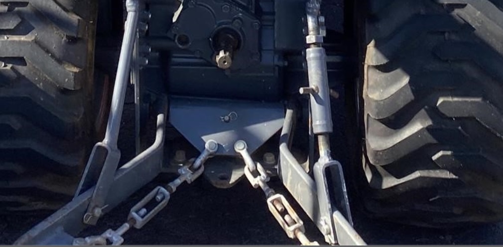

Will I miss the position control on my old tractor? My old rear mower has rollers up front, only two wheels in the back, so I set the position where the rollers are just touching the grass -- seems to reduce wear and prevent scalping better that way -- can the equivalent be easily set on the GC1715 or would it need check chains?

I'll start at the end. Yes, if you require positional 3pt control you'll need check chains for every subcompact except a JD1025 as far as I know.

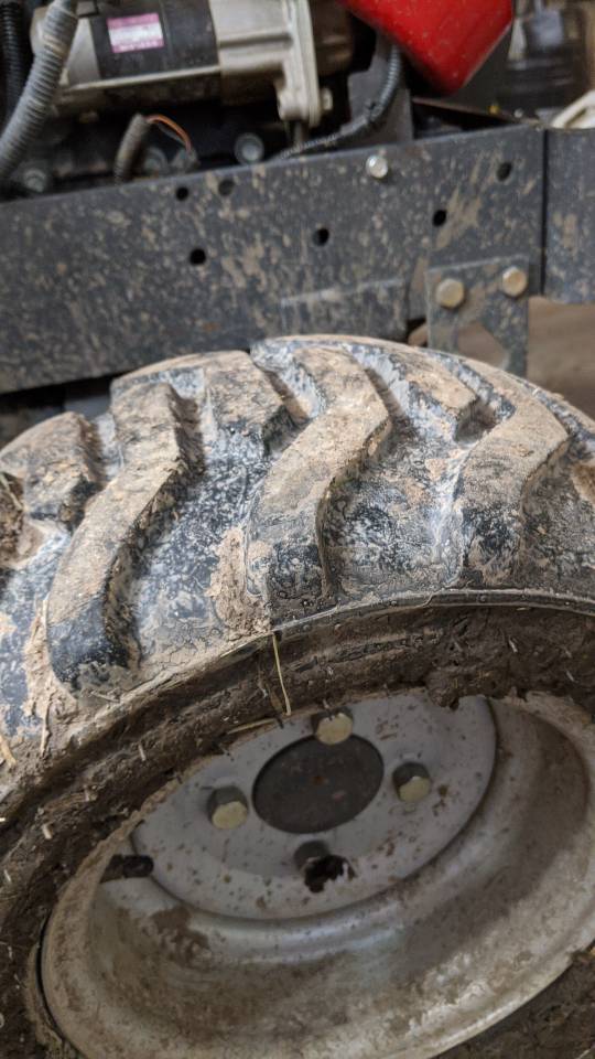

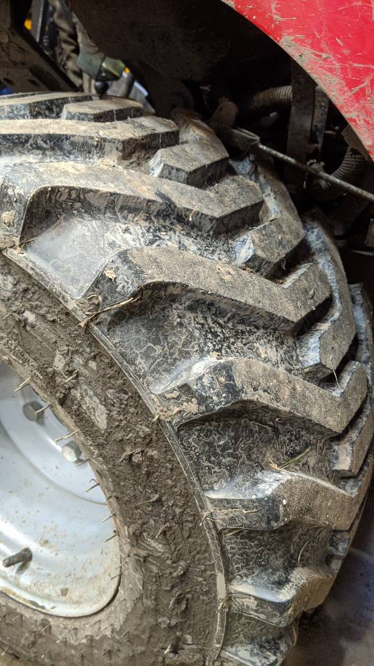

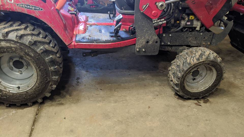

So the used GC1715 seems to be in decent shape, everything I could think to try during the test drive worked comfortably well. Seems like a good machine. It would need some service (oil change, air filter, battery, radiator cap), but nothing major. The only thing I did not understand was that the front tires (industrial) were more worn on the outside edges, does that commonly happen? Not a lot, but enough to notice.
The hitch can be lowered to a position fairly accurately and then stays there, I would try that first with my mower before going to check chains.

That's normal for fronts to wear quicker that rears. They rotate far more often than the rears do given size disparity and stress/pitch when turning. 200 hours is very young on a diesel motor. With good care you should see 4000+ hours easily. As for the price new vs used... That's all about personal preference and how handy you are. I fix most anything and don't value the warranty as much as someone who doesn't have the tools or know-how might. Good luck on your decision.

That's normal for fronts to wear quicker that rears. .
I was commenting about uneven wear just on the front tires -- the outside edge was more worn than the inside edge on both front tires. If my car tires did that, I would get an alignment.

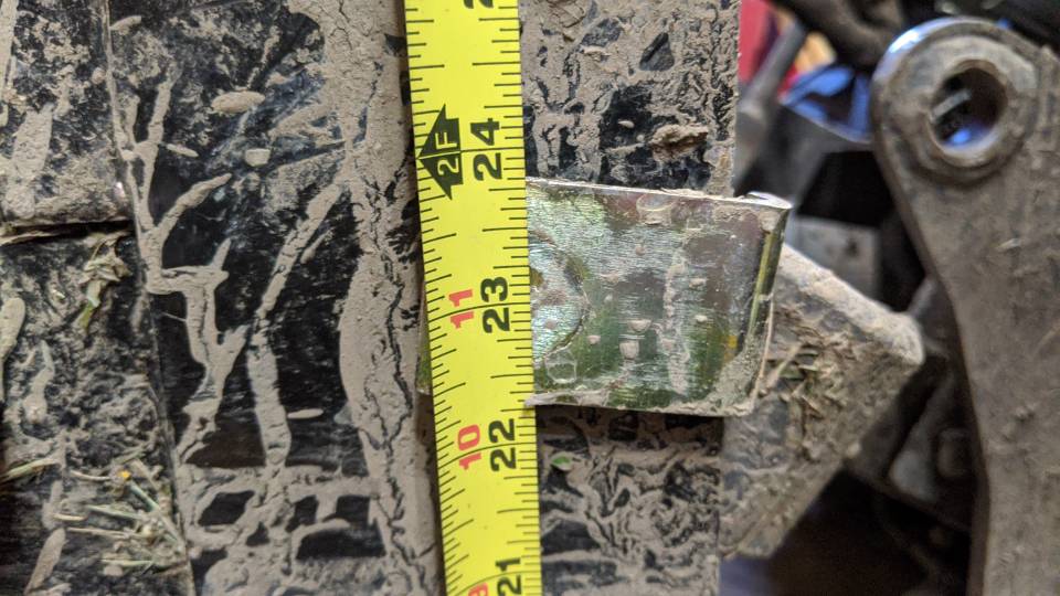

One more question: does the Cat I 3-pt hitch have any limitations I need to be aware of?
My rear mower and blade both have side pins that are 32" apart. No issue there I would hope with spreading the side arms.
What I'm wondering about is my 4' aerator. Sitting on its stands, the side pins are 18" off the ground. Does the 3715 hitch have enough lift height to get it off the ground? I checked the height of the hitch against the length of my arm, just did the same with the aerator, I'd estimate there was maybe 1-2" difference.
