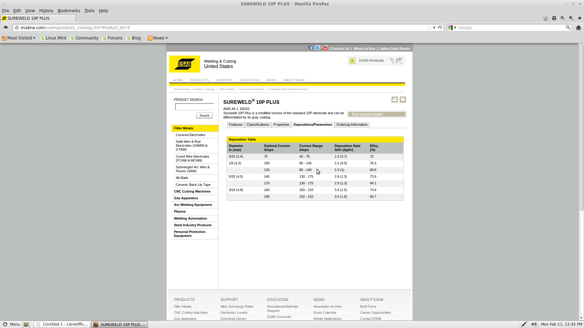

I would say any of the 6010 rods Furu listed. Radnor, ESAB's 10P, 10P-Plus, Lincoln 5P-Plus.
Does it make any sense to you that his Stickweld 250 ran the 10P-Plus at 125-amps, where the same results with my V350-Pro was at 80-amps?:confused3: Even though 125-amps is well with in ESAB's parameters.
Im not sure. We do not have the V350-Pro here to do a side by side, but that is something we can look into. Ill have to ask Scott or David to see why there may be differences in the machines and the settings.
