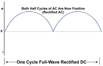

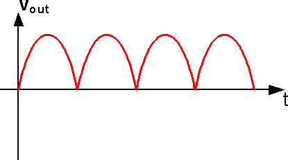

I will try to post some pics but had trouble on my 1st attempt.
Slow spin engine
Faster spin engine
Assume the volt scale (vertical axis) and the time scale (horizontal axis) is the same on these two graph pics. In short, the faster spin engine has more waves in a given time so more time that voltage is at peak verses being closer to zero. In this overly simplistic example the ratio is 2 waves to 1 wave in the same amount of time. Remember this is all happening in milliseconds of time so the effect is not easily noticeable in real time that a human can perceive, but nonetheless does make slight differences in performance as you have observed.

Slow spin engine
Faster spin engine
I don't think that's correct. I think they both spend the same amount of cummulative time above any X voltage
