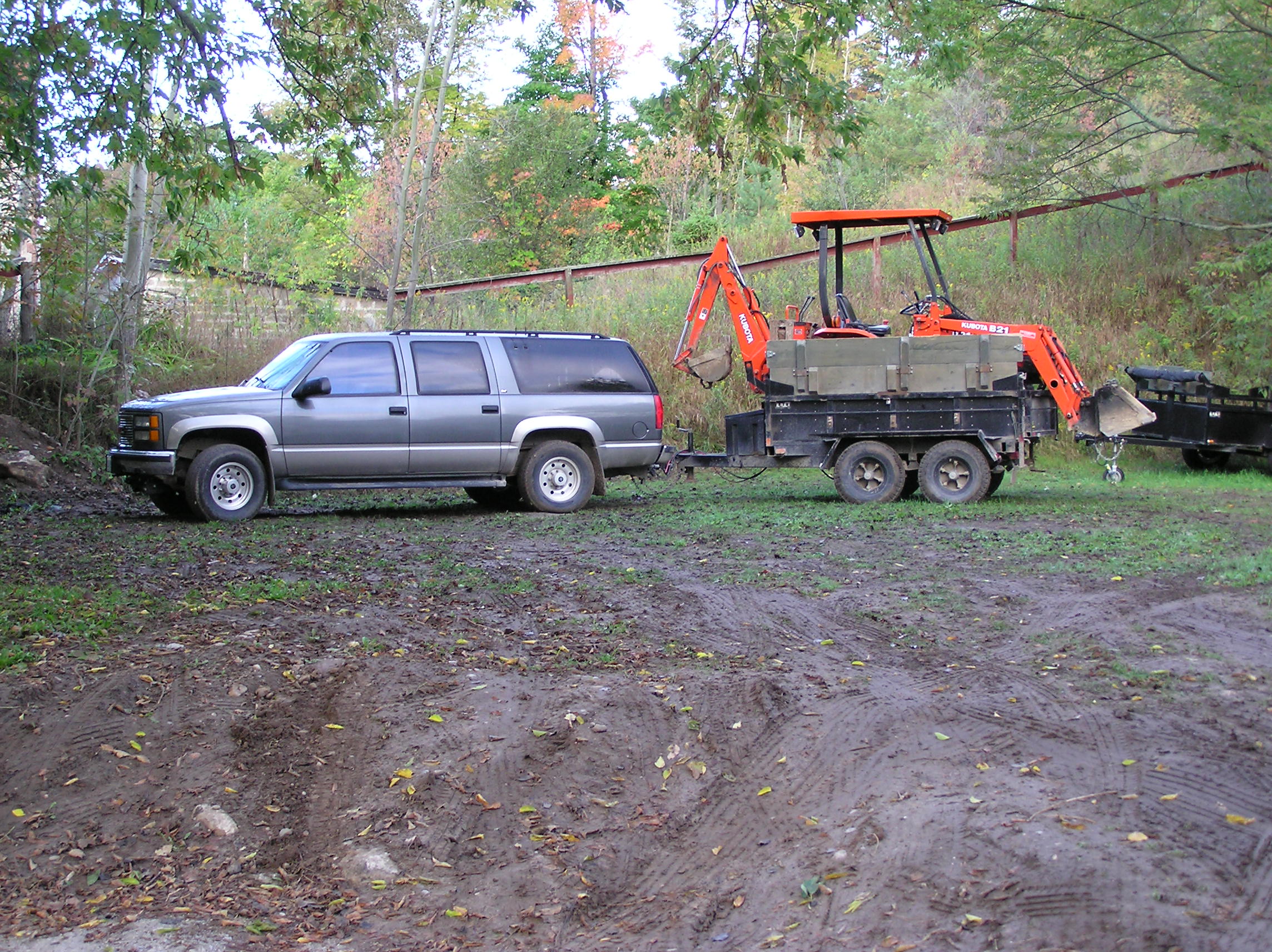

As pointed out by Reg and another poster the trailer fish tailing is a clear indication that you do not have enough weight on the tongue.
I used to have a 9' x 5' dumping trailer in which I could just shoe horn my B21. When I went to pick up the brand new B21 I wanted to back it in the trailer but the dealer insisted that I should drive it in. I foolishly followed his advice and tied the machine down. I got about 3 miles from the dealer and as I accelerated from 35 mph to 50 the trailer began to shake so violently I could barely keep my vehicle on the road. I had to grab the trailer brakes and get the rig stopped.
After cleaning my pants out, I had to unload the machine on the side of the road and then back it in and tie it down and I never had a problem again. I was towing with a 3/4 ton Suburban that weighed over 6000 pounds and my dumping trailer weighed in at about 4000 pounds plus about 4500 pounds for the B21.
From my subsequent reading I understand that in order to avoid trailer sway you need to have around 10-15% of the total trailer loaded weight on the tongue. Having experienced severe trailer sway once, I would rather have a little too much weight on the tongue than too little.
You really got a B21 in a 9x5 trailer??? :confused2:

The B21 did not fit comletely inside - as you can see in the attached photo it spilled over the front and back but I towed this rig as far as 250 miles from home to the in laws farm with no problems.
I traded the B21 for a B26 about 18 months ago and the owner who had to return the B26 returned it on a 16' float. The backhoe setup on the B26 is a little different and I never even tried to get it in the 5' x 9' dumper because I did not think I could get enough weight forward on the tongue. I used the float last year to move the B26 to side jobs but found that it was a bit of a pain to have to strap everything down (extra buckets, palletforks, fuel cans etc.). I also had a couple of situations where I had to drop the machine and then go get the dumper to remove material so last fall I traded the old dumper and the float for a brand new 7' x 14' dumping trailer with torsion axles. I still have the stick and backhoe bucket overhang the front of the trailer and can't close the rear doors with the pallet forks and the two front buckets but it tows well the couple of times I have moved the B26.
I forgot to mention in my last post that the other reason I like to back the tracktor on is you can flip the seat up and it will stay there when you drive down the road. This keeps the bugs from accumulating on the area where you sit but more importantly it keeps the seat dry in the rain and from that early morning due if you go out to unload first thing in the morning.
Wow! You really did squeeze that thing in there...:confused2:
