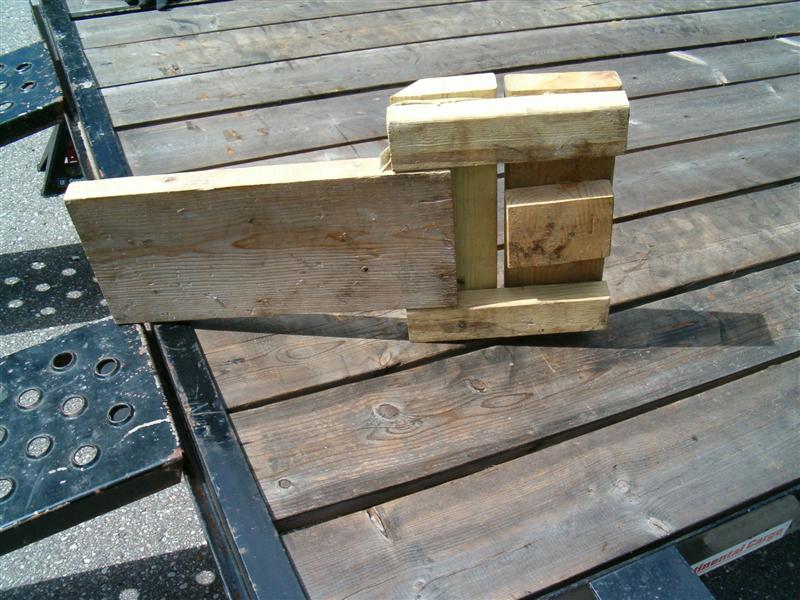

I am going to cut the 2X6's 18" and bolt to the top of the 2X 12 to widen that end and give a 3" lift. My ramps are 15" wide. If you have any follow ups to Rimshots suggestion or PIC's please send along.

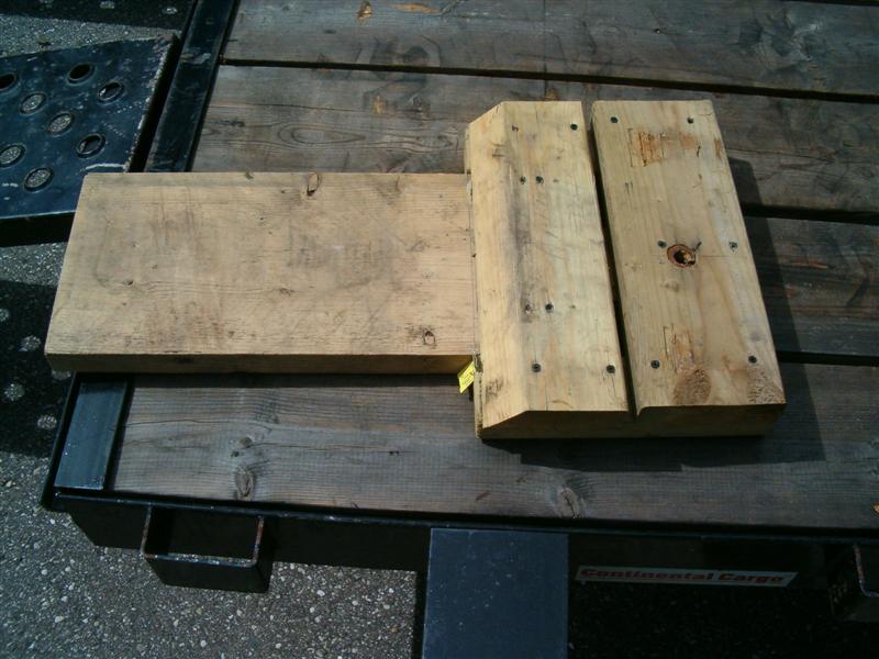

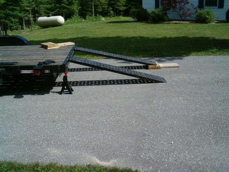

Propjob,
Sorry for the delay but I finally got some pictures. Basically, as the tractor backs up onto the ramp bases and rises 3" before the tires make contact with the ramp. As you can see by the photos, they are very simple. They are belted right down on the trailer so that when I need thm they are right there safe and sound. I need them every time I load or unload. All we are accomplishing here is to raise the bottom of the ramps 3" and this did the trick so my Kioti CK20 with loader and backhoe can go up or down the trailer ramps w/o digging in or scraping bottom. A person could even add another layer of 2 x 6 blocks to raise et even more
rimshot

Thanks for the posts. Your pic's explain a lot. I did build this with a long 2X12 and the corresponding 2X6 overhangs. I see you added additional support to the sides with 2X4's which make perfect sense . I plan to add a piece of metal where the ramp sits on the skid. Thanks for your response back !!!!

I made an extension like rim shots, and it seems to have solved the problem.
