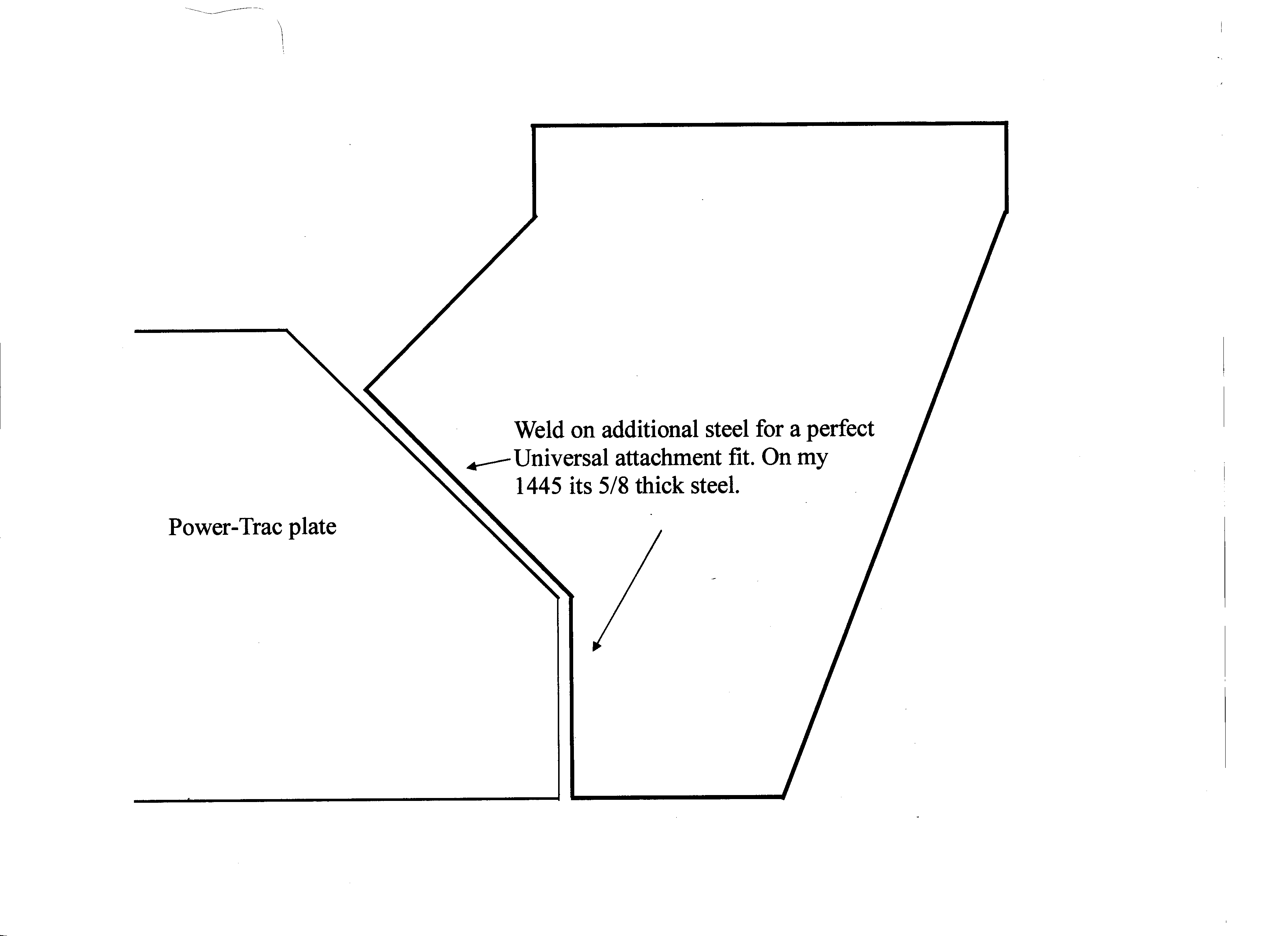

Marrt. Here is is the diagram I drew when I designed my Universal attachment plate. I had to run back and forth to my local Bobcat dealership a couple of times to get the measurments off other skidsteers just right.
I removed my Power-Track plate and took it to my local welder with my measurements. For 150 bucks he cut, beveled the top edge 45 deg, and welded 5/8" thick steel to it that makes a perfect fit for any attachment. I also had him add 1 inch in length to the Power-Trac quick attach pins so they would drop down further into misc. attachments.
The best thing about converting your Power-Trac plate is that you get to keep the quick attach design from Power-Track (very important to me). The only drawback is you have to cut new holes for the locking pins to drop down into in each of the new implements you buy. No problem if you have a plasma cutter or are good with a simple cutting torch. Also on a couple of attachments I have had to weld on extra metal plate for the locking pins to go into.
My next addition will be to move the locking pins out further to the sides where all attachments have the holes allready. It should be fairly simple to replace the existing quick attach ram with a longer ram and drill and tap new holes for the locking pins at the correct width.
I'll still try to get some pictures of all this soon, I have been soo busy I only have had time to read others postings and saw you were about to spend around $700. and give up your Quick Attach feature on your Power Trac. To me the speed at changing attachments is worth more than double that.
