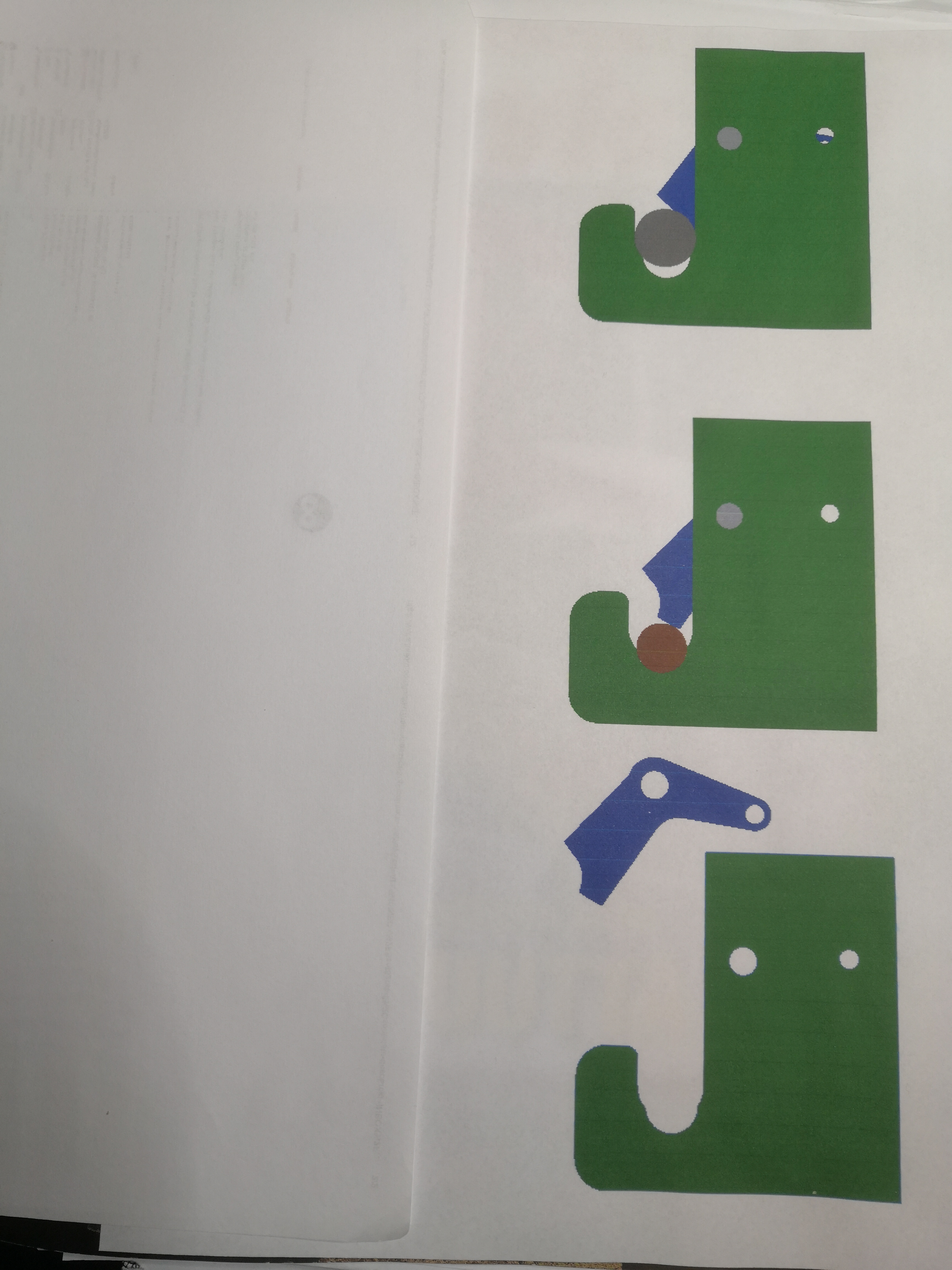

My QH is compatible with both Cat I and Cat II implements
because it have hydraulic width adjustment and manual locking for it?
But then it needs cat3 hooks and bushings as you use in USA, or
the hook needs redesign as I show in picture below.
The width adjustment can be easy by hand lever because it is very light to use.
I made QH part after part and welded together.
The automatic opening and closing of lower latches happen when upper hook go up.

My next trial is to make Euro hooks for big tractors. And I use them from the cabin.
Not difficult but much to measure. Tractor was working hole time at field.

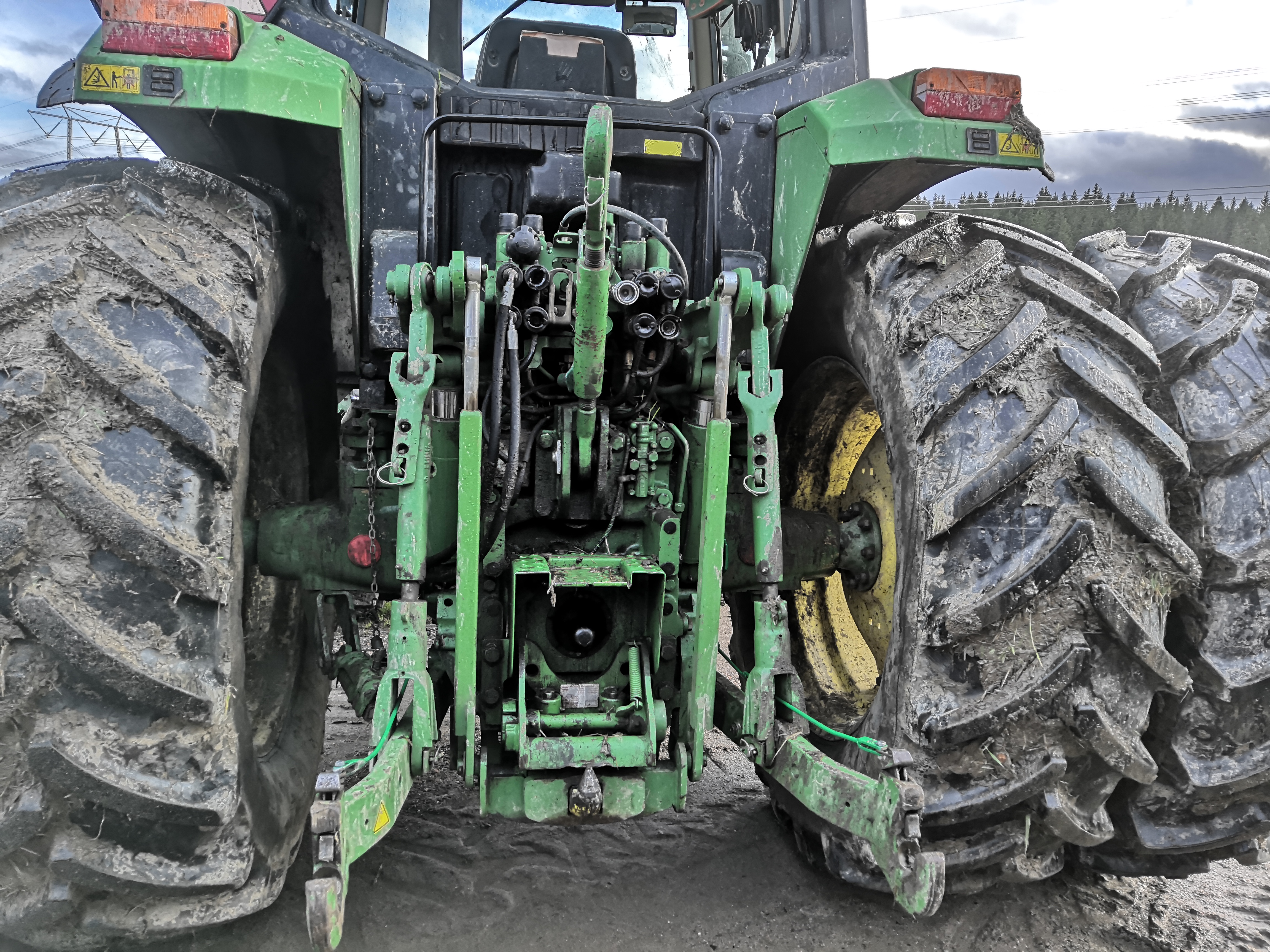

John Deere is ready now to be operated from its cabin for hitching/unhitching.
Before I made a linkage to open both hook latches together from the cabin for unhitching.
Now I have a new linkage to move the right lower link sideways from the cabin.
It makes possible to use two different category equipment with the same tractor.
And non standard equipment too.
Parts are quit simply
And now it has a new hydraulic top link too.
I think that this is the most cheep way to operate from the cabin.
If you like then hydraulic stabilizer bars are good too but expensive.
Now every tractor new or old can get weldable hooks and operation from the cabin.
I have made what I can. Now you must go on!
Good luck to you

/ Universal hydraulic QH for 3-point
#14
New pictures of moving the stabilizer bar from the cabin when hitching the implement.
There is a new lever and linkage for the right spring loaded stabilizer bar and the lower link.
Left side locked stabilizer bar and hook latch opening rod.
