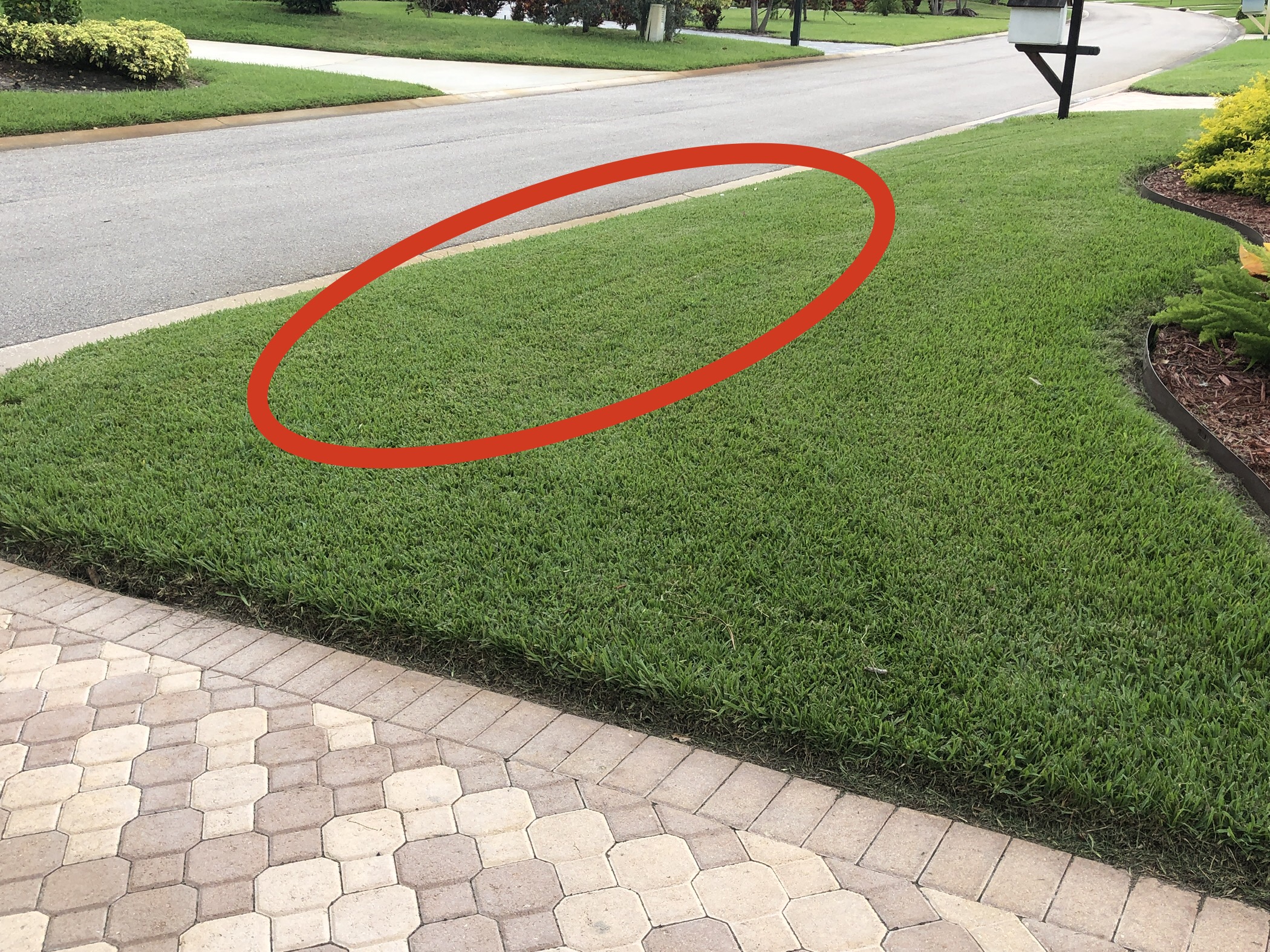

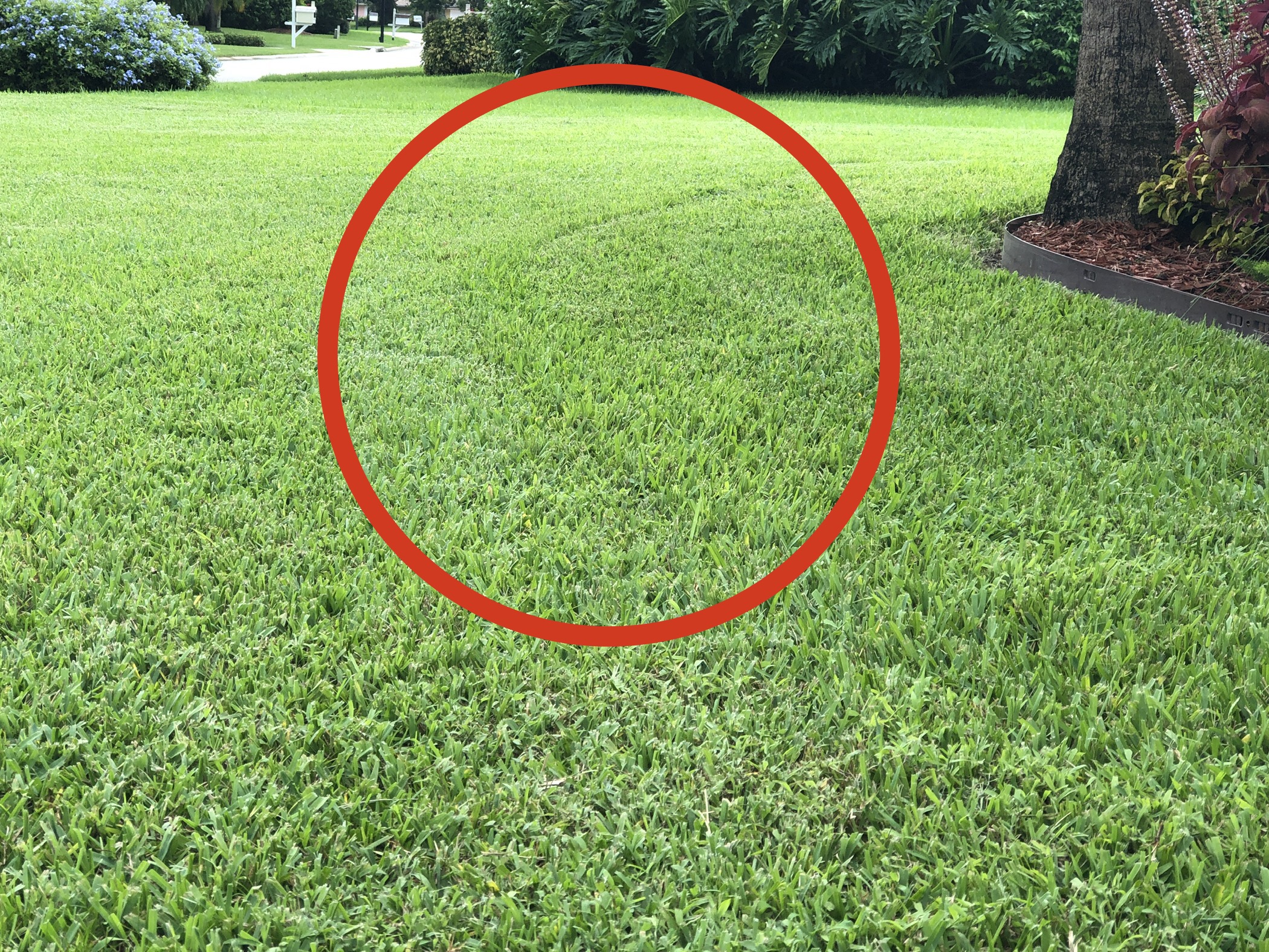

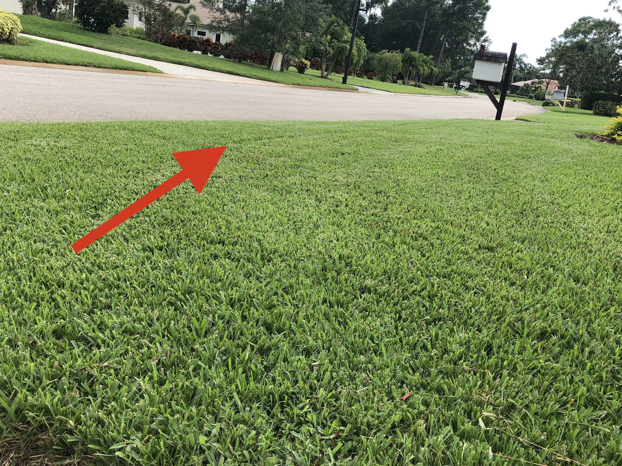

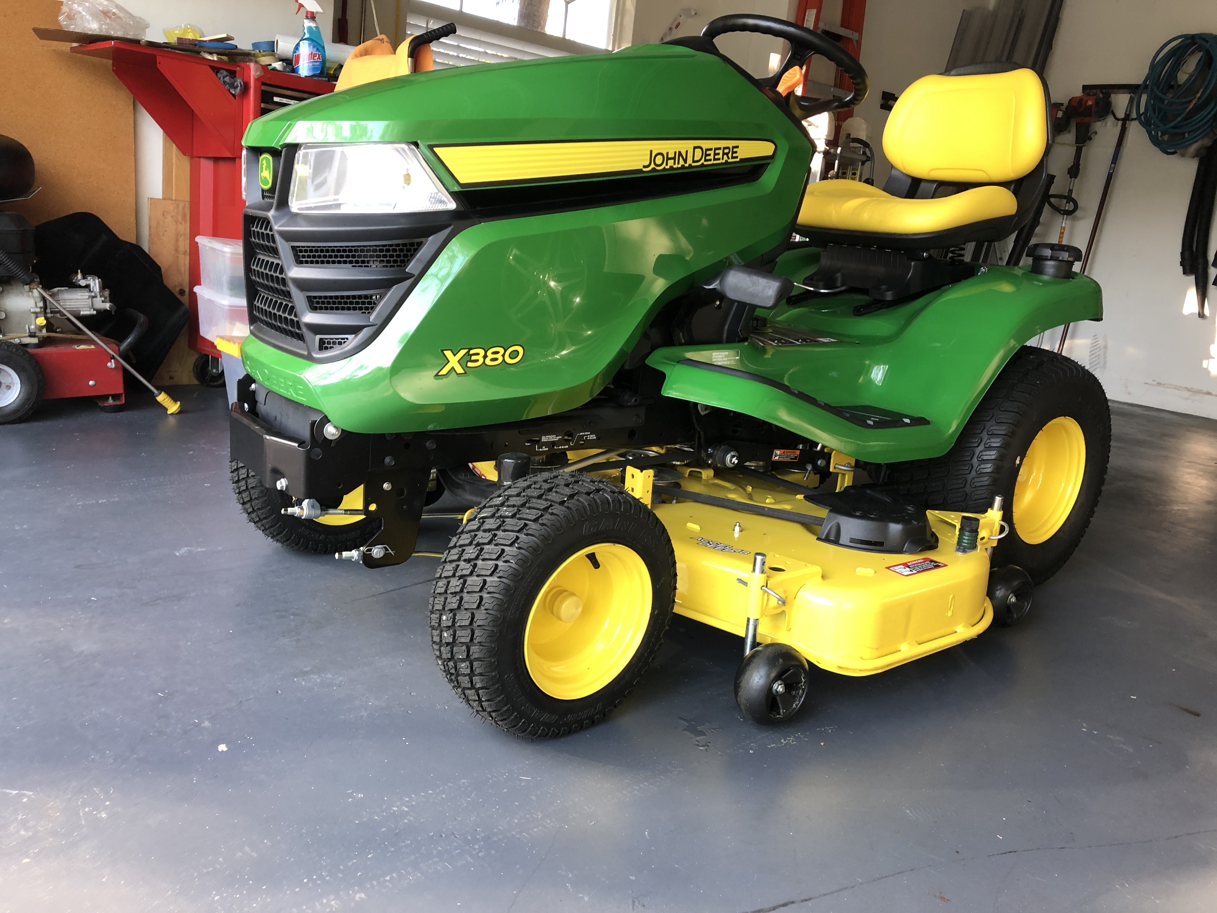

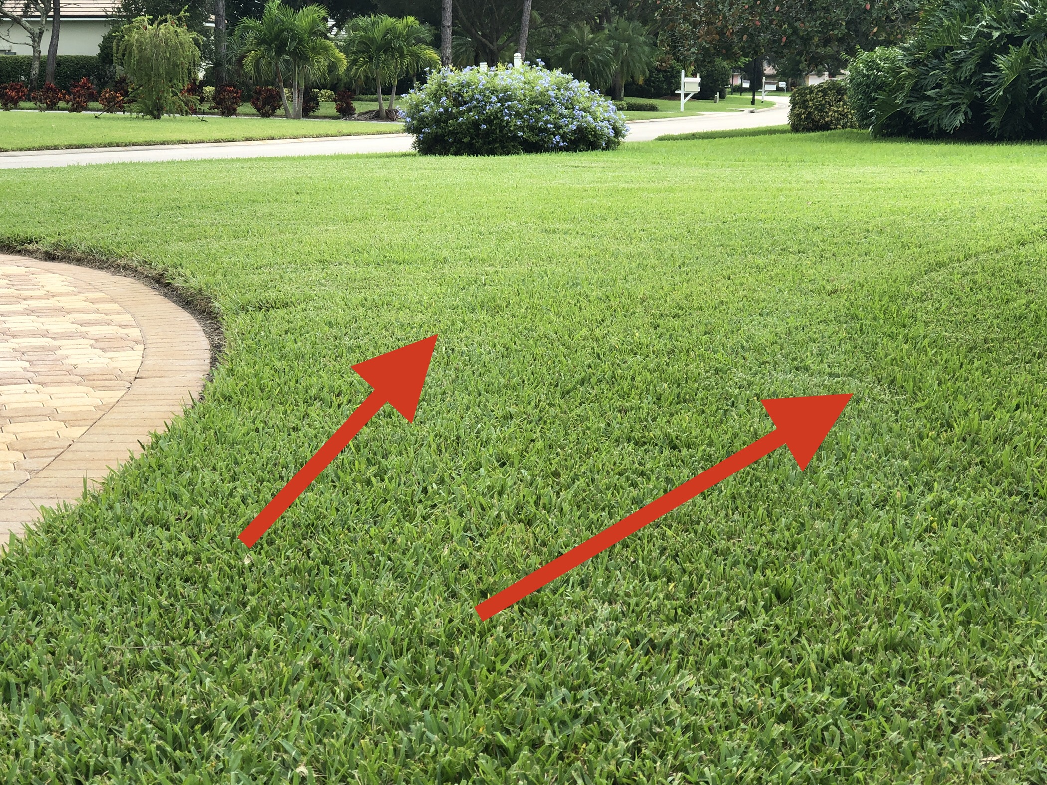

I recently purchased a new x380 to replace my 87 318 due to an oil leak I couldn't find. While I won't yet admit it was a mistake as I only have 3 hours on the x380 but I'm unhappy with the uneven cut as well as how the tractor was delivered by the local JD dealer.
Tractor is a standard x380 with the 48 accel deep deck, manual mulch control and manual deck lift. No P/S or other bells and whistles. We moved to FL and I'm cutting a lawn of what looks like to me (a northerner) the healthiest crabgrass I've ever seen, it's called centipede grass, with some Bahia & Bermuda mixed in but basically centipede. Lawn is Florida flat, cut height is 3½ inches.
Leveling the 318 deck was always a bit of a challenge to me but I could get it right for a nice even cut. Adjusting the mowing height was part art and science but that too was successfully accomplished. JD did make leveling the new deck very easy.
I convinced myself to let the dealer find & repair the oil leak and a weak moment I bought the x380 but told myself how easy it would be to adjust the deck and simply dial the height! No more repairs and a 4-year warranty!
It was delivered with zero set-up, maybe that was an extra option, tire pressure was 26 & 18 on the rear and 14 & 10 on the front. No biggie as I have a compressor and there are a few great how to x380 videos as there was no manual, "it was left on the tractor by mistake and it rained overnight, new one is on order."
I've cut the lawn three times and have the three poorest cuts I think I've ever done. Tomorrow I'll remove the deck to check for a bent blade but was wondering of any other possibilities to check.

How about a picture of your deck? I'd be curious to see how your deck wheels are set. (I'll explain why after seeing the pics).

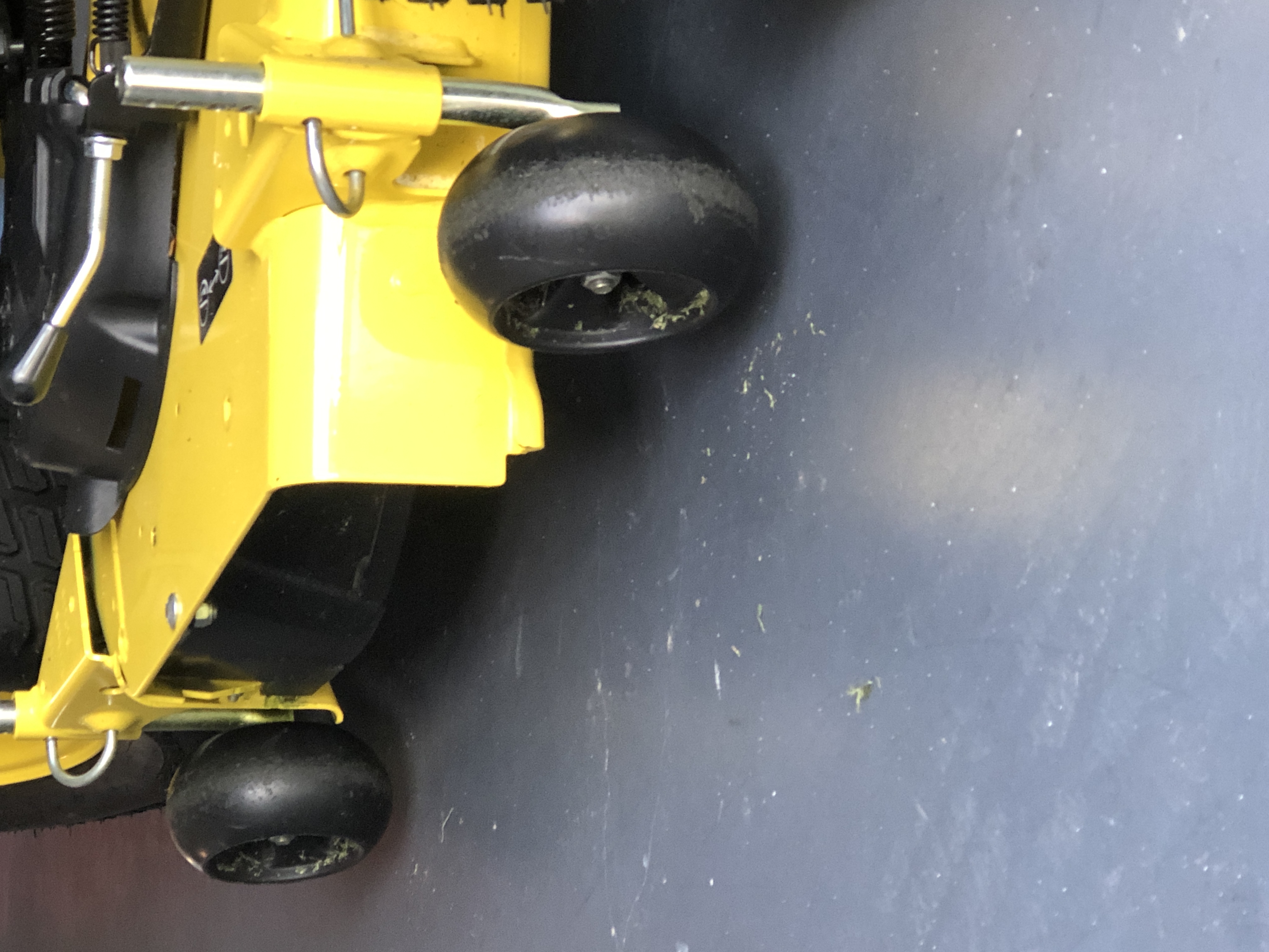

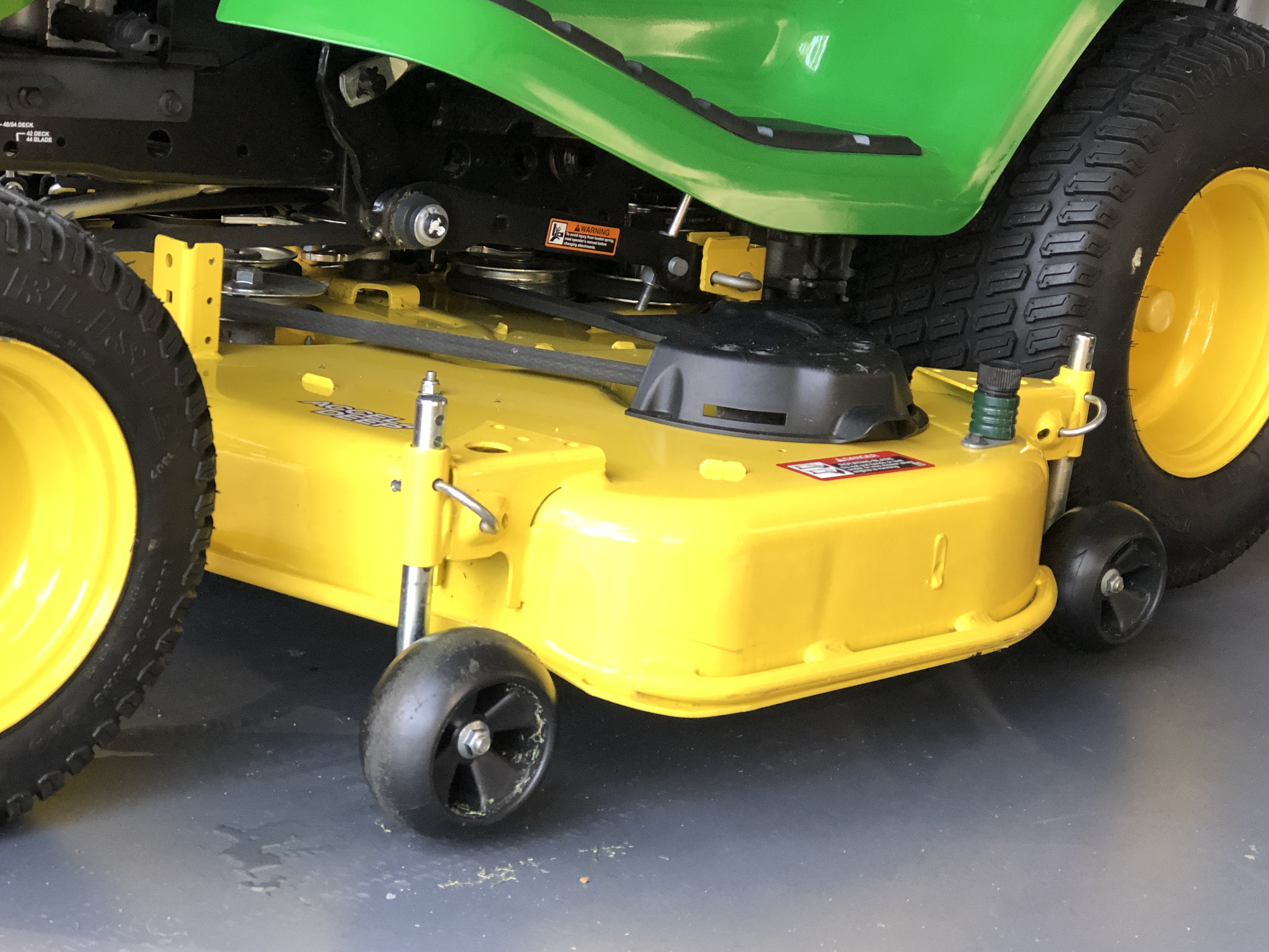

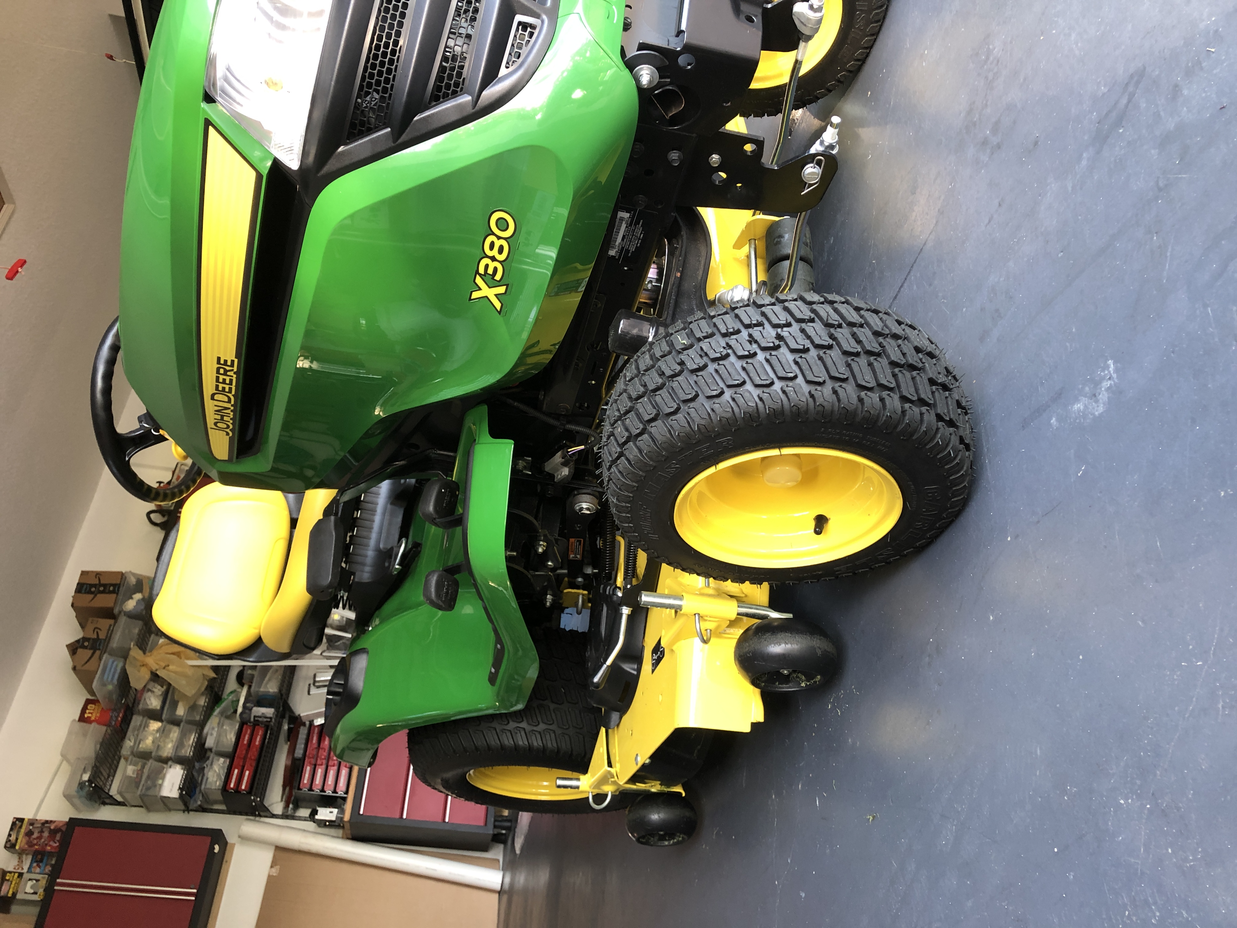

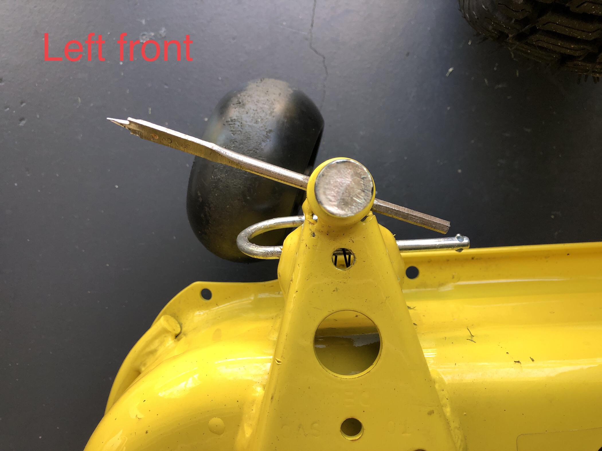

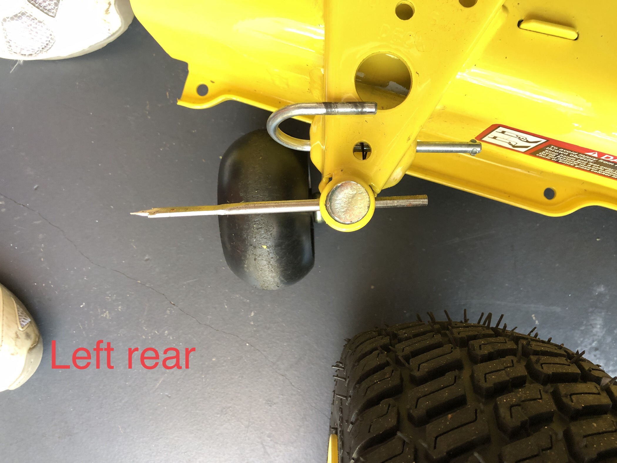

Please see the photos, I leveled the deck twice, checked again this morning and it was level per the gauge, tire pressure was 10# rear, 14# front. Anti scalp wheels are set 3/8" above garage floor with deck set at the cutting height.

Looking at the pictures the anti scalp wheels are not set the same on both sides. On my GT245 the are identical. Could this be a factor in the uneven cut?
/ Uneven lawn cut #10
Like he said...
I see the wheels set at 4pin holes on the right side of the tractor and 2 pinholes on the left side of the tractor. Why?
/ Uneven lawn cut #11
I think the anti-scalp wheels are just too low.
3/8" on a flat level garage is not enough unless your lawn is equally as flat and smooth as the garage floor.
Any undulations in the terrain and they are gonna be riding the deck up and down.

#15
IMG_7716.jpgIMG_7717.jpgThanks for your reply, I noticed the brackets which hold the anti-scalp wheels are not all the same height from the floor with the deck set at mowing height and the wheels in the full raised position. Front left is about 1/2" lower than the left rear while the right front & rear are the same height. The deck looks to be in perfect condition, no dents perhaps a bad weld? I also noticed the front left wheel does not ride at a 90 angle to the forward motion of the tractor. Right side front and read are in a 90 degree angle.

I have noticed the brackets which hold the anti-scalp wheels are not all the same height from the floor with the deck set at mowing height and the wheels in the full raised position. Front left is about 1/2" lower than the left rear while the right front & rear are the same height. The deck looks to be in perfect condition, no dents perhaps a bad weld? I also noticed the front left wheel does not ride at a 90 angle to the forward motion of the tractor. Right side front and read are in a 90 degree angle.

Sometimes the anti-scalp wheel pin holes are NOT accurate when compared to the blade height. Case in point.....my X744 and it's 62" deck. I run the wheels one hole lower on one side than the other side because I want the blades level, not symmetrical looking wheels. This puts the wheels and blades on parallel planes. Yes, I used the blade height guage, checked tire pressure etc etc etc.
/ Uneven lawn cut #18
The left anti scalp roller seems crooked as stated. Don't know if weldment is off, but still should not affect cutting.

Your leveling technique/procedure appears to be right on.. I would get a block of wood and check that the tips of the blades are all the same or within an 1/8" of being the same.
Sounds like your dealer doesn't have a clue what to do, and when I worked some part time with a good local JD dealer, learned that the shop manager was setting up a JD mower for a large local farmer that bought a lot of JD equipment. That farmer was always complaining about how poorly his JD $10,000 mower was cutting. I was sent out to check.. the mower deck wasn't even close to being "leveled" per the procedure outlined. Got him fixed up and learned a bit more about the shop manager.. 'nuff said.
So think it is up to you to find out what is wrong, and toss the knowledge back to this dealer. Or ask for a new deck, or lawn tractor that the deck can be leveled, and one that is of the quality of your 318 (if I recall correctly that it is what you had before). Those are $10k tractors now, to be equivalent.
