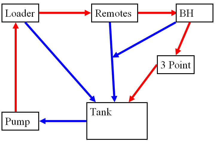

Mine has 3 lines. Why not just 2? (One supply, one return?) 2 of them have quick connects, one does not. The one that does not is looped to one of the remaining 2 with the quick connects. What's the deal? The tractor once had a backhoe on it. Are 2 feeds necessary to run a subframe mounted backhoe?

On most CUT's when the backhoe is mounted the 3PH is bypassed, so there is a extra return that goes directly to the tank.

Is that the reason for 3 circuits? When the backhoe is installed one is backhoe supply, one is backhoe return and the 3rd is the one is the 3pt hitch return?
Yes, I kind of eluded to that in my first reply...there are TWO returns, one feeds the 3PH (what your "loop" is connected to now) and the other bypasses the 3PH and goes directly to the tank. Not positive your machine is this way-but a lot of CUT's are.

Assuming that we are talking about Builders Agco/Challenger, TractorData.com says that the hydrualics are open center which would make these three hoses highly likely to be: PB in, PB out (the two that are coupled together, normal warnings of not running without these being hooked together at the risk of cooking a hyd pump) and waste return (lone hose) they can be used for a BH or anything else that you want to add separate hydraulics for.

I think it's the "waste hose" as you call it that has me baffled. I can understand PB in and PB out. What's up with the waste hose??
Being as you could be using something downstream of the PB out (ie: if your loader is before the backhoe your fluid flow could look like (Red is high pressure): PB In on Loader > Loader > PB Out on Loader > PB In on BH > BH > PB Out on BH > Three Point Hitch > Tank)
Thus you might be trying to lower the loader while the curl circuit on the backhoe is engaged, then the fluid trying to exit the loader would have to get to a high enough pressure to make the BH pressure relief go into bypass before it could get to the tank. That would be suboptimal and would make doing anything difficult, as such there is a "Waste" hose that is guaranteed to go directly into the tank without any blockages or significant backpressure no matter what.
This way your fluid flow in the same situation would look like (Red is High Pressure, Blue is Low pressure): PB In on Loader > Loader > Low pressure waste line > Tank less complicated and easier on the equipment
Here is an system fluid flow diagram as it would probably be for your tractor with the BH installed. Blue is low pressure, Red is high pressure
Clear as mud?
