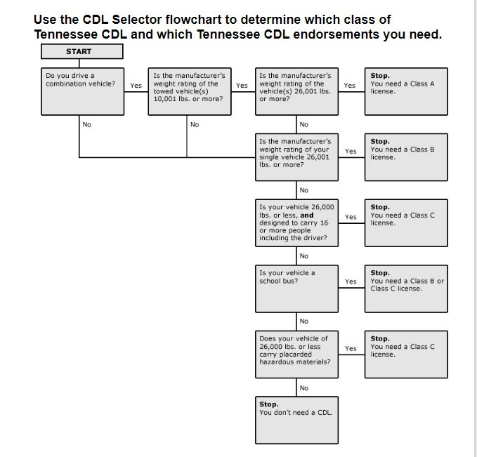

I'm trying to figure out if this site is legit for getting requirements to take the cdl test and get licensed.
I have heard that you now have to take one of the CDL courses and have a CDL learners permit in some states before you can take the test. Passing the knowledge test is a requirement for the learner's permit.
  • To be eligible to apply for a commercial driver license, federal rules state that you must:
    • Must be 21 years old to: Drive across state lines. OR operate a vehicle containing hazardous materials.
    • Have no prior disqualifying criminal offenses. Certain criminal felonies may disqualify you from CDL eligibility.
    • Complete an entry-level commercial driver training program (see below for more details on this CDL requirement).

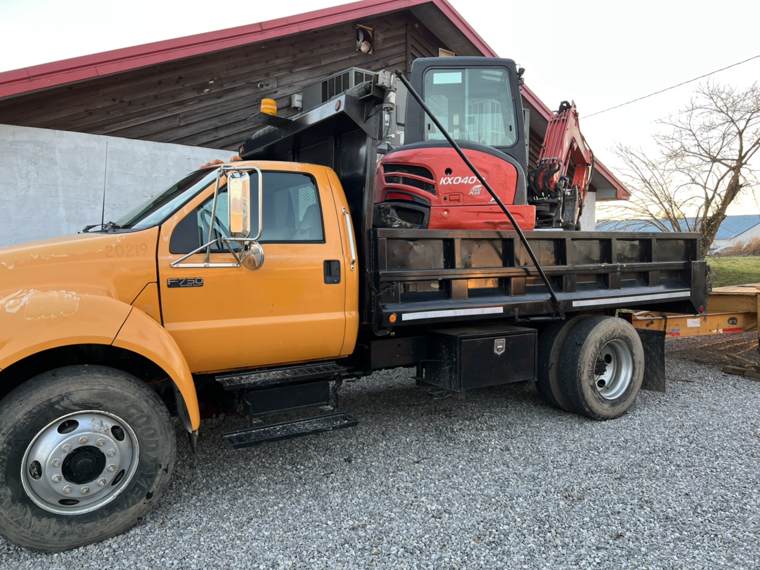

Even if that’s true it doesn’t help you a lot. You would be limited to probably a 26 class excavator or at the very top end a 35 class excavator. Maybe consider aluminum ramps and load the excavator in the dump truck. I could load a 57 on mine and still be under payload. View attachment 792571
Thats why I said a couple of times a class 27 excavator would be about the limit because a 35 would be pushing a 10k trailer too far.
He hasnt actually said what he wants for an excavator yet?

You might be better off with a 2500HD with the heaviest machine you can put on a trailer and keep your combo under 26K.
Then go get an older 25,999 dump truck for hauling. The way the rules & regs are with CDL’s it’s very tough to combine a truck that can haul a lot with a truck that can tow a lot.
I don't know this site is legit or not but you can do your knowledge training and take the theory test without attending in-person classes. You still have to pass the skills test.
