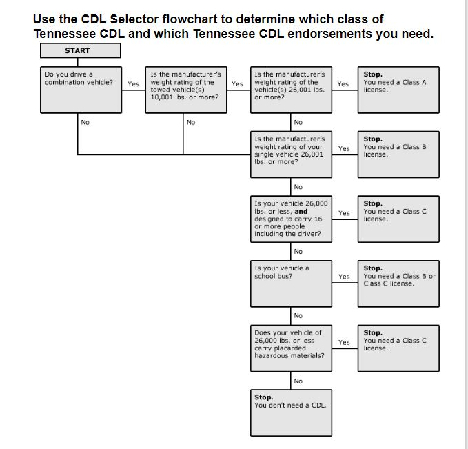

The FEDs don’t issue drivers licenses.
No but they set the minimum requirements for CDL classes....most states follow their guidelines.
Tennessee happens to follow the federal guidelines. Meaning you have a truck under 26k.....it can ALSO pull a trailer UNDER 10k with NO CDL. Meaning you can have a combination of 36k and NO CDL.
Either read the classification, or follow the flow chart. Its black and white
   / Understanding Curb Weight, GVWR, Towing and CDL requirements #18
Follow the flow chart... 26k truck and a 10k or less trailer
Combination....YES
Is trailer 10,001 or more....NO
IS the single vehicle 26,001 or more....NO
Is the vehicle designed to carry more than 16 people....NO
IS it a school bus.....NO
Does it have haz-mat placard.....NO
YOU DONT NEED A CDL

   / Understanding Curb Weight, GVWR, Towing and CDL requirements #20
Combination....YES
YOU DONT NEED A CDL

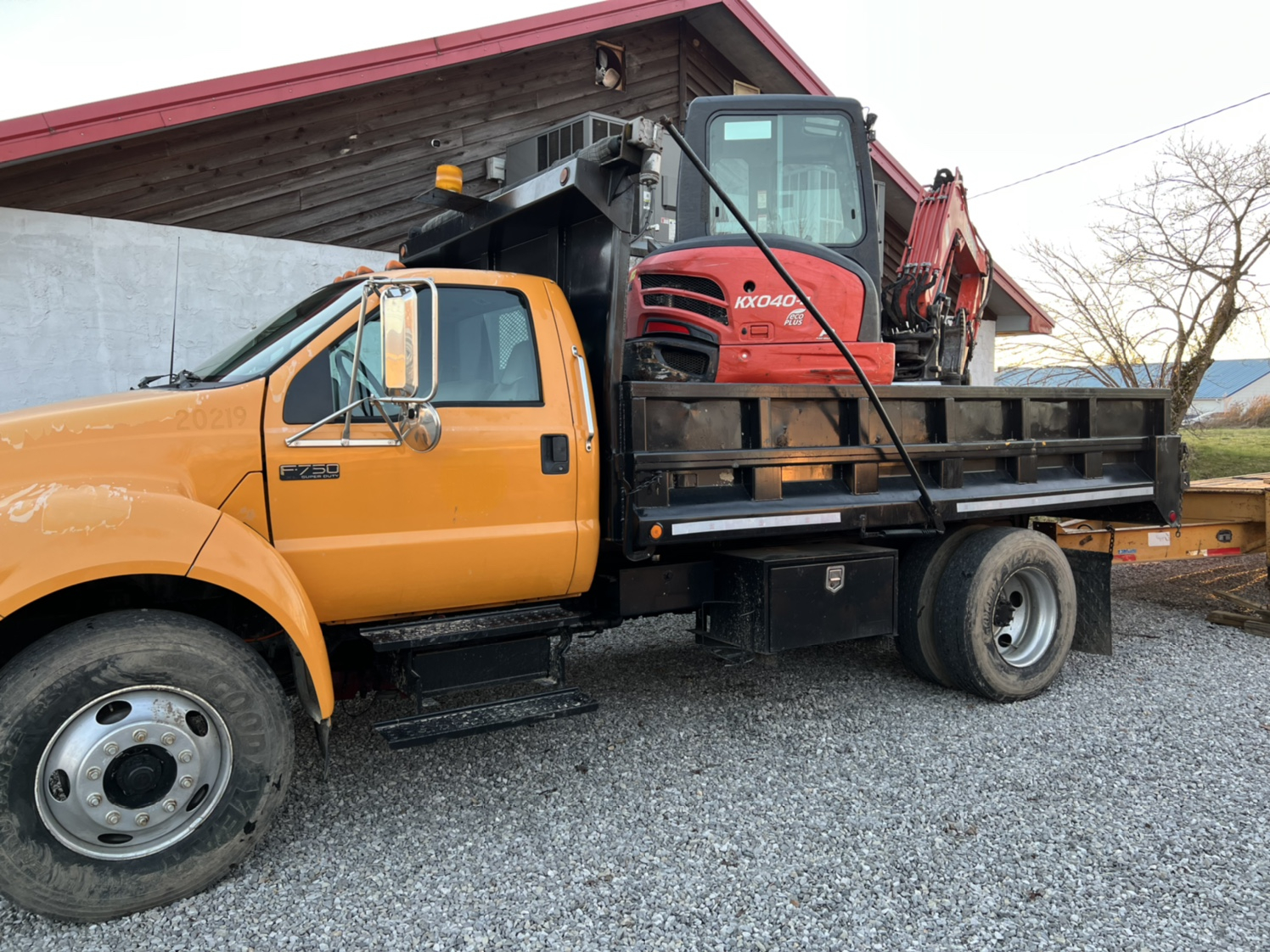

Even if that’s true it doesn’t help you a lot. You would be limited to probably a 26 class excavator or at the very top end a 35 class excavator. Maybe consider aluminum ramps and load the excavator in the dump truck. I could load a 57 on mine and still be under payload.
