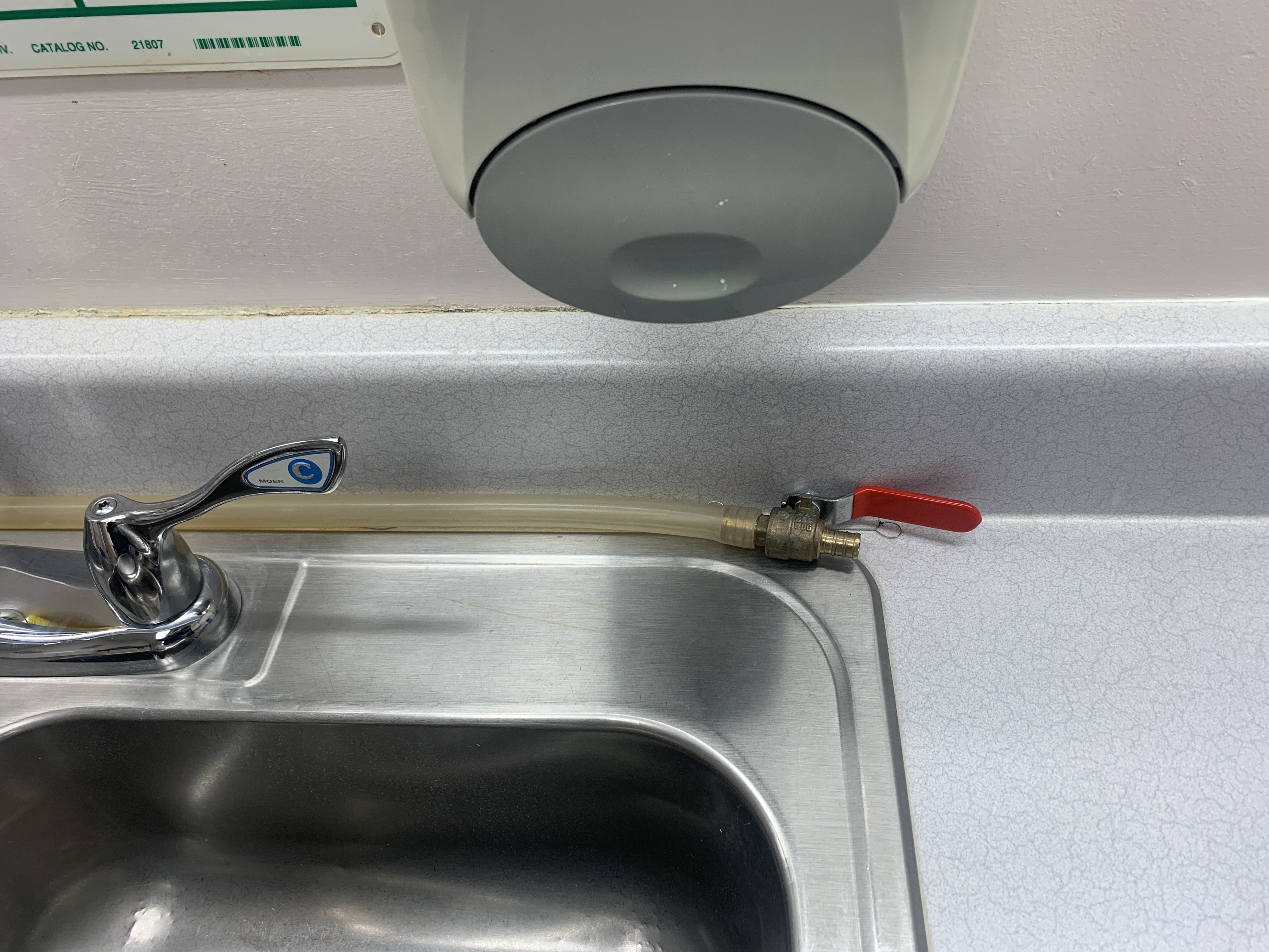

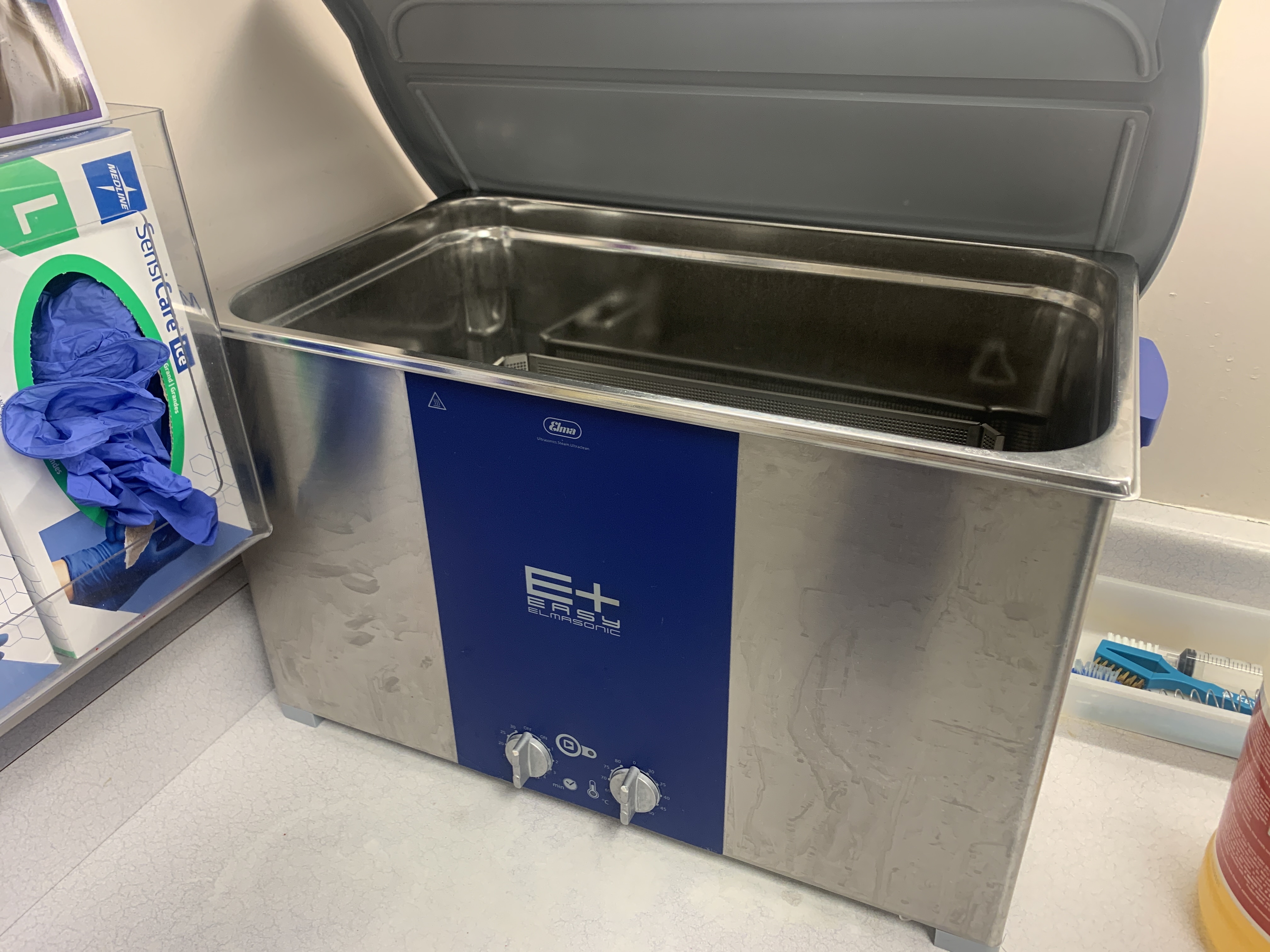

This is my largest and paid $900 pre pandemic pricing.
Sterile Processing stopped using it because the plastic drain valve broke.
I added a 1/4 turn ball valve last year and no more problem.

Sometimes outside the box work arounds are simple, quick and cheap…
It was only to be temporary but after a couple of days the sterile processing staff said they no longer needed a replacement.
Had I not fixed it… it would be in my shop because I was told to toss it…
