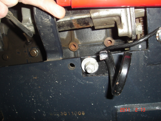

Ground cable, redux:
I've decided that, since it was such an issue, I'm going to install a SECOND ground strap/cable on the other side of the engine. Do NOT want to go through last week again!
The Iseki engine block (and the frame nearby) has the same holes as the left side --BUT-- the hole tapped into the block on the original cable was Metric 10 x 1.5 thread, and the ones on the right side are 10 x 1.25 thread. :confused::confused:
Oh, well, two trips to the hardware store to get the right bolt, and I'll be installing a second ground cable on the --other-- side. I'm just using a nut on the inside of the frame hole, as there wasn't one welded onto the inside surface.
For the cost of 11 bucks or so, I figured it was worth it to add a second ground.:)
Pic shows the tapped holes in the right side of the block, 10 x 1.25.

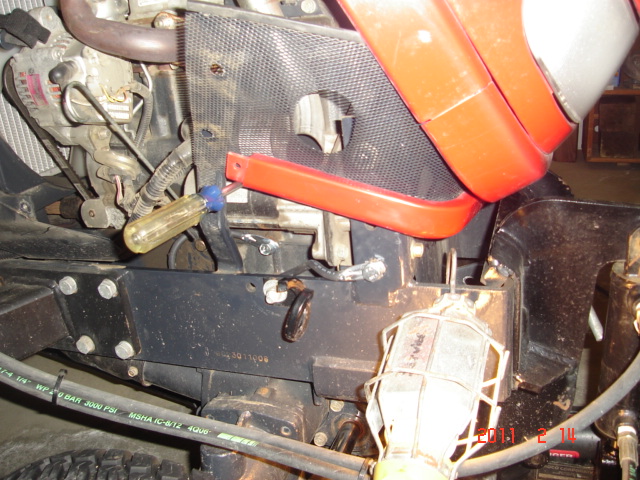

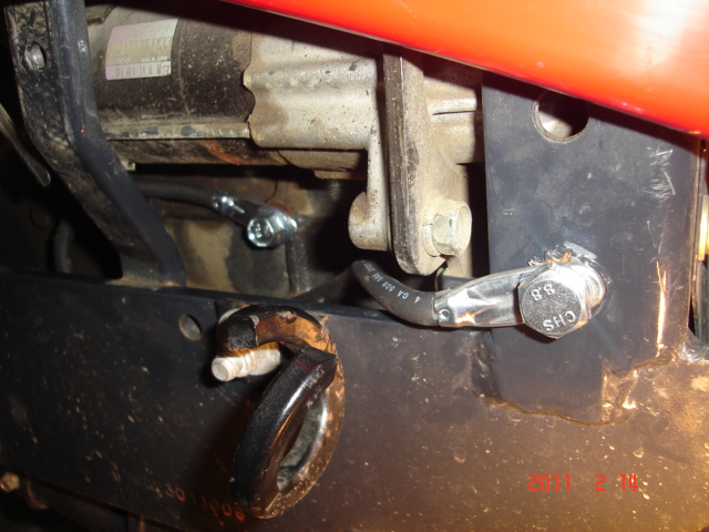

OK- bought a second real (not home-made:ashamed:) ground cable, now installed on right side of engine.
That oughtta hold 'er!:D
Incidentally, this is apparently the "new" version that NAPA sells; looks to be very good quality, sealed on the ends, with copper wire going all the way through to the end of the metal tip.
Musta have been crimped flat around the wire, then the hole punched through; I can see copper inside the edges of the hole on the end. Insulation/sheath is also the new much more flexible (silicone-based?) kind, same type as on good quality jumper cables. (You know, the kind that don't get impossibly stiff at anything less than 20 degrees?:laughing:)
Hopefully, it'll be a lot more than 3 years and 200 hours before I have ground problems again!:thumbsup:

Yep- Both cables I got have the same number, 711894.
They're both 4 gauge wire, 18" long. The first one, in a mostly yellow box, was the traditional style- brass ends crimped over the wire, with the usual stiff sheathing. The "new" one, in a mostly blue box, was the really nice one.
Apparently, the first one I got was old stock, the second one the newer version. You might have to check what you're handed.:thumbsup:

Remember, if you put one on the right side, the hole in the block --at least on my LRB-- was tapped with a different thread than the one on the left side: 10 x 1.25 (vs. 10 x 1.5 on the left).:confused:
