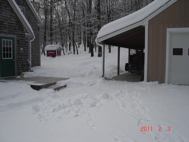

2007 GC2310.... just hit 200 hrs yesterday. Used tractor with snowblower heavily for 2 hrs or so, parked it, shut 'er down, went to bed.
Today, after MAJOR snowstorm, went out around noon to start it up. It had been on the block heater for about 20 mins, plenty of time.

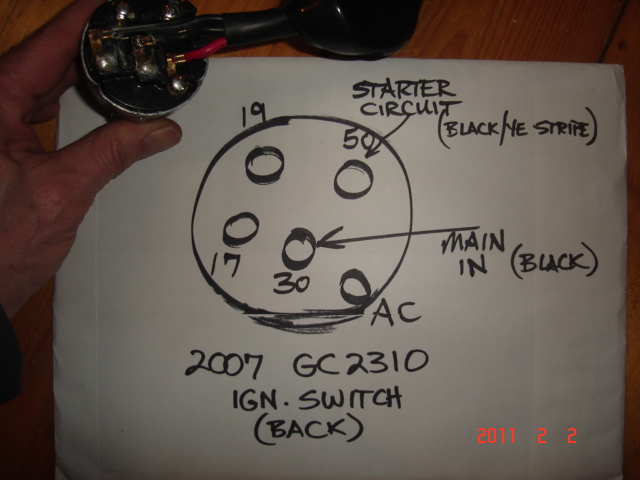

Dug out the owner's manual and the service manual, began studying wiring diagrams. Eventually bypassed all safety switches by jumping out the starter (also called "safety") relay, even though I could feel the relay operating, and on the bench it did just what it's supposed to when exposed to 12V. Still no crank. :mad:
As near as I can figure, the only things in the crank circuit are the Hi-Lo range safety switch, the PTO safety switch, the starter relay (gets coil power through the safety switches), the 40A slo-blow fuse, and the ignition switch itself along with the starter solenoid. (Seat switch does not have to be closed to start, as long as other switches are clear.) Other branches of ignition circuit all seem to work- fuel gauge, dash lights, fuel pump, fuel shut-off solenoid, etc.
Oh-- did I say that it's cold out today, snowing, and the tractor is NOT inside? Well, at least it was mostly undercover...

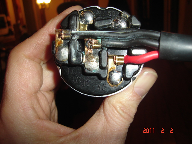

After making some jumpers and bypassing the "safety" relay with no luck, I eventually pulled the ignition switch --after removing a couple of panels....
Ah-ha! Inside where it's warm, on my workbench, no continuity between #30 (main 12v feed) and #50 (out to switched leg of starter relay, then to starter). There was also a bunch of green stuff on a couple of the terminals- obviously, some moisture got under the rubber cover on the back of the ign switch.
Cleaned it up with some TV tuner lube/cleaner, added some solder to make sure 2 of the flakier connections were good, and now I have continuity when switched to "start" position between #30 and #50. All other switch funtions read OK, too. All this, on the bench.
Figured I had it licked, except upon re-installing ign switch in the tractor, removing jumpers and putting everything back in order, STILL no crank.
Now it's getting dark, and I've got about 18" of snow all over. Finally called a pal with a plow truck to have him clear my driveway; how embarassing!

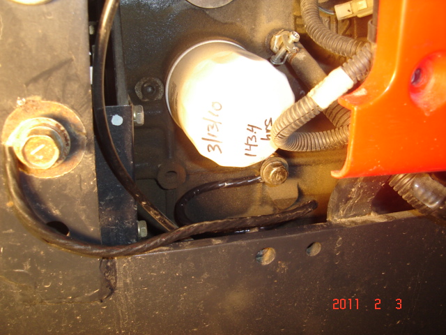

one thing to check is the ground strap that goes from the frame to the engine block,located by the engine oil filter mine broke and i had a no start situation,traced it back and found it broken,worth a shot

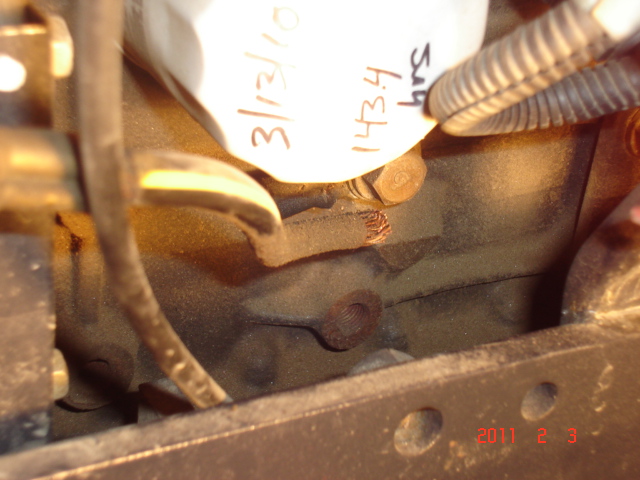

/ Uh-oh. This could be serious.
kennyd- perhaps you could add something here...

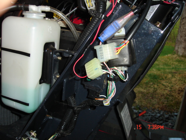

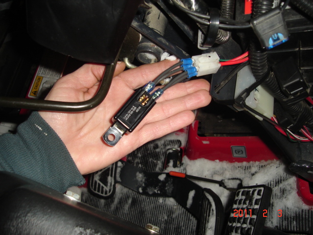

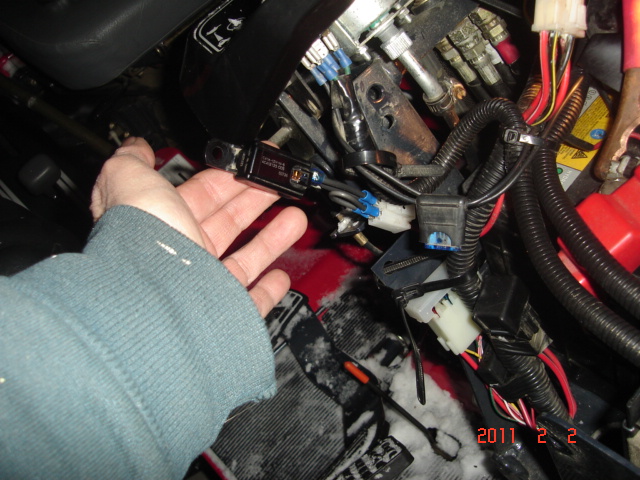

First, I pulled out the bulb on the temp gauge, tried starting, no change. Fuel gauge light still came on with headlight switch. Then I unplugged headlight molex altogether- still no start. Put temp gauge light back in, reconnected molex to headlights, tried again- no temp gauge light now, but perhaps just a burned out bulb. Fuel gauge light still works with headlight switch. None of the wires I had added before showed any evidence of chafing.
THEN, things got interesting: I fashioned 4 extensions --male-to-female 1/4" spades, about 2" long-- so I coud separate the connector to the start (safety) relay. I wanted to be able to put my test light on the wire coming from #50 on the start switch, which is only powered in the "start" position, to see if 12V was even getting out of the ignition switch and into the switched leg of the relay.
As I was hooking up my 12V test light, I had a bad ground- wiggled the clamp (on alternator bracket) while touching battery positive to make sure I had a working light. Then I hear this "click" noise as soon as the test light lights up....
Turns out that, as soon as my test light is connected from batt positive to ground (through bulb, of course), the start relay kicks in--key is in OFF position!:confused::confused: Then, I hear the d____d fuel solenoid operating!!:confused2: Pull the test light off the battery, start relay kicks out, and 10 seconds later the fuel solenoid drops out!
Yep, a weird ground somewhere- started to get too cold so I came in- it's about 11F this AM. I guess the next step is to check the frame ground as revver6 suggested. (Gotta warm up first!)
UPDATE: Couldn't resist taking a quick look, while shivering... revver6 I love you! You nailed it! Now all I have to do is fix it and see if the beast will start... Thanks a million!:thumbsup::thumbsup: Been up already for 2-1/2 hrs, really need to go to work soon- I'll update as soon as I have more info.
Thanks again to everybody- learned sump'n new today, for sure!:D

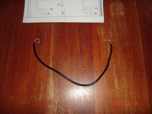

EDIT: revver6, I may have eventually found the broken ground, but I shuuder (literally!) to think how long that might have taken. Your directions about where to look undoubtedly saved me a ton of time, there it is, right below the oil filter!

ABSOLUTELY! "Houston, we have ignition!" At least, with a temporary ground strap (longer, with vibration absorbing bends in it!), the starter finally kicks in, no "clicky-clicky" when I test the test light on the battery....
Whew! Now tractor's plugged in to block heater, start relay back in place, and I have several panels to re-install. But, I'll try it first to make sure it starts.
All I had available here was a piece of #8 (or #6?) stranded copper cable- but that's gotta be better than the old one, which was apparently hanging on by just a few threads before it burned itself off completely. Permanent replacement will come later. I made circles on the ends of the wire, then pretty well saturated them with solder. Might even be as good as the old one....
revver, I agree 100%- sure looks like the cable was too short, engine vibration eventually started to crack the strands. Any permanent replacement I get will d___ sure be longer!!
