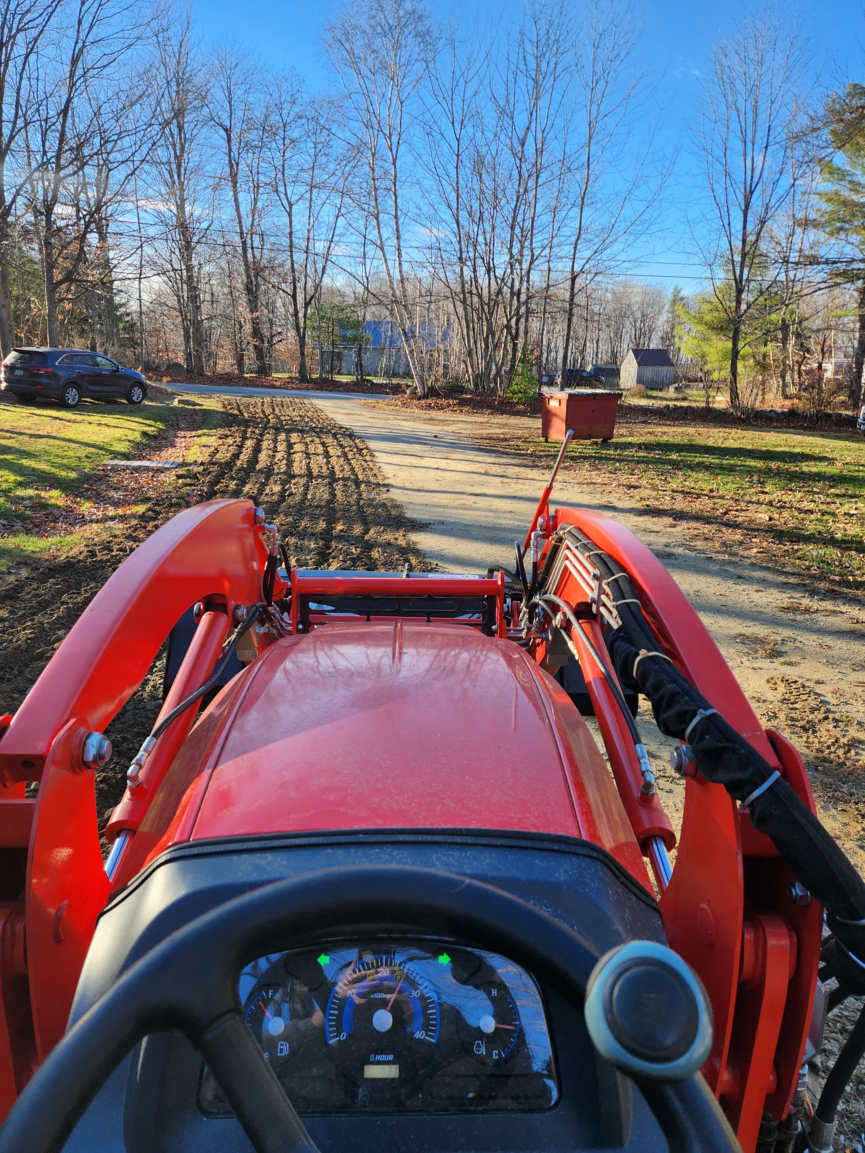

So I decided to tear up and smooth out the driveway before winter. I got the tear up part about done and she again doesn't want to drop the 3 point.
Turned the dial for drop-rate back and forth a bit to see if that had stove up a bit, it didn't help any. This doesn't seem a common problem, so I'm irritated.
I'll give the dealer a call tomorrow.

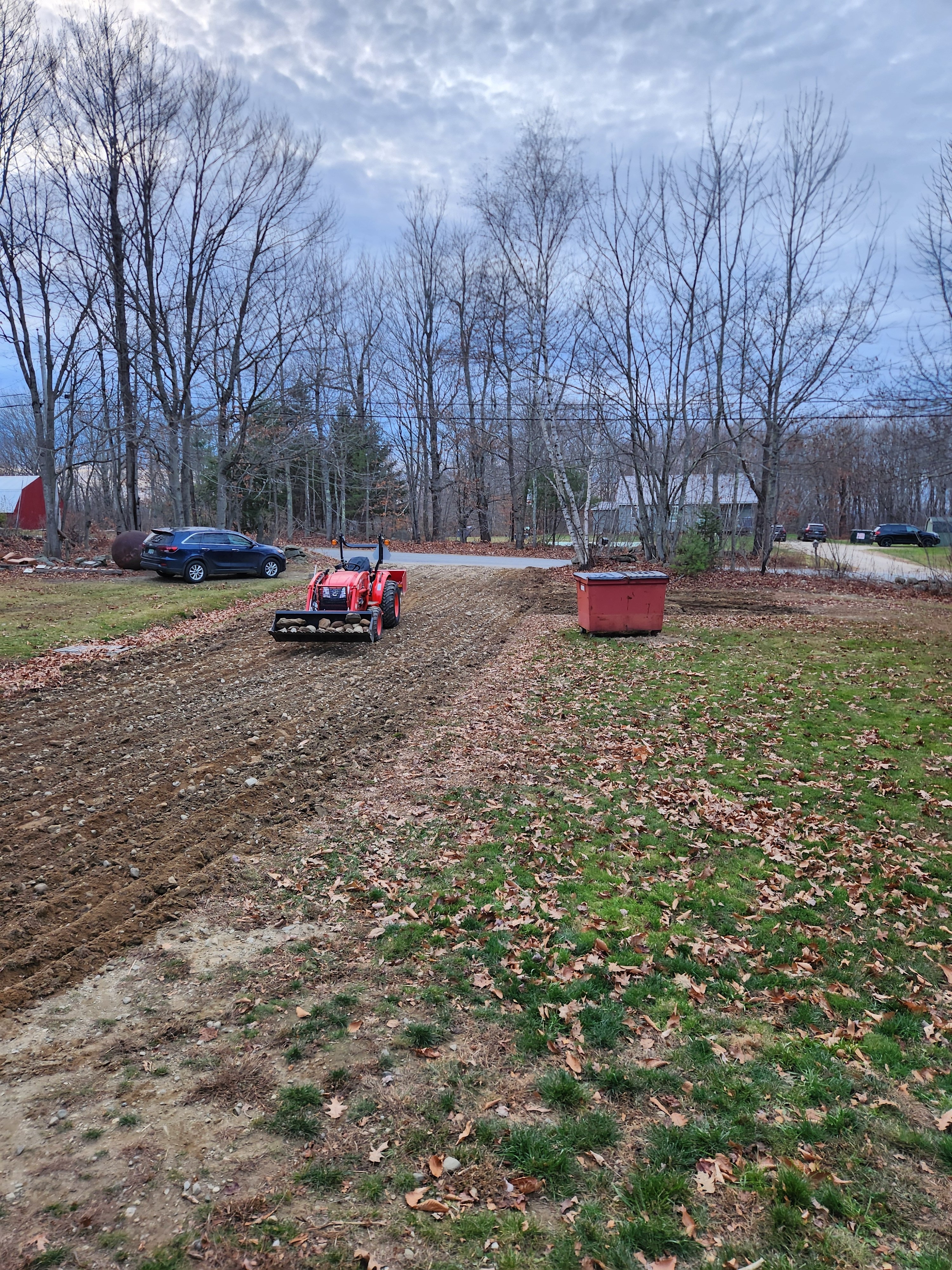

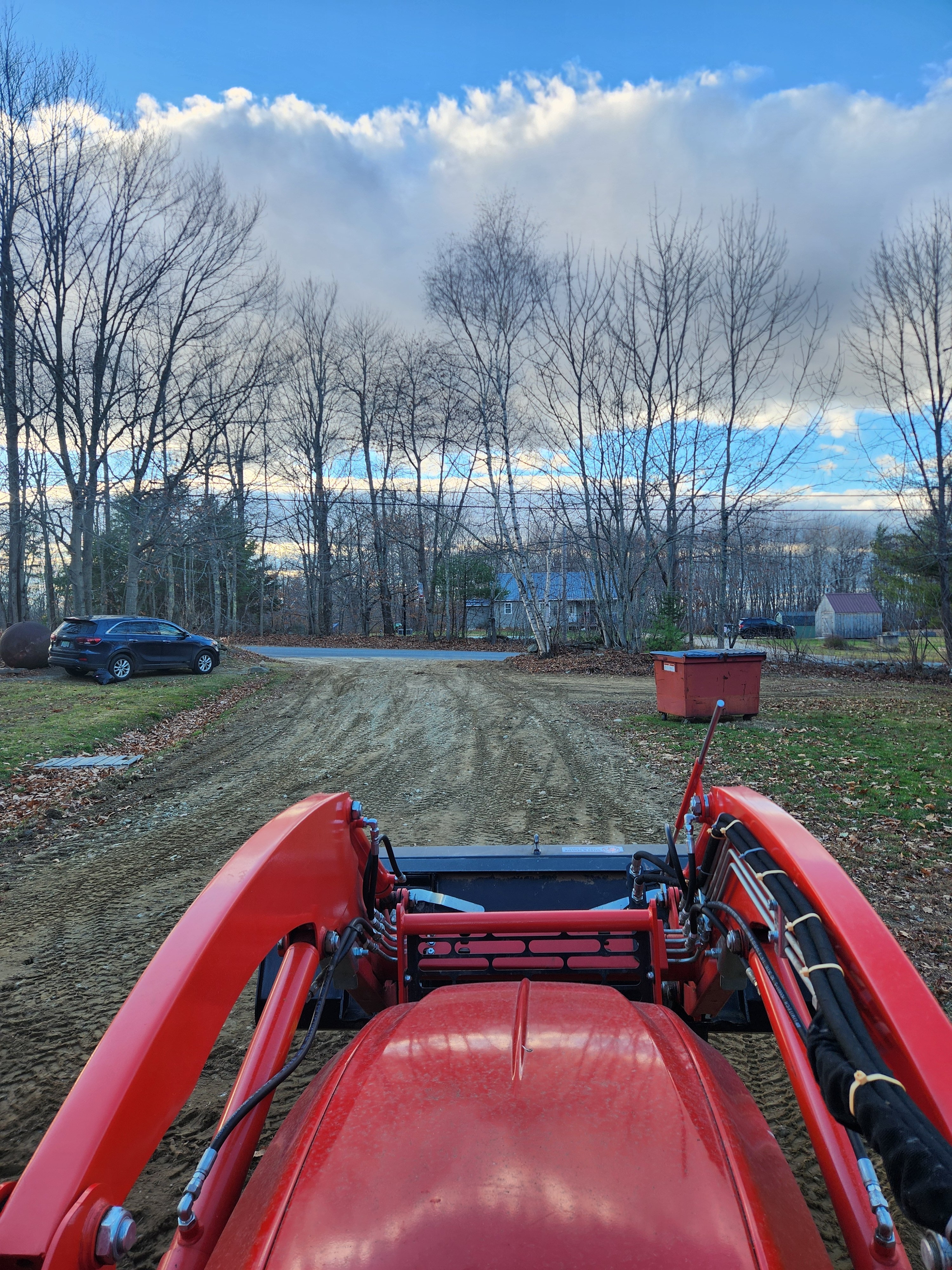

The dealer ought to call me back, but hasn't yet. In the meantime I used the loader to backdrag the driveway, and as soon as that was done I took a photo.
I got the driveway about back to what it was before I started, and suddenly found my 3 point worked again.
So I started smoothing it out with the box blade. It worked nicely until it didn't; the control ceased working.
