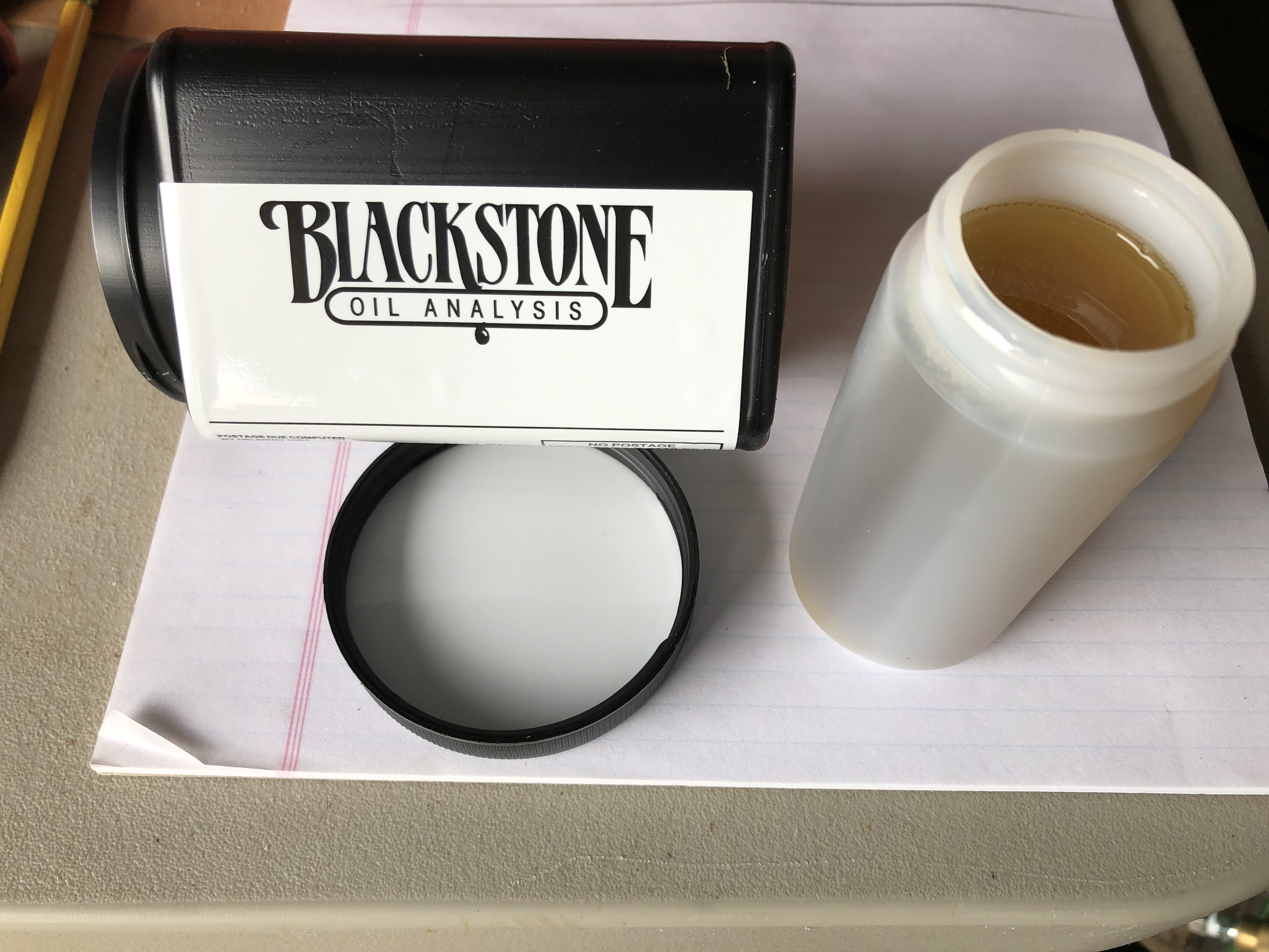

I propose sending out a sample of my hydro fluid and seeing what the lab has to say. I found one from Blackstone laboratories for $30 which was recommended from TBN from a guy who said he was going to do the same thing, but never posted the results.
https://www.tractorbynet.com/forums/oil-fuel-lubricants/282387-can-you-get-oil-analysis.html
I will deliver.
The kit has been ordered. Granted I will be taking the sample from my reservoir, and from reading about other testing companies, they want me to hook up a valve and tie it into the system at a specific point. I think this will offer a general idea. It will be a fun experiment.
/ UDT2 Maintenance interval, time vs. hours
#16
Got kit in mail, sampled from dipstick. It came with a prepaid shipping label on it, a bottle in a bottle, and a simple postcard for info. I'm sure the test is a basic as it gets, we'll see.

can't wait to see the results. nothing like data to back up a certain point of view.
/ UDT2 Maintenance interval, time vs. hours #18
It's testing for foreign liquid, water, fuel, etc. And it's testing for heavy metals. Your analysis of the results is up to you.
Care to elaborate? How is it up to me? Are you saying it's a personal opinion?
Granted it's an inexpensive test and not like the $100-$200 ones I see. I would assume that if it's clear from contamination, it would be viable.
Whether or not it can show how much it has degraded and can operate as intended is the question. If it could be compared to a sample that was unused that would be able to give me a fair idea of its condition.
Don't make me send out a clean sample! Don't do it! lol
