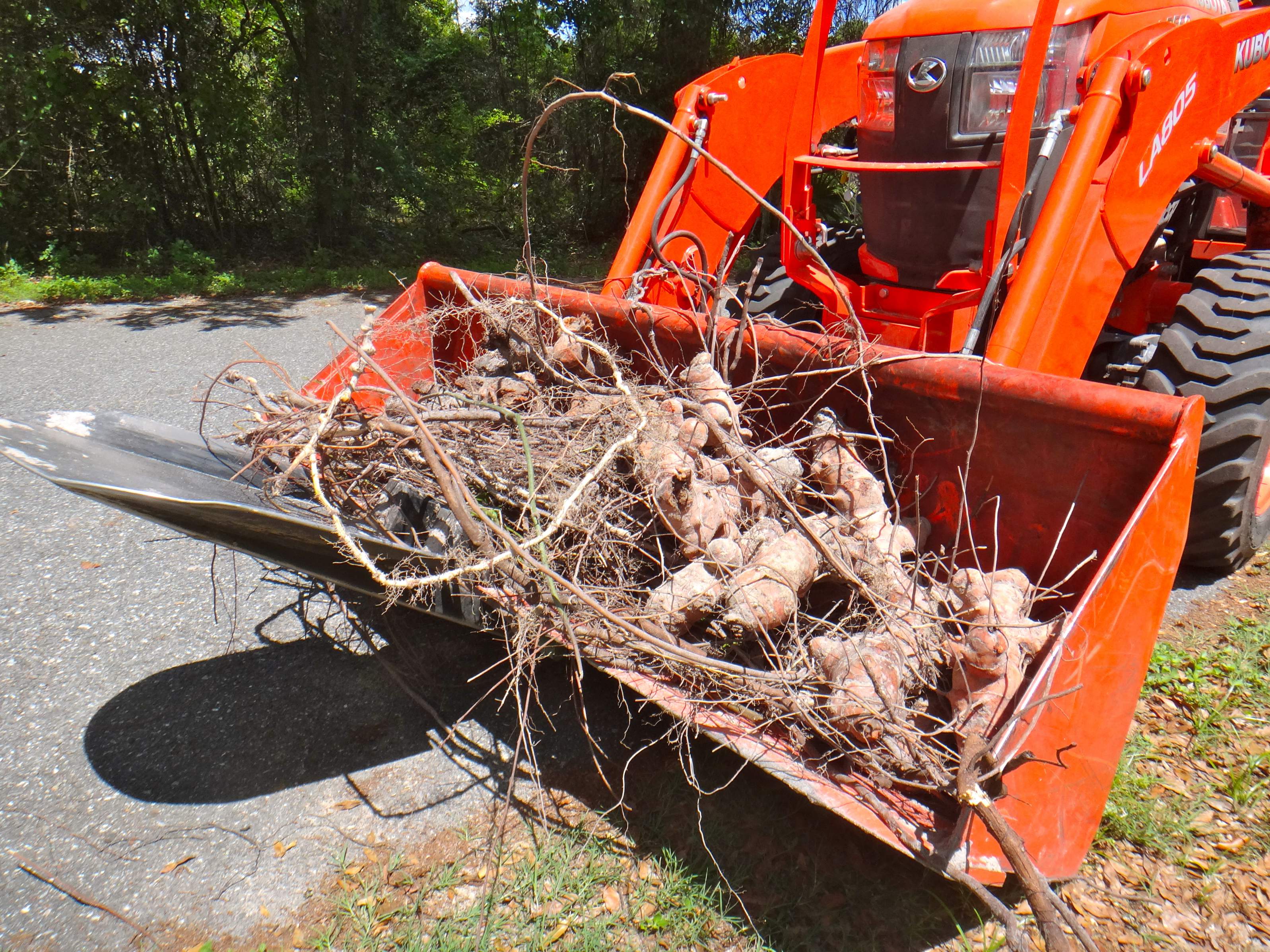

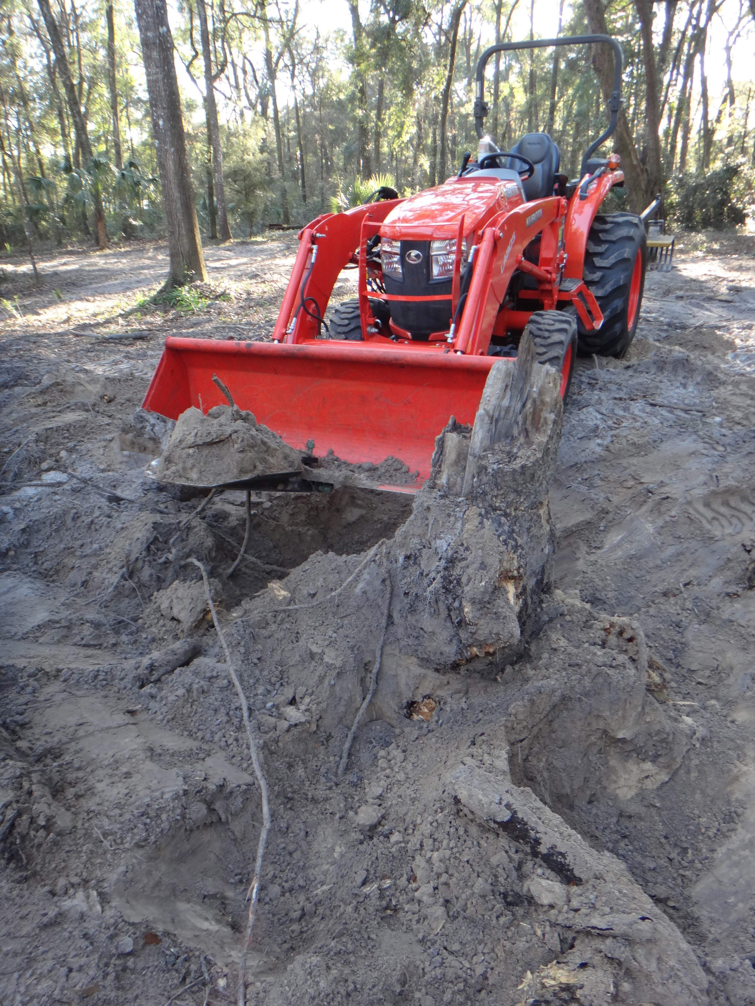

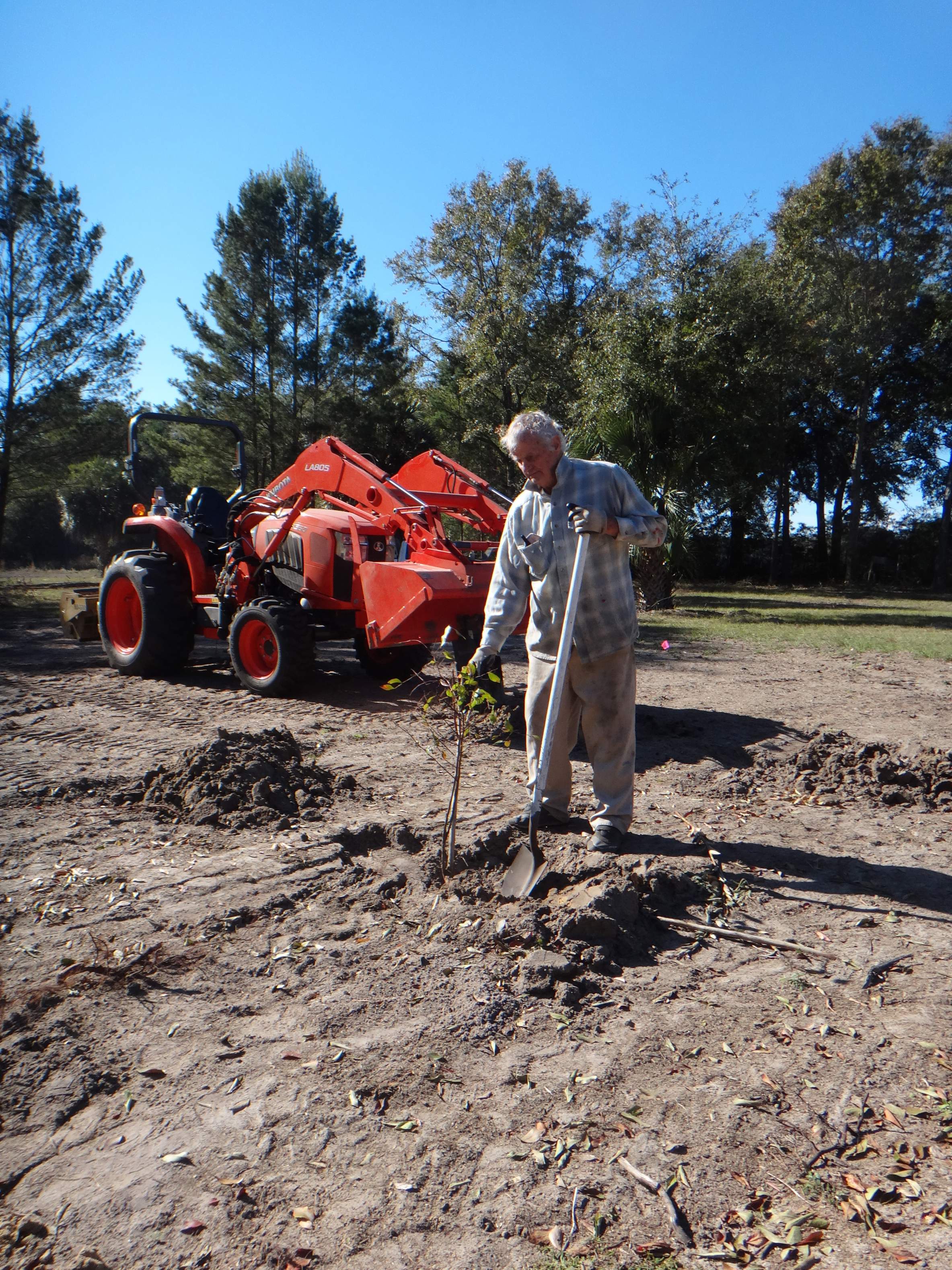

For quite a few tasks that $7,000 Backhoes are called to do, a <$400 Bucket Spade will do too, provided the FEL bucket is sturdy enough to hold the Bucket Spade rigid.
The Three Point Hitch is the key part of the tractor. Backhoe has to be removed prior to mounting Three Point Hitch mounted implements, which is most implements.

Jeff, that bucket spade may work really well in your sandy soil. In the black, gummy clay we have here in north Texas, or in the rocky soil in parts of central Texas, it (and probably the leading edge of the bucket) would get pretzeled up in about 10 minutes. It would be no substitute for a backhoe in my soil for sure.
/ Tym vs Branson vs ? #25
Pappy: I have nothing but respect for your experienced posts, almost all of which I agree with.
However, your 'pretzel' comment I dispute based on operating experience. The Bucket Spade (at least the Bucket Spade from Bucket Solutions) is 110 pounds of very good, forged steel. The Bucket Spade is NOT going to pretzel. Bucket Spade is best mounted on a HEAVY DUTY bucket. (weakest link in a chain, etc.)
It is possible one would have to wait for somewhat dry conditions so gummy clay would not adhere to the Bucket Spade, but I do not know. The Bucket Spade is finished very smooth.
Bucket Spade is not a substitute for a Backhoe. However it will accomplish 50% of Backhoe tasks for <$400.
Bucket Spade cannot trench. It cannot "scoop" because of its shallow dish. Nor can it dig deeper than about 48" - 54" unless mounted on pallet forks, which I have never tried and would be cumbersome.
Picture #5, Post #23, was measured 54" deep on completion.
