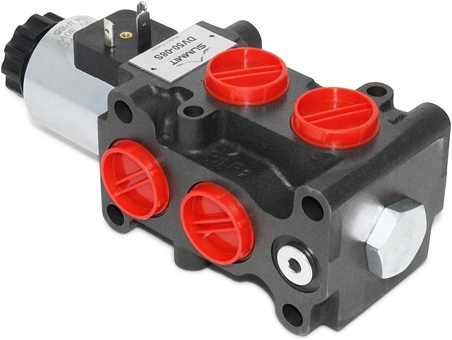

I've got three remotes on my Ford but when I use an attachment that needs two, I have to disconnect the one of the TnT cylinders--Usually the tilt. I bought a hydraulic solenoid diverter I plan to install when the weather warms up. It will allow me to use one valve to operate either the top cylinder or the tilt cylinder and still have two remotes available for my ditch flail mower.
I added one to my Kenbota when I got the grapple. It works great there too.

If you want more remotes, a much cheaper solution is a "hydraulic multiplier" from Summit Hydraulics. It basically multiplies the number of remotes but you can only use one at a time. For most applications it works very well.
