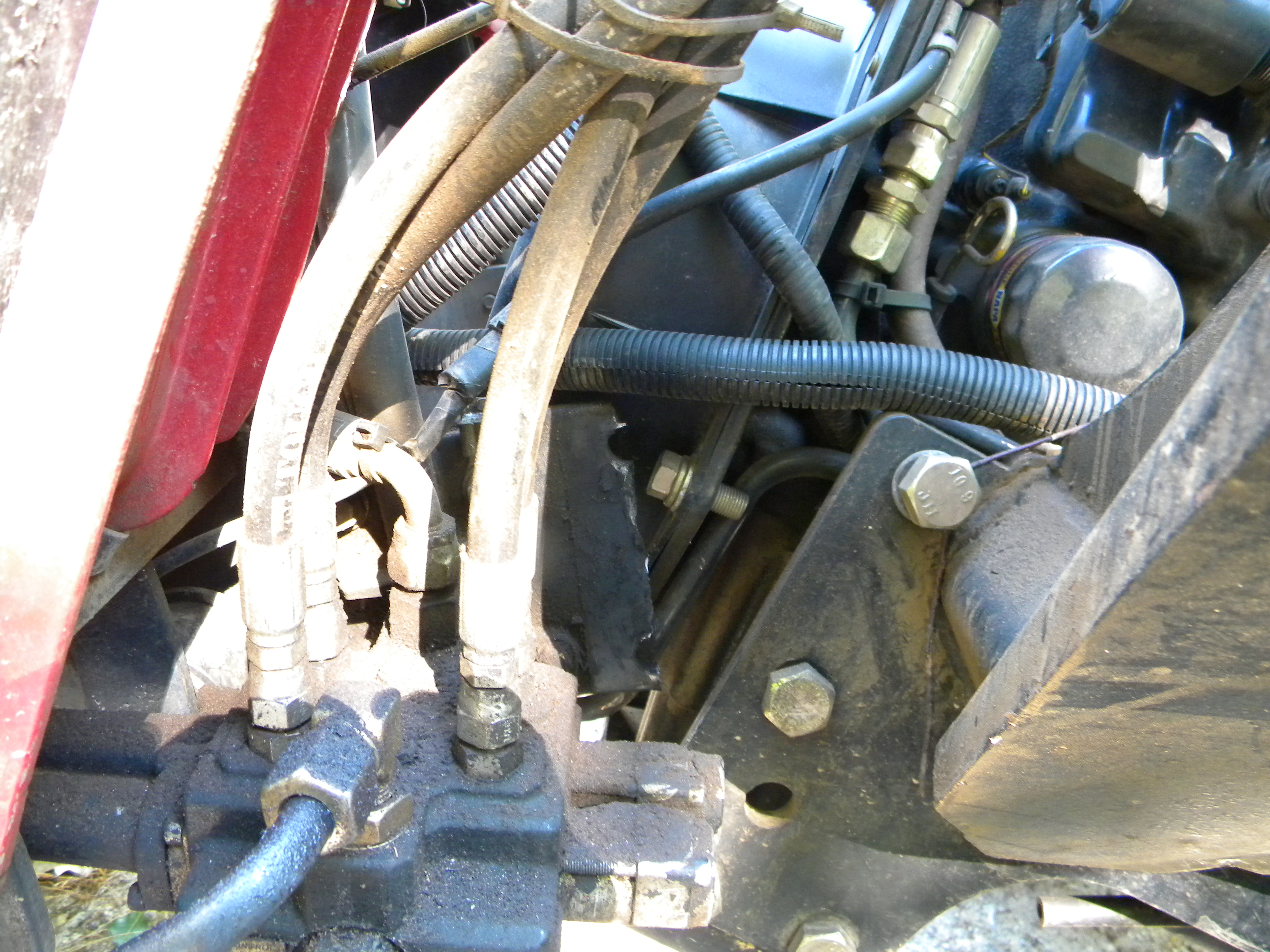

The frame of the tractor broke in half Oct 2012 and was repaired by the dealer under warranty after 3 months of waiting and fighting. Now Dec 20 2017 the frame of the TYM 233 broke again in the same spot .TYM now says repairs are at my cost .Looking for suggestions on my next step ?

Did they just weld it last time
/ TYM 233 Frame broke again
Frame was replaced and I have the old frame in 2 pieces
/ TYM 233 Frame broke again #6
May be you can get the old frame welded and beefed up . any pictures
/ TYM 233 Frame broke again #7
You could always trade it in. Must be a bad design to break 2 frames in the same spot

BTW I think some subframe ties would fix the problem but I don't even pretend any engineering knowlege I just break stuff alot.

If you have to pay for the new frame take the loader mount off and weld the frame back together. Mine was out of warranty so that's what I did.

Wish there were a photo? Curious about the word frame? With compacts, engine just bolts to transmission housing. Again, confused by what is meant by frame?
#13

Some compacts utilize steel mount plates that run forward from the engine sump and support the radiator, battery and may also mount the front differential. somewhat different than tractors that utilize a cast steel (single piece) front mount assembly. Not knocking the steel plate designs but Am a fan of the cast steel designs. imo they have better rigidity.
An example would be the LS model that caused fan blade contact with radiator shroud due to movement/cracking- or bending. LS jumped right on it and updated strengthened the design . haven't heard of any problems since and that was at least 3 years ago.
