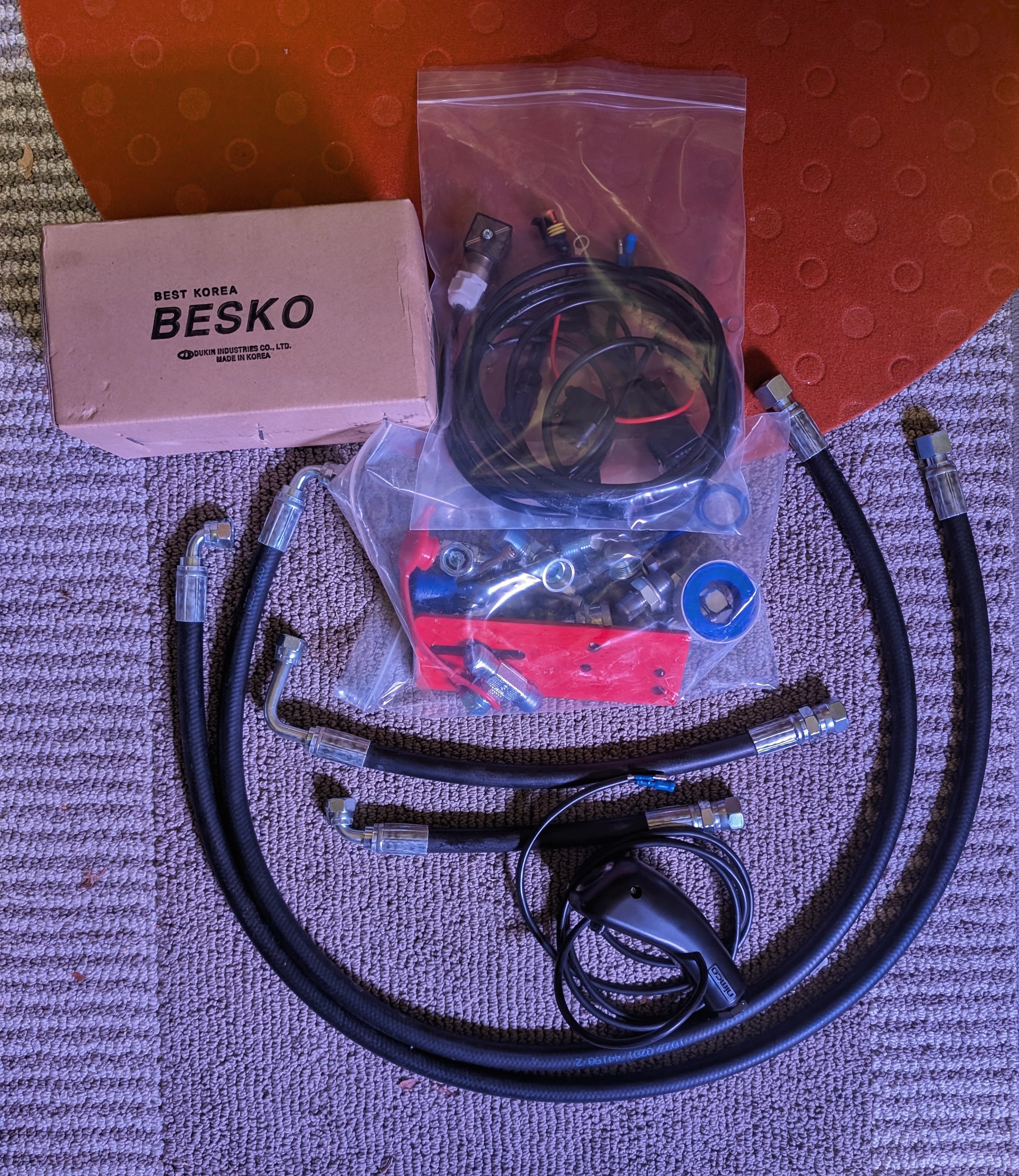

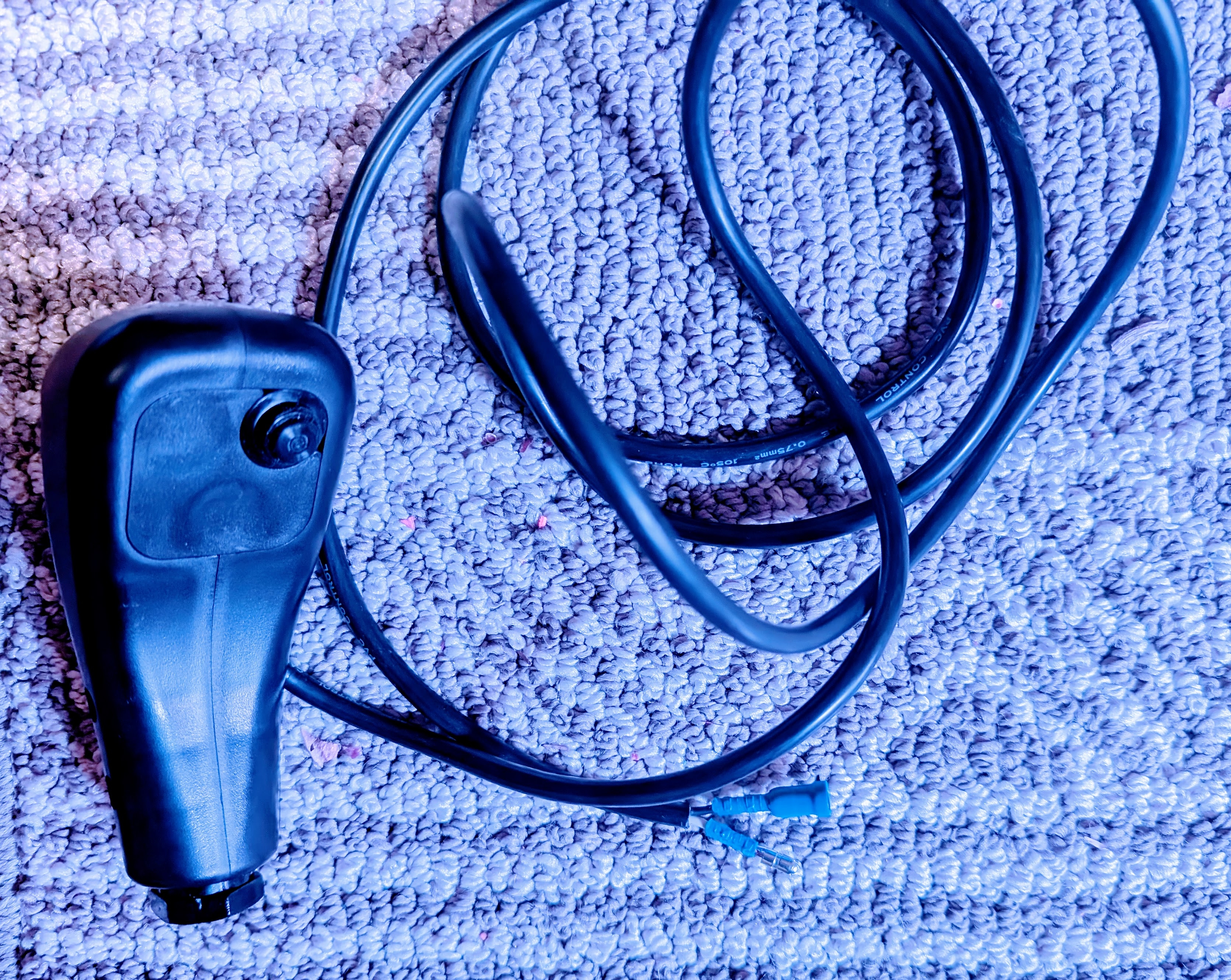

Just for reference. As of Dec 2024, TYM OEM "3rd function kit for New BL200 loader" part#BZ00728B. Has not changed since 2020. It is still just a diverter for a x2 price of real 3F kit from the aftermarket.

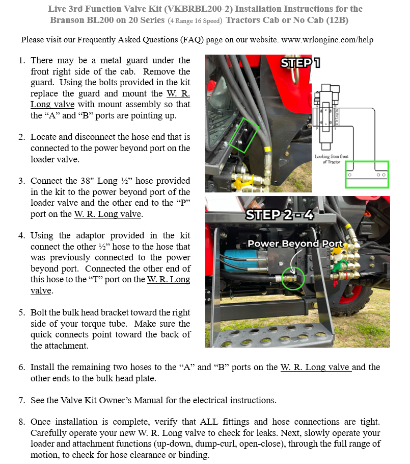

install directions that come with the WR Long. Hopefully this helps you to decide which kit is right for you!
